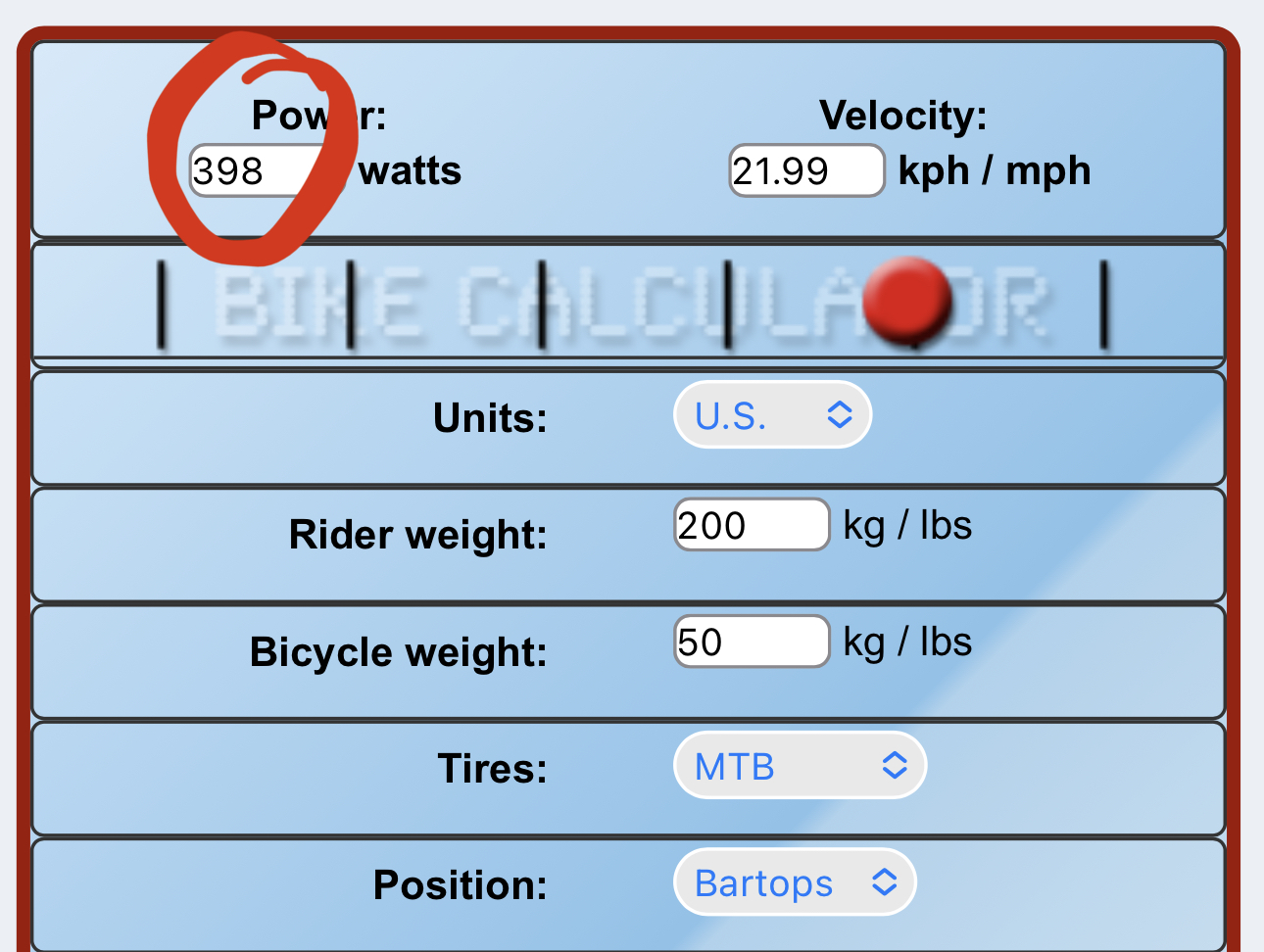

on a bike with an upright riding position, large tires, not particular aerodynamic or easy rolling, it takes more like 350-400 watts to go 21-22mph. corresponds to a battery draw of 440-500w, so range should be exactly what you’re seeing - a bit over an hour at 21-22mph is 20-25 miles.
motor power ratings are not too meaningful, what really matters is power draw, and of course how much power it takes to overcome drag and friction. (or gravity if uphill)
