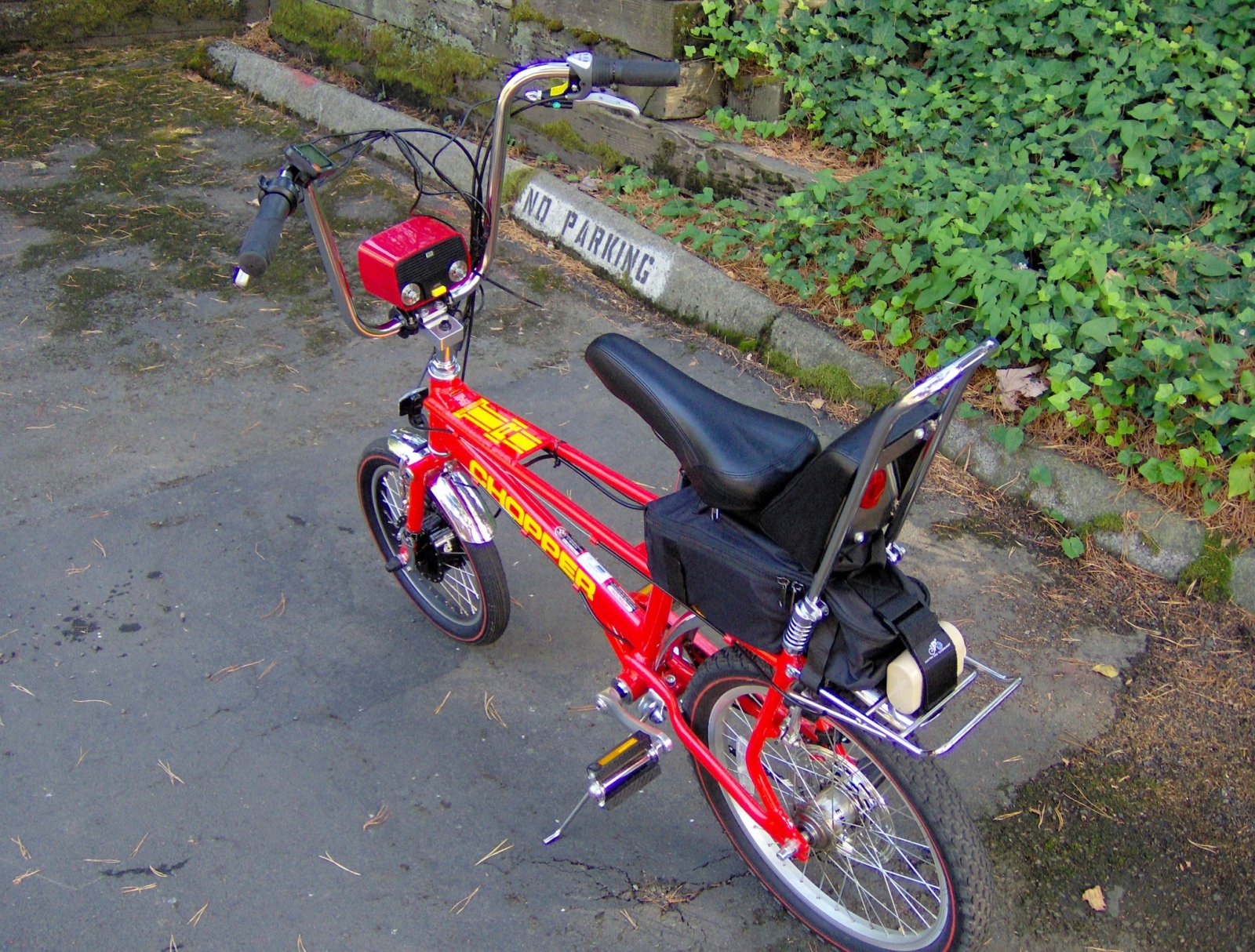

Here is my Chopper Mk3 that I converted some 10 years ago. I used one of the pricey “E-Bike Kits” as there were not a lot of alternatives at that time. I think it was this kit:
It still works beautifully and even when I forget to charge for long & cold periods, it will top back off in under 15 minutes or so. I would had thought it to be dead after all of these years but no.
