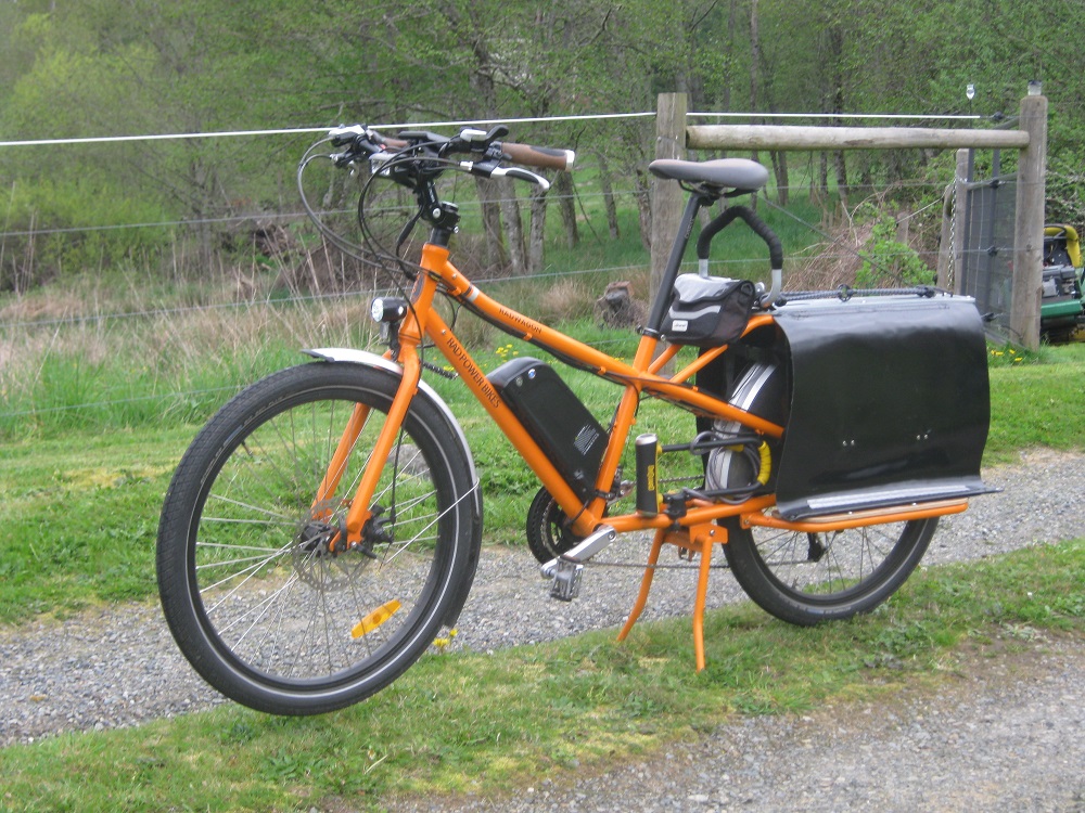

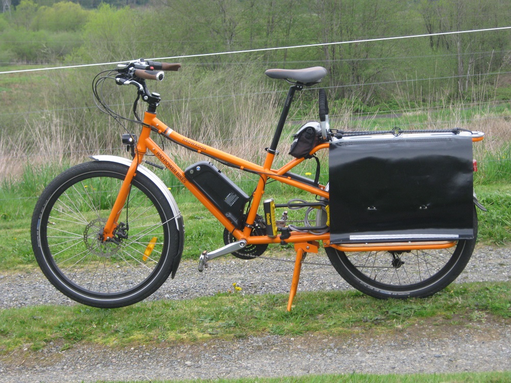

To date at 810 miles

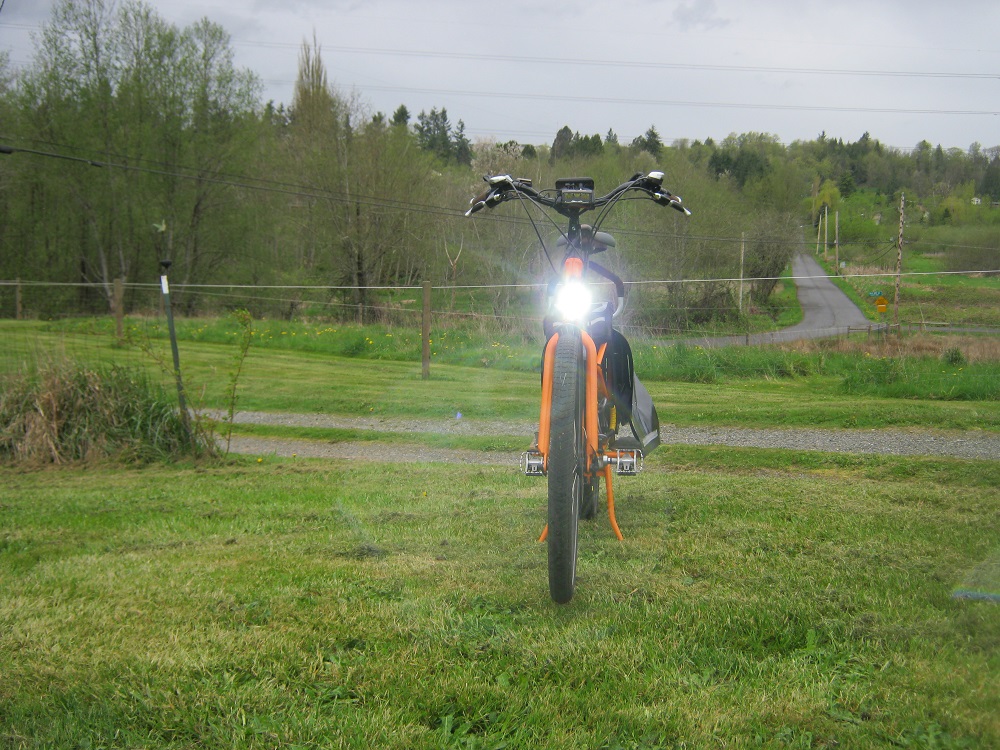

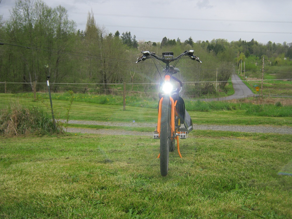

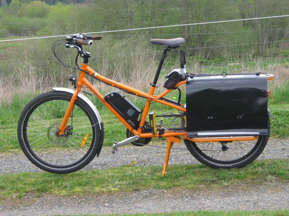

Headlight light circut, Busch & Muller IQ-X E
Headlight battery, Specialized Flux Expert

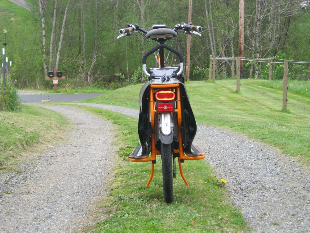

Tail light light circut, Spanninga Elips XE
Flashing tail light battery, Cateye Reflex

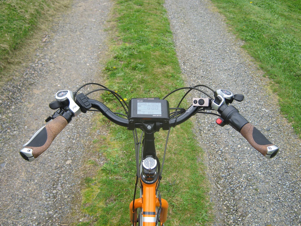

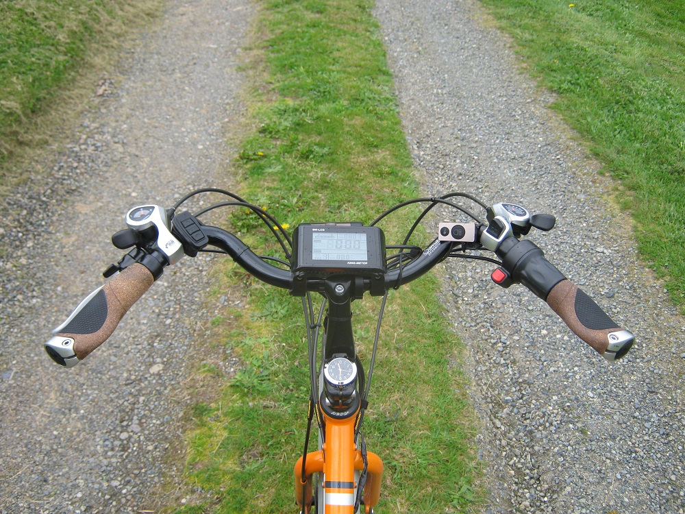

Handelbars, Soma Sparrow
Grips, Ergon GP1 Biokork
Stem clock, Stem Captain
Front fender exxtension, SKS velo 55
Brake pads, Shimano resin
Brake & shift cables, Jagwire Mountain Pro
Extended seat post, Cansuc 450mm
Saddle, Selle Royal Becoz Biokork
Pedals, Shimano M324
Axle nuts, Problem Solvers
Rear derailleur, Shimano Deore
Tires, Schwalbe Big Ben Plus
Rear spokes, Sapim
Tool bag, Avener

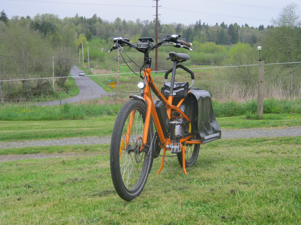

Panniers, 90L De Poort newspaper bags
Lock, Onguard Pitbull
(Link Removed - Attachment No Longer Exists)
Rear spokes, Sipam
Tool bag, Avener
Panniers, 90L De Poot newspaper bags
View attachment 16244 View attachment 16245 View attachment 16246 View attachment 16247 View attachment 16248 (Link Removed - Attachment No Longer Exists)View attachment 16250

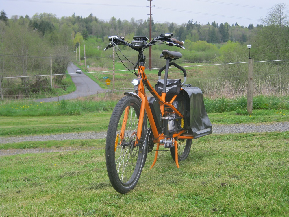

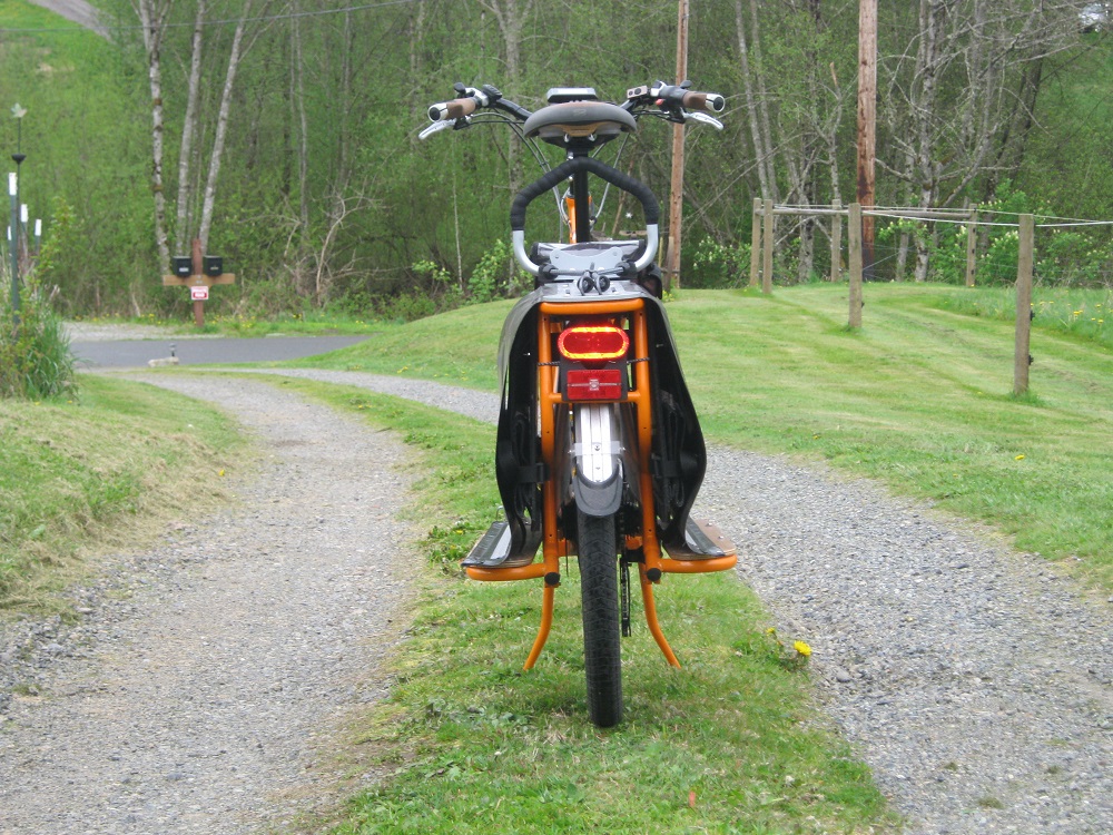

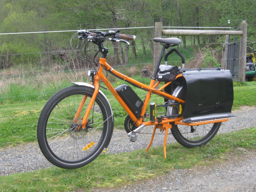

hi windmill can you post a few images of the panniers expanded. Also how they attach to the accessory desk. I interested in them but want to make sure i can still get a child seat adapter on. i really don't need that much storage but i like the look and that they appear to be permanently installed rather then quick release. thanks
They're very basic, heavy duty newspaper bags from Holland, (Link Removed - No Longer Exists) They're huge being big enough to carry 6 grocery bags, a little crude but heavy duty made with military grade truck tarp and 1/4" plywood
As purchased, they're throw on bags without straps to secure the bag to the bike or hold the flaps down, and required a bit of modification.
I removed the center reinforcement plywood board so I could use the deck to hold the bags in place.
Sealed the plywood backing boards with truck bed liner.
Added straps and buckles to keep the flaps down, or folded flat when not in use.
It takes some work, but they cost me just a little over $100 including shipping from Holland, straps and buckles from Mcmaster Carr. Bags of similar size from Yuba and others are $200+ per side. I'm willing to sacrifice some sophistication to save $300 to $400.
I put cardboard boxes in the bags to show their max size, in normal use they typically don't look so big.
