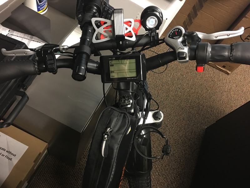

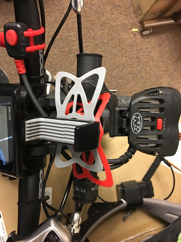

Checked out your video and you have the same type of issue I have with road commuting. I just don't have to deal with the rain in the southwest; but, I have 15-25 mph headwinds with gust +30 mph in the afternoons sometimes. I also doubled up on front and rear lights, loud jackets, big butt comfy seat, spare battery, and you can never have too much storage. I never realized how hard a car suspension is working until I road the same streets on a bike.
I did the BM Works Speed Extender for extra space on my handlebars. I just didn't have enough space for my toys and the curved handlebars make it hard to add an extra light at the right angle. The Extender fit perfectly within the space under the Radrover LCD screen.
BM Works, Amazon, $22: https://www.amazon.com/gp/product/B00M13QMVA/ref=oh_aui_detailpage_o00_s01?ie=UTF8&psc=1
View attachment 15867 View attachment 15868
More pics please. What is the bag on your frame?
The triangle bag on my Radrover is from Luna Cycles, $25: https://lunacycle.com/batteries/battery-bags/luna-cycles-triangle-battery-bag/
I don't see why it wouldn't fit on the Radwagon also? I got the bag to help keep the battery warm in winter commuting and keep the dust off the battery during trail riding. It should work with Seattle rain and adding a little water proofing spray to the outside wouldn't hurt. I had to cut 3 holes in the bottom of the bag to fit the battery tray inside. I cut another hole towards the bottom rear for the battery tray power cable to exit. There are vent holes top and bottom. The bag also has a double zipper on the left side to access the battery power button, battery charging port, or unzip a little more if it is really hot outside. It also has pockets on both sides with velcro (I use to store extra zip ties and velcro strips). I ended up cutting out the velcro strips on the inside of the bag because they were just in the way. Closing in on 6 months with the bag and had zero issues with it.
