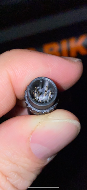

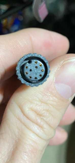

I was focused on extending that thicker (4:1) cable coming from the controller. A complete set would be a suitable solution and I would have already ordered it if I could I find the 10 pin connector. This is from the controller, up to the stock cable that splits to the brakes, throttle and display with 2, 3 and 5 pin connectors for each respectively.

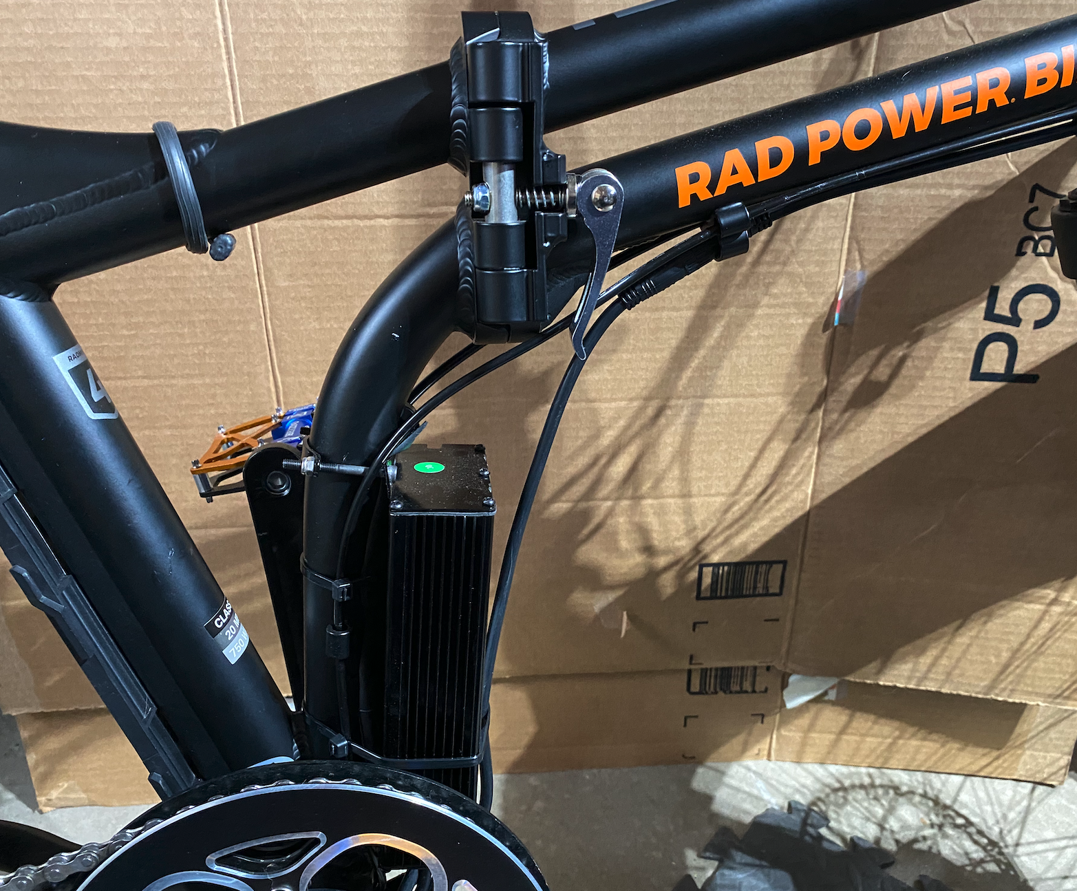

I installed Boltons 35a upgrade kit a couple weeks ago...and you're 100% correct, that's why the cable's too short. It travels along the underside\front of the controller instead of behind it. This leaves it stretched from the down bar to the crossbar with a gap, sort of creating a triangle.
I didn't order the bundle of cables though. None of them had that silly 10 pin connector so I turned focus to the 4 individual cables that split off. I need about 6 inches to be able to wrap around the back side of the controller and relieve the triangle tension. I'll fold the bike a few times per year during longer camping trips and I worry about that tension when it's being folded.

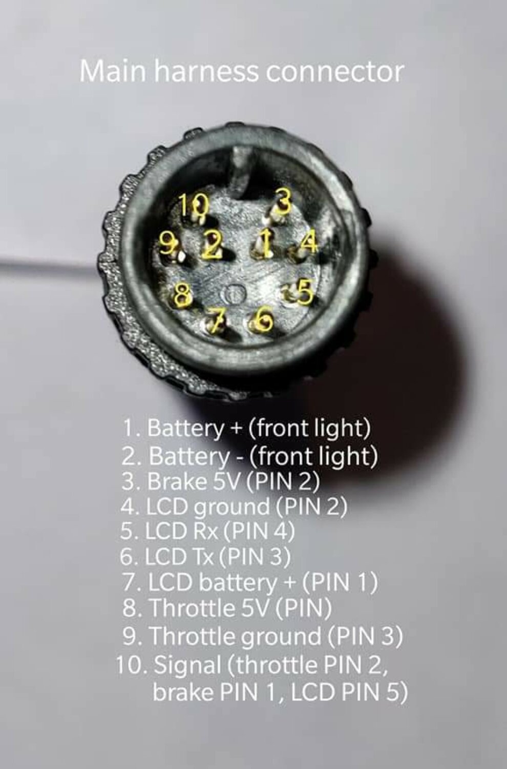

Yes. Individual cable extensions is the easiest way. 10 PIN (5 to 1) main harness (or connector) is not not available in retail as far as I'm aware.

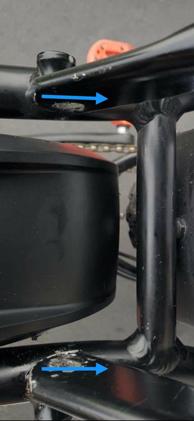

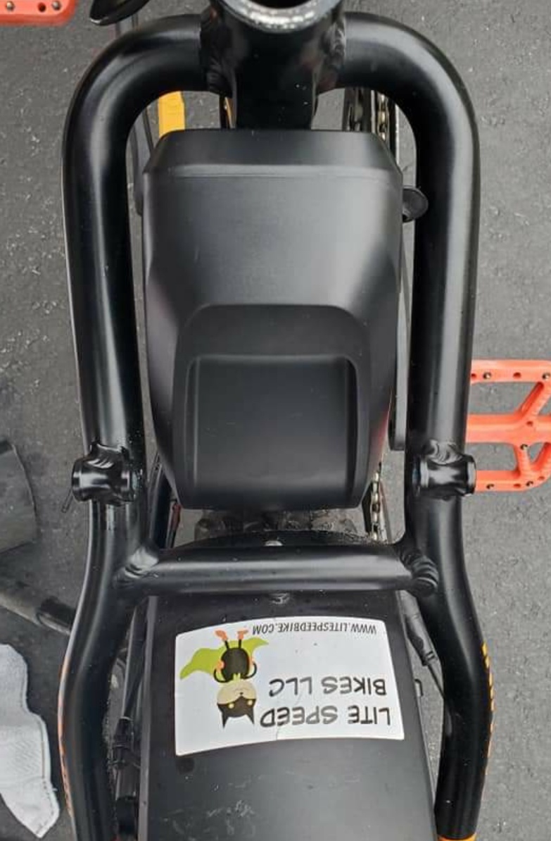

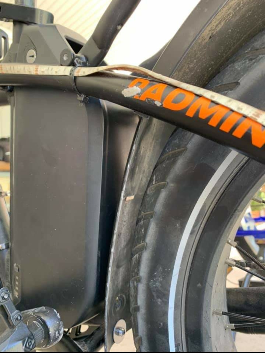

Would that really interfere with rear fender though?
Looks like there's a lot of room, and if it does in fact, interfere with fender, I don't think the battery would even go in because it will interfere with the point where you mount the fender and rear reflector (brake bridge, or in this case, fender bridge) before interfering with the fender.
Also, what do you mean by rear rack front mounting?
Rad Power Bikes RadMini 4 Electric Bike Review - Header
Jumbo Shark need just little more room so yes fender needs to be modified.
Sorry forgot to mention the reflector/rear light. If you dont have rear rack then spacer bracket etc are needed for that as well.
The bike will fold.
