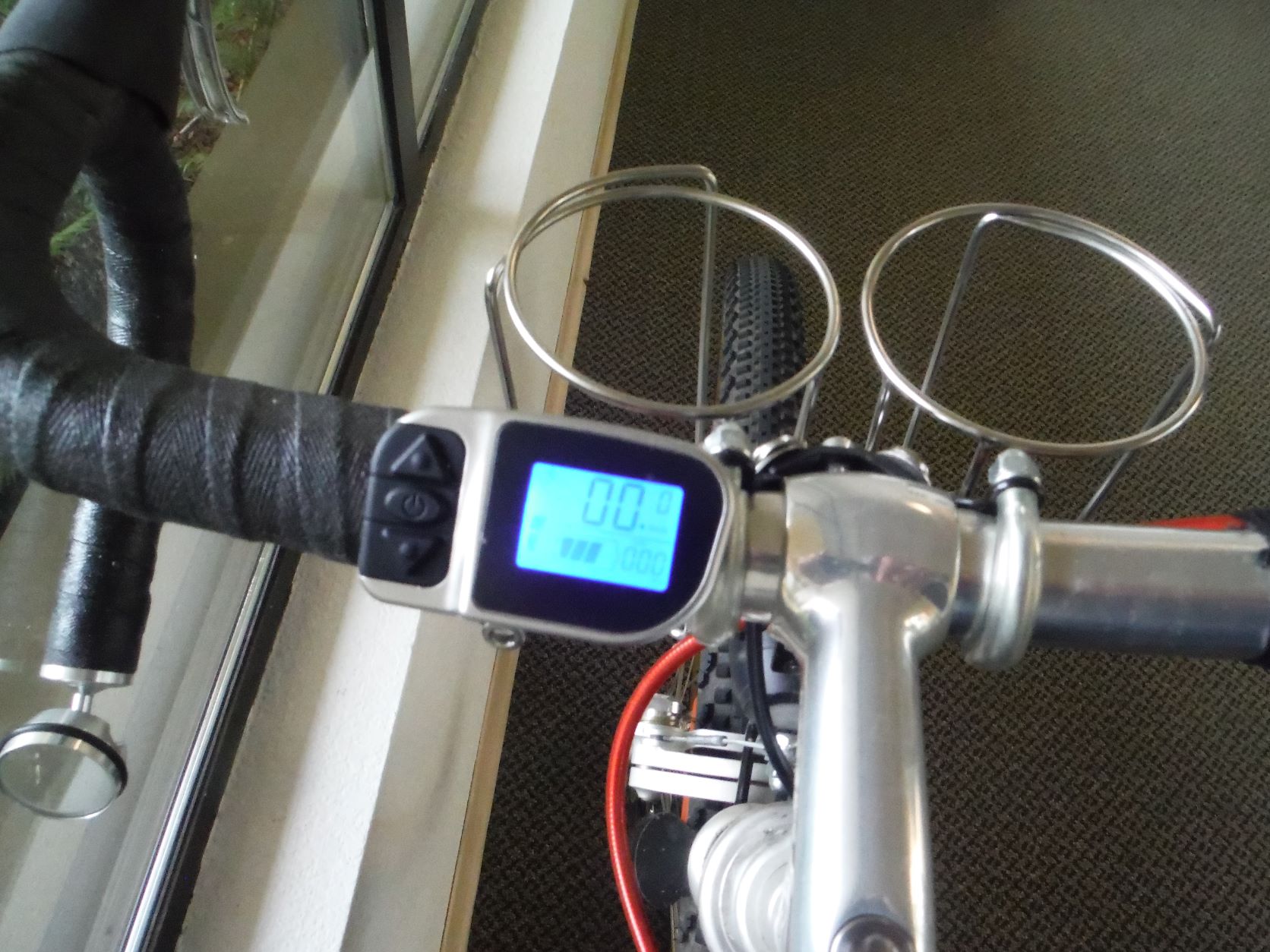

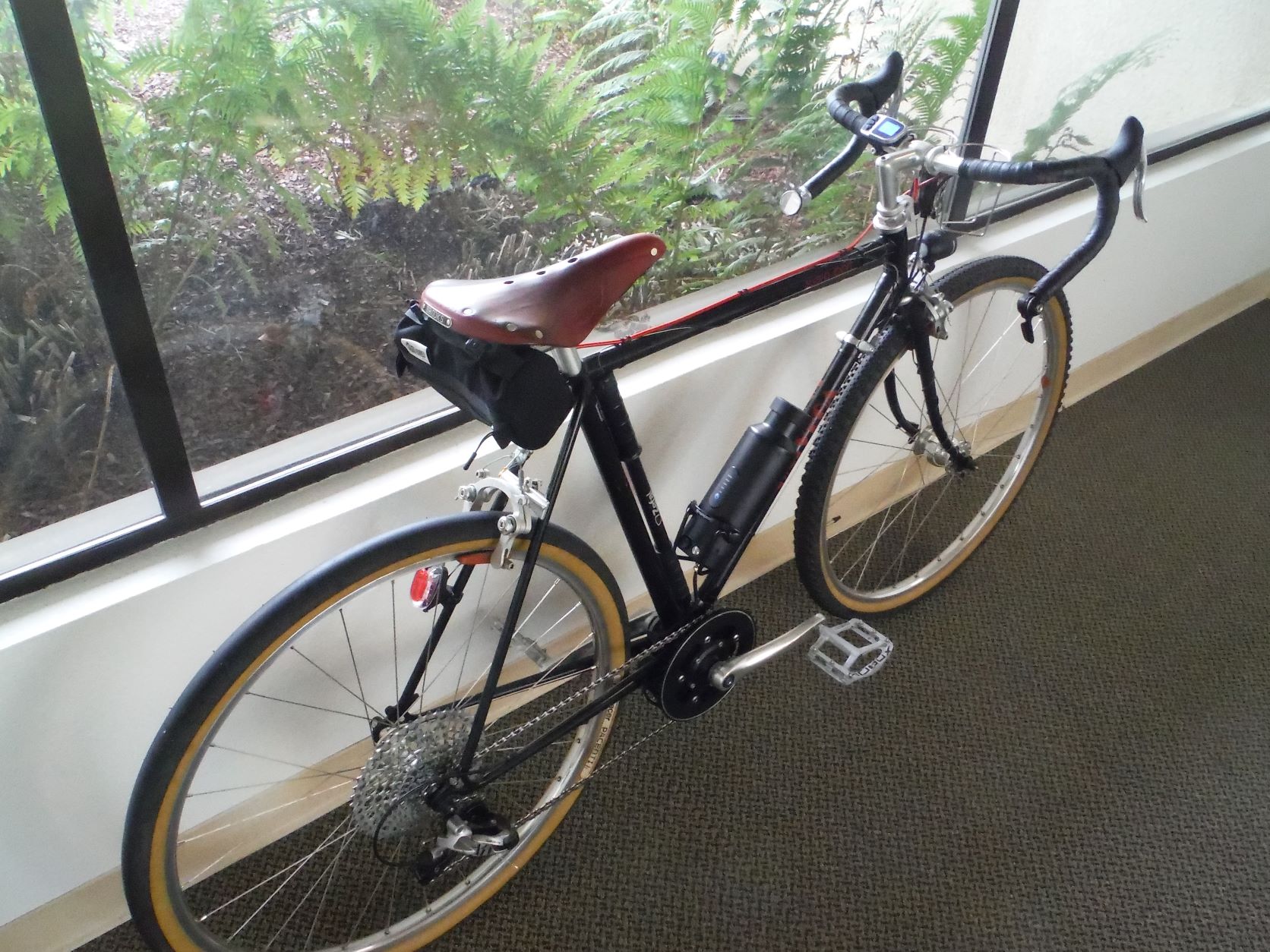

Those suckers are HUGE! I built that 11-speed road bike yesterday with one 3-pound battery.
