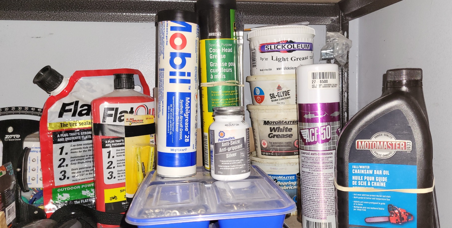

You're better off sticking with manufacturer recommendations. They often take into consideration things such as plastics that may be affected.
On the Bafangs motors many use Mobil SCH100.. a high quality NLGI 2 synthetic grease suitable for electric motors as there is no manufacturer recommendation.
Also used is John Deere Cornhead grease which is a gear grease but that requires some caution as it's thixotropic (thins to oil like viscosity under mechanical pressure)
So this grease for the plastic parts ( but i have not found grease for the motor shafts in stores , i mean original bosh ) What do you use ? ( or maybe know original )
