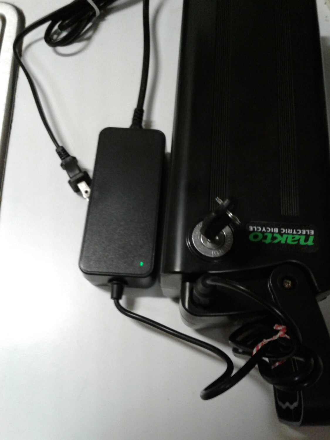

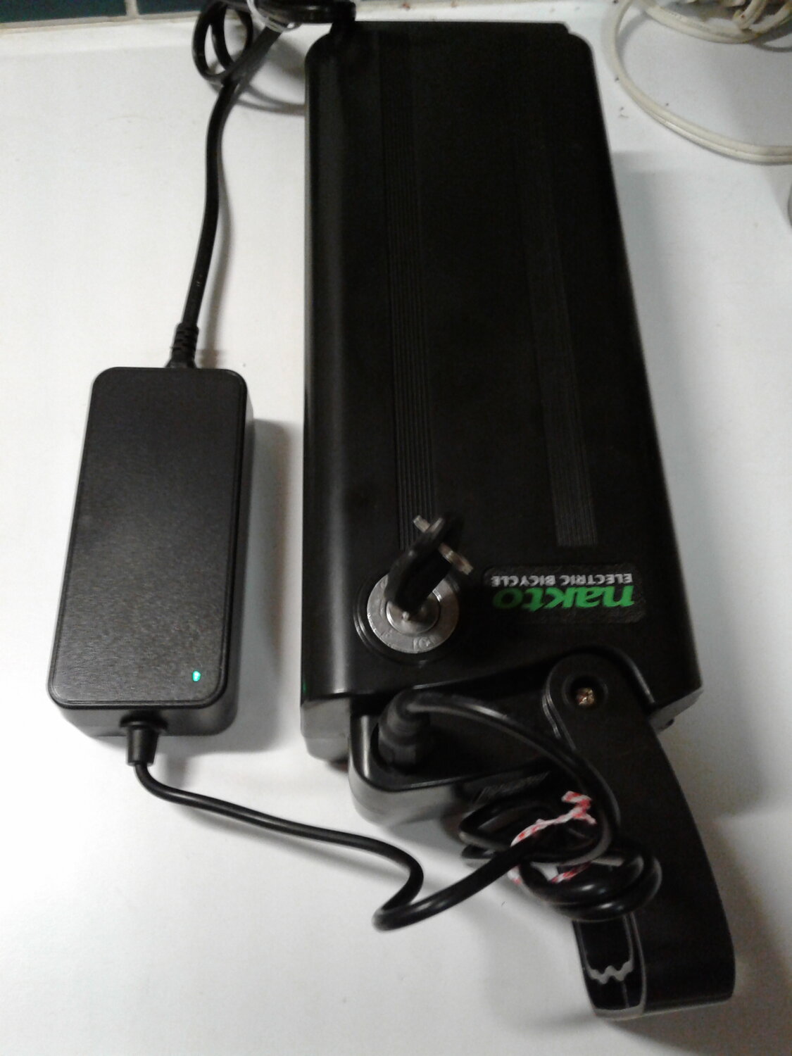

Nakto battery not charging, would bad fuze cause this? Or is fuze to protect motor and other electrical components. Checked continuity on fuze it is good.

Sorry for the spelling error, it's as good as my knowledge on e bycycle electronics..Then what is a fuse for on this battery? Our chargers are showing us the battery is charged but it will not charge, I sent those photos to Nakto
I don't see a fuse, but the sole purpose of a fuse is to burn up in a dead short and prevent a fire or melt down. The fuse melts before anything else and is a safety device. Chargers usually fail before a battery pack. They are cheap disposable hardware. You really need to know the output voltage of the battery pack. A green light really means nothing if the charger has failed.
