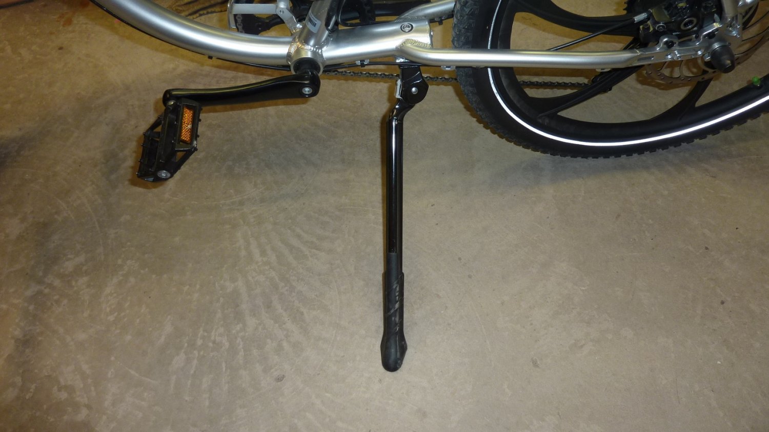

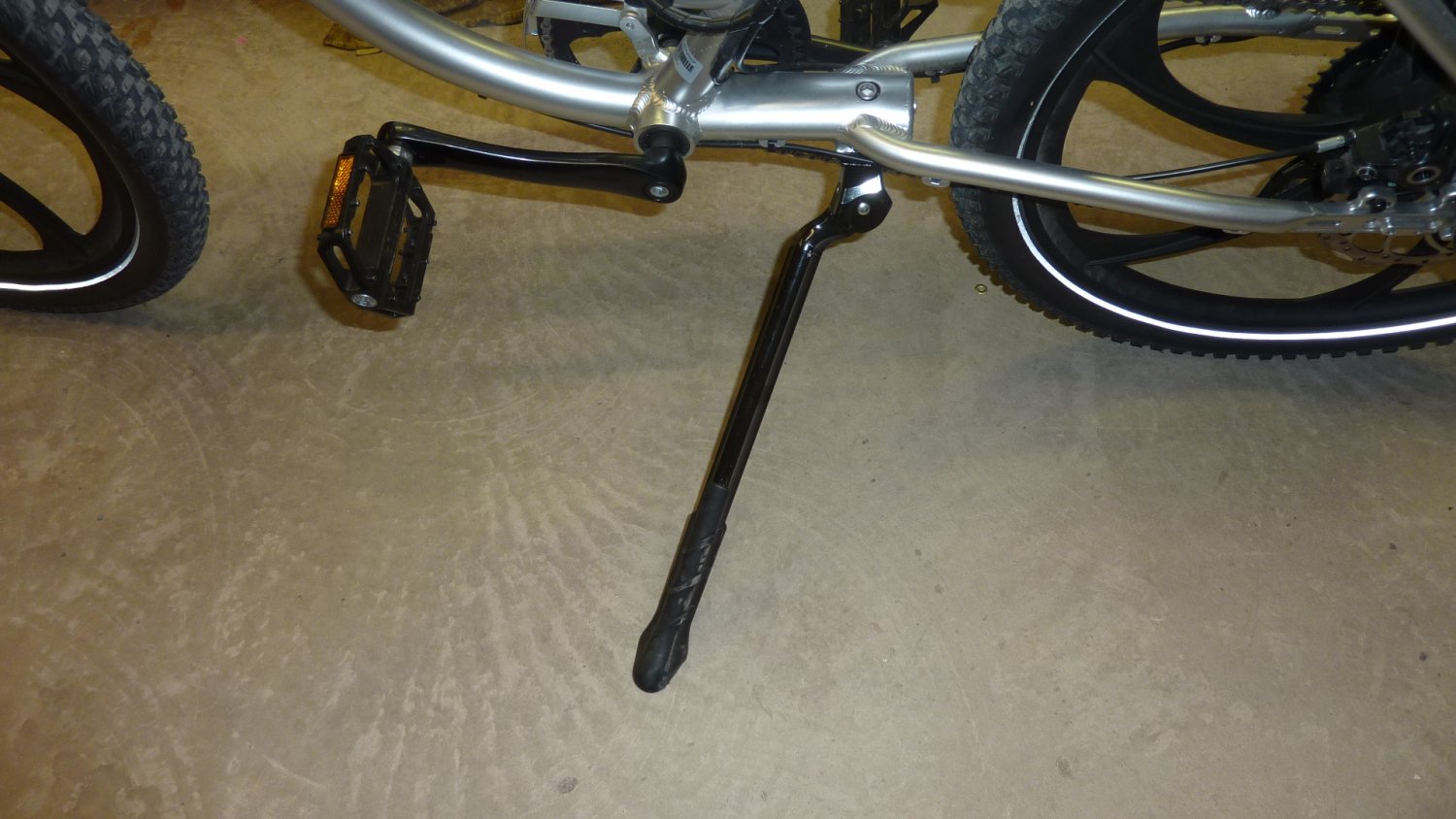

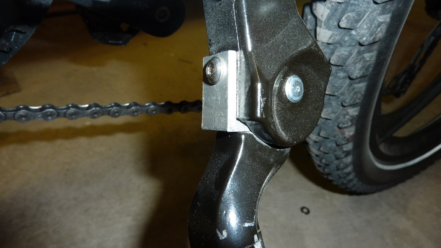

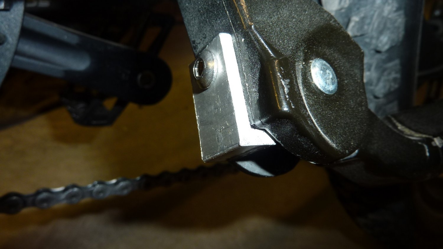

In re-reading this thread, I came across your 2 week old post which mentions the kickstand placement on the Boomerang. My Platinum Interceptor has the same kickstand. Both models tend to be rear heavy with the rear rack battery and the bikes can tip over if the kickstand isn't placed properly.
I discovered a simple fix for this which in my case, solves the balance issue completely. The problem is, the OEM Pedego kickstand swings too far forward when deployed. It provides little support for weight on the rear of the bike. I found by adding a 3/16" thick aluminum shim to the mechanism, the kickstand touches the ground about 4" further to the rear. This makes a huge difference in balancing the rear heavy bike.
Unmodified
With shim
I cut a piece of 1" aluminum angle as shown and screwed it to the kickstand frame. I used a screw so it could be removed if the experiment didn't work out. It worked so well that used epoxy to hold the shim in place on my other two Interceptors.
The shim does not affect the way the kickstand retracts and otherwise operates normally.

Thanks. Very interesting. I do see what you mean about the kickstand. I'll look at this mod. Did this require drilling into the kickstand to get the screw in?
Yes, I drilled and tapped the hole to accept the screw. I did the first of my 3 bikes that way to be able to remove the shim in case the mod didn't work out. On my other 2 bikes, I used gorilla glue to hold the shim in place. The glue works equally well.
