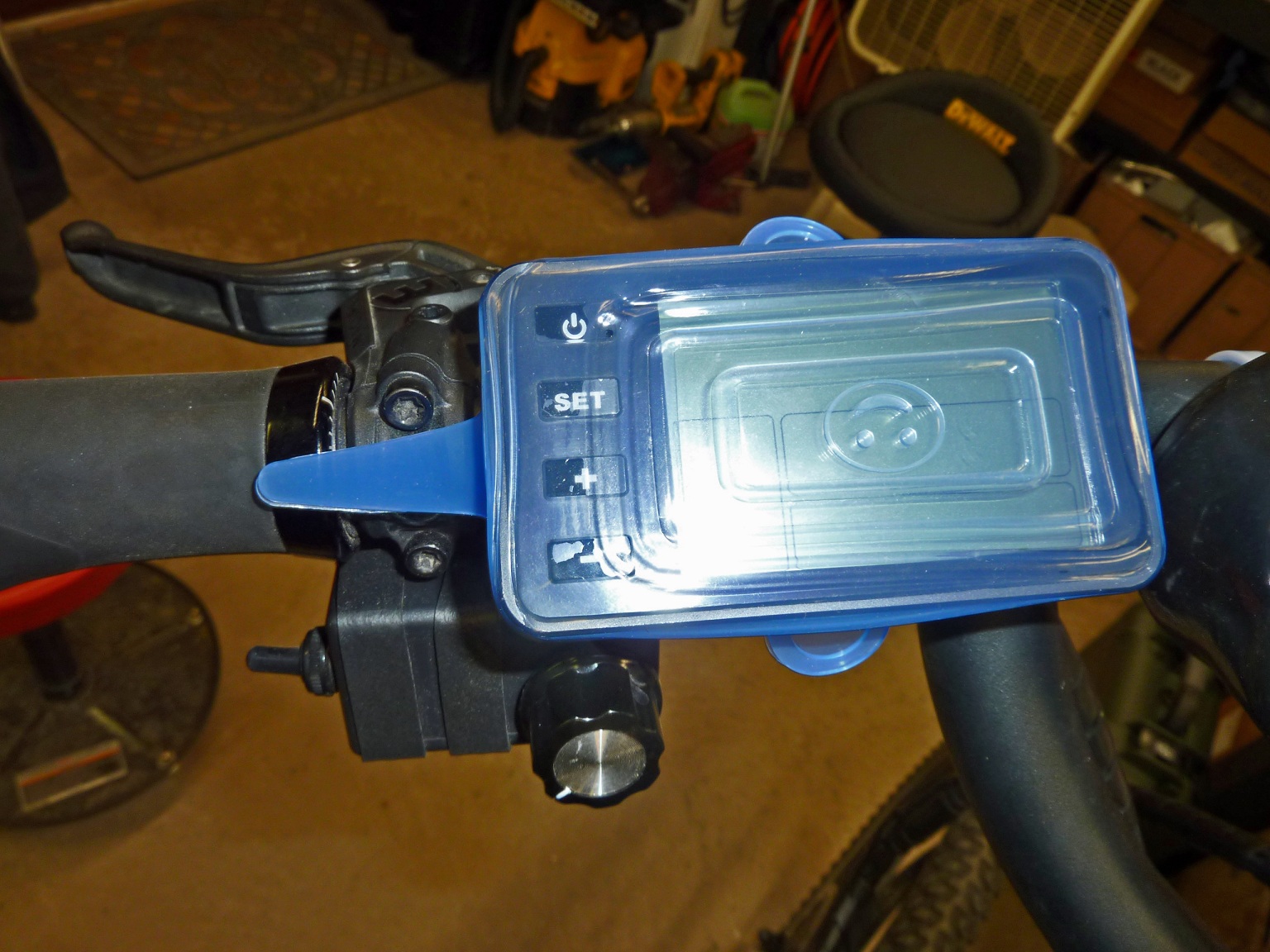

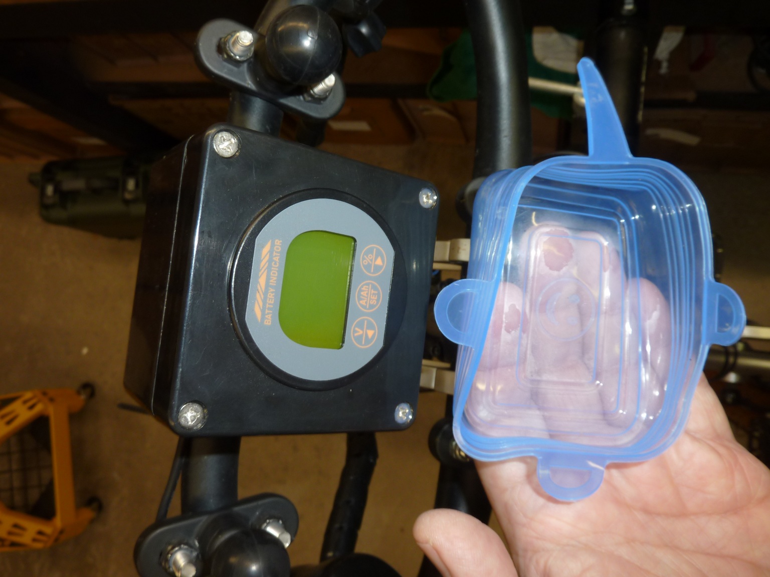

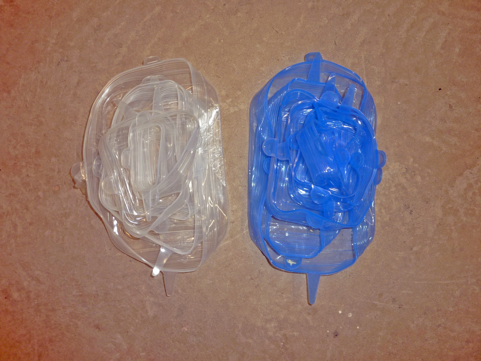

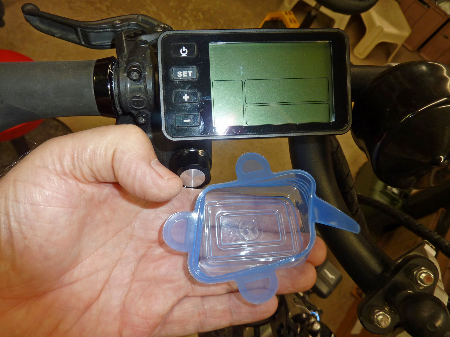

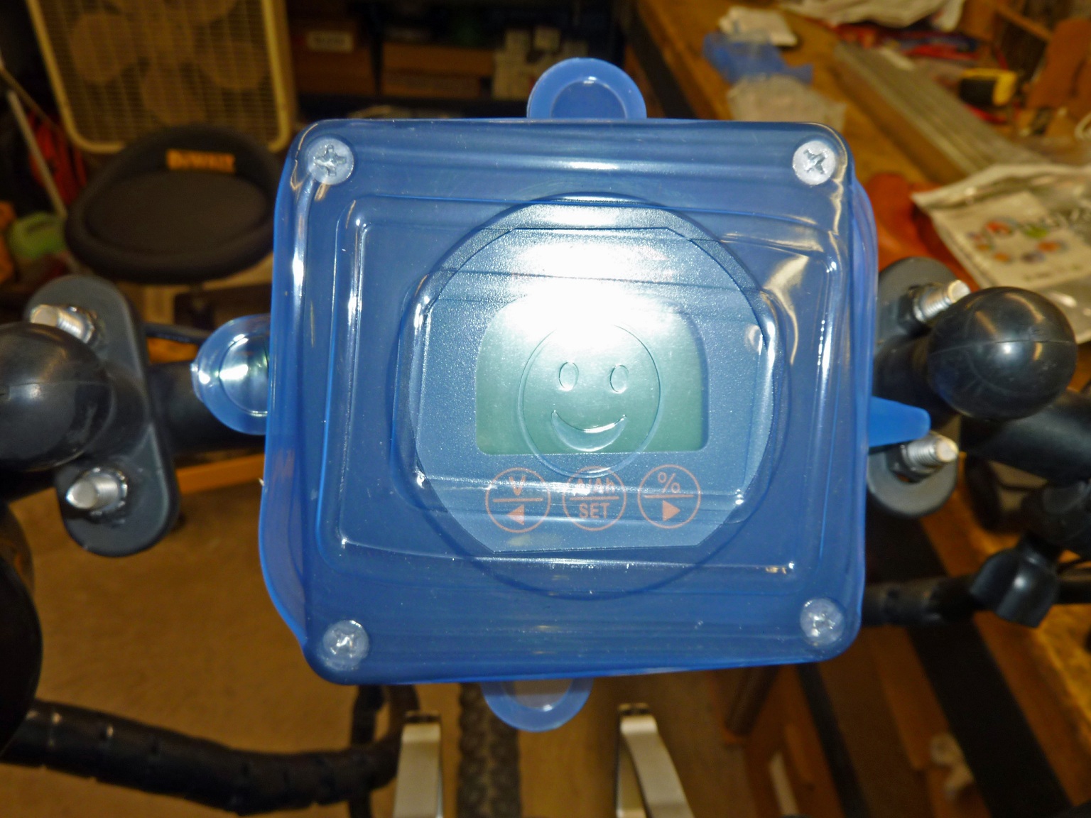

I use these stretch silicone bowl covers to protect my displays during inclement weather while riding and especially during transport:
They are transparent & flexible enough to allow button operation.

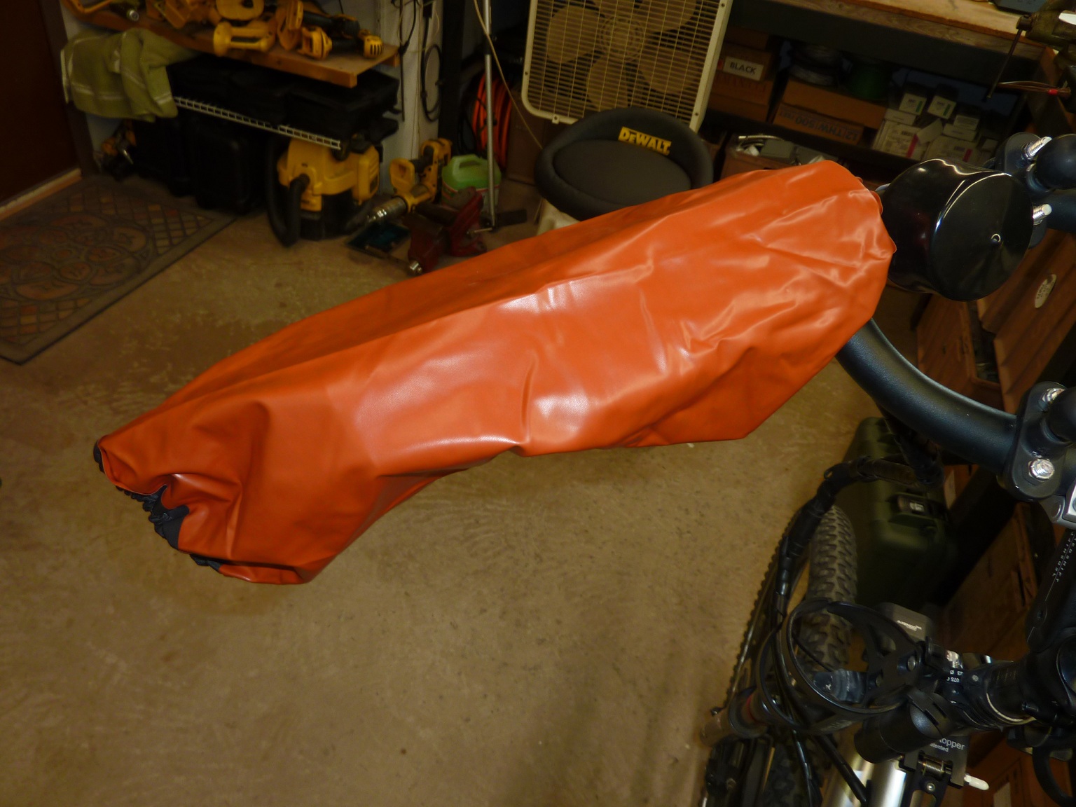

For protection during transport under extreme conditions, I also use these arm protector sleeves on my bar ends:
Driving for 12 hours in the rain with the bike on a hitch rack can force water into the controls/display. Then a plastic bag and rubber bands is enough,
