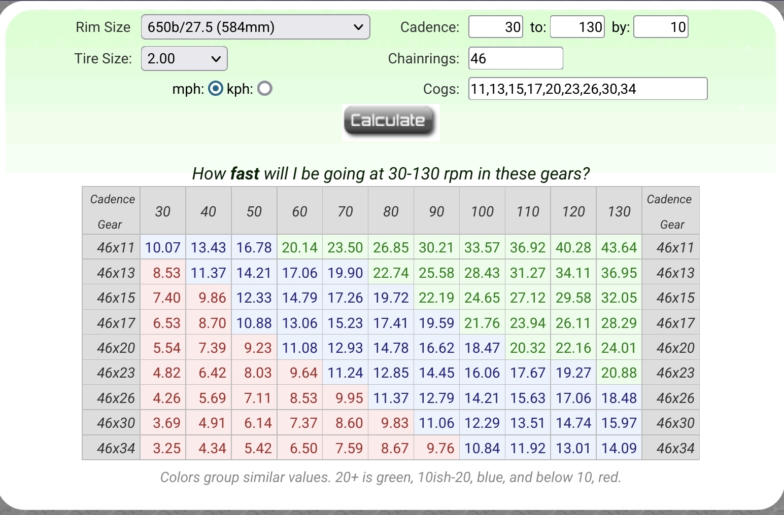

Great website to check out cadence at speed for various gearing is https://www.bikecalc.com/speed_at_cadence
I have the Roadster with 64x20 single gear, so I'm roughly speed = 3 x RPM, or ~20 mph = 60 rpm, 30 mph = 120 rpm!
Plugging in what I think is the Prodigy info gets you this?

You didn't state which Prodigy model, and that makes a difference. The ST and XR models have a larger chainring than the XC. So, it sounds like you would prefer the lower cadence possible with the ST and XR models.
