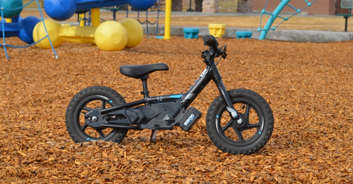

Well done! You may be interested in this micro-eBike for kids. ;)

Thanks :cool: that one is great too wow
More details from Electrek... Stacyc 12eDrive tech specs
  • Top speed: 14.5 km/h (9 mph)
  • Range: 1 hour (varies greatly)
  • Battery: 18 V 2 Ah (36 Wh) 18v 4 ah available
  • Charge time: .86 hour (1.3 hours for larger battery)
  • Weight: 8.1 kg (18.5 lb)
  • Max load: 34 kg (75 lb)
  • Electric Control: Throttle only
  • Brakes: Mechanical Band Brake
  • Extras: 3 drive modes: Beginner, Intermediate and Advanced, Mini-Moto stand or Sticker pack available add-ons
