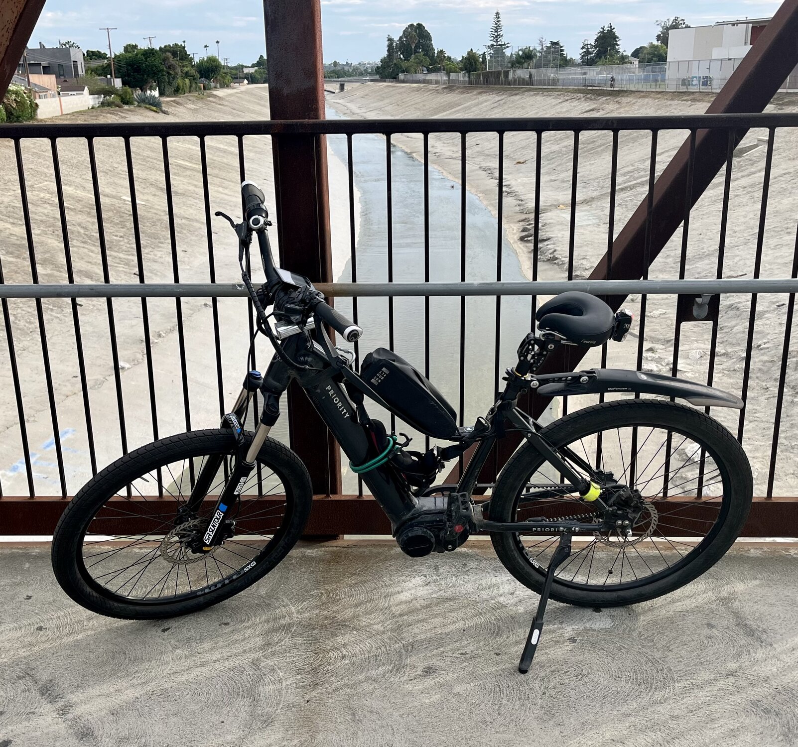

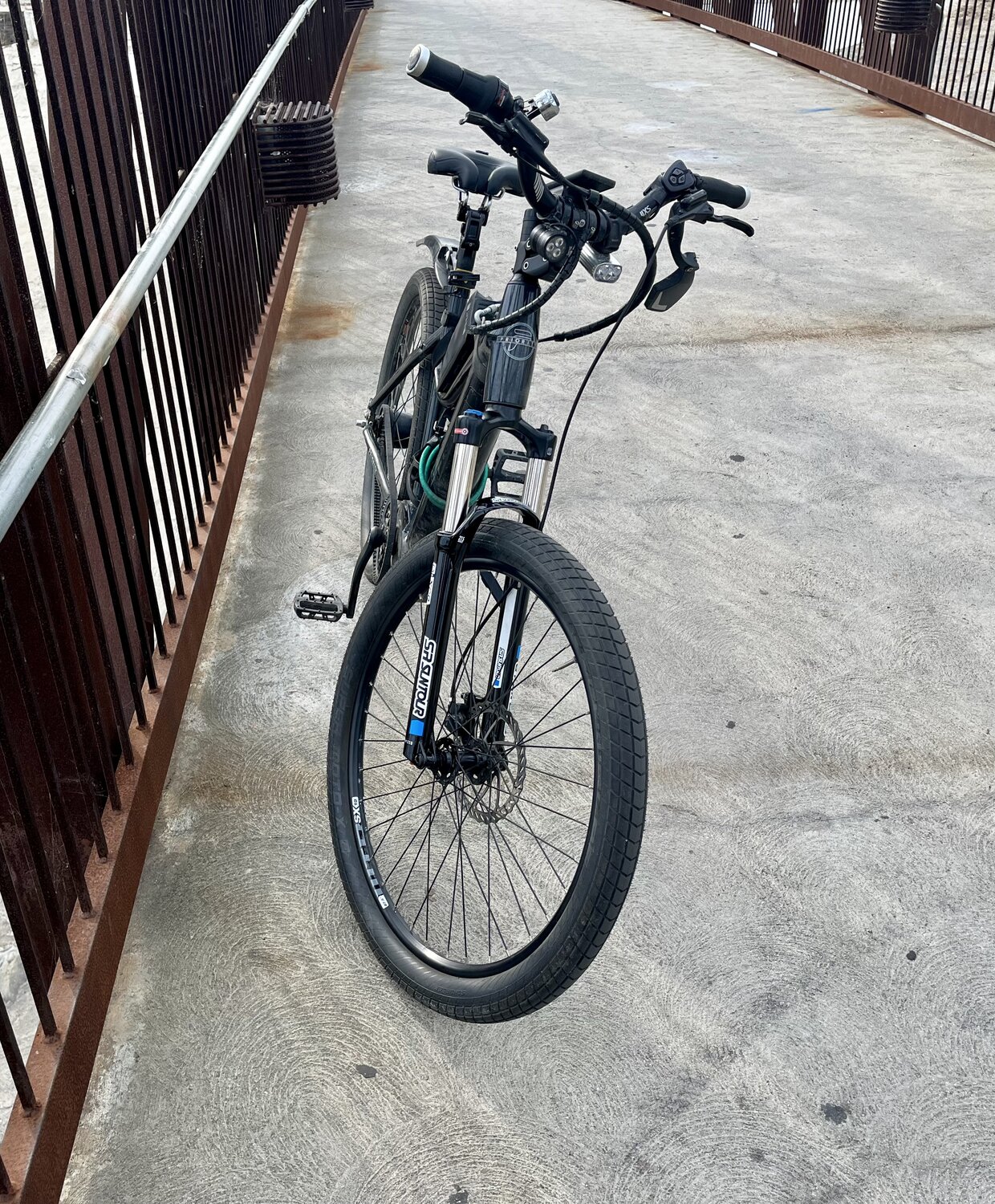

I have a suspension stem, but my other bike (Priority 600x) with a wren fork is so much smoother over bumps. I want to try a suspension fork on my Current. Has any one done this and/or can recommend a fork?
$200 suntour fork. Feels great. It smooths out the ride dramatically better than my suspension stem did.

Be careful with the left side brake cable. You can only go a few inches higher on the handlebars before you run out of cable and will need to replace that too.

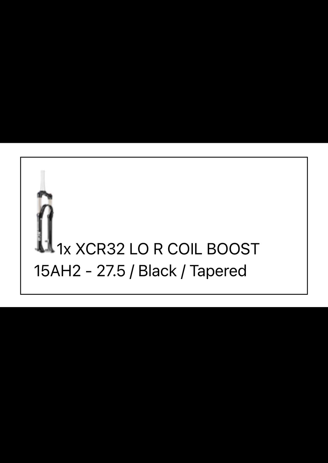

Which forks did you end up getting specifically? SO many options in their fork glossary :)
New handlebars - brake cables worked, but will still get the left side one extended a bit, as you suggested.
Next stop, front suspension:)
