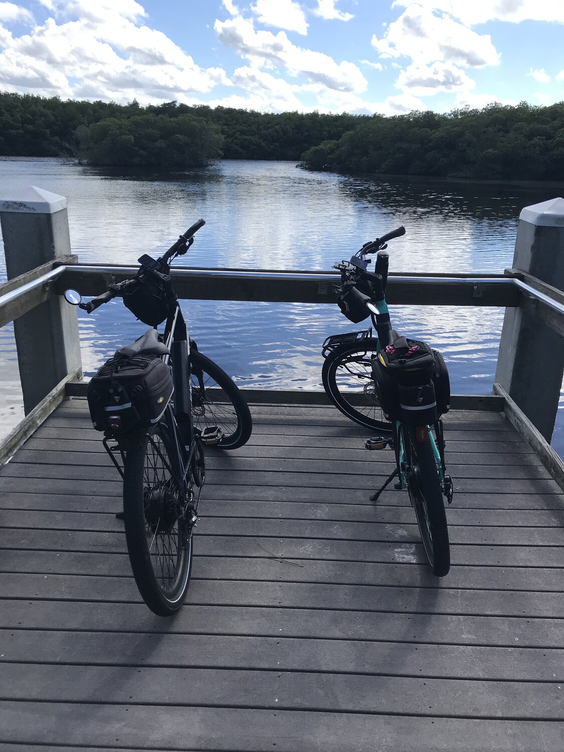

Hi Charlie;
I have a Pace 500 also. The stem is adjustable and you can also replace the handlebars to one with more rise. I personally found that the original handlebar was not ergonomic for me. I replaced it with a MTB handlebar ( more flat) and it made all the difference in the ride …..at least for me. So if you raise the stem adjustment a bit and add a handlebar with more rise, then rotate the handlebar as needed back towards the rider, you might gain the adjustment you need that way.…and get a better ride.
Handlebars are fairly inexpensive and easy to replace.
just a thought…..
KWR
