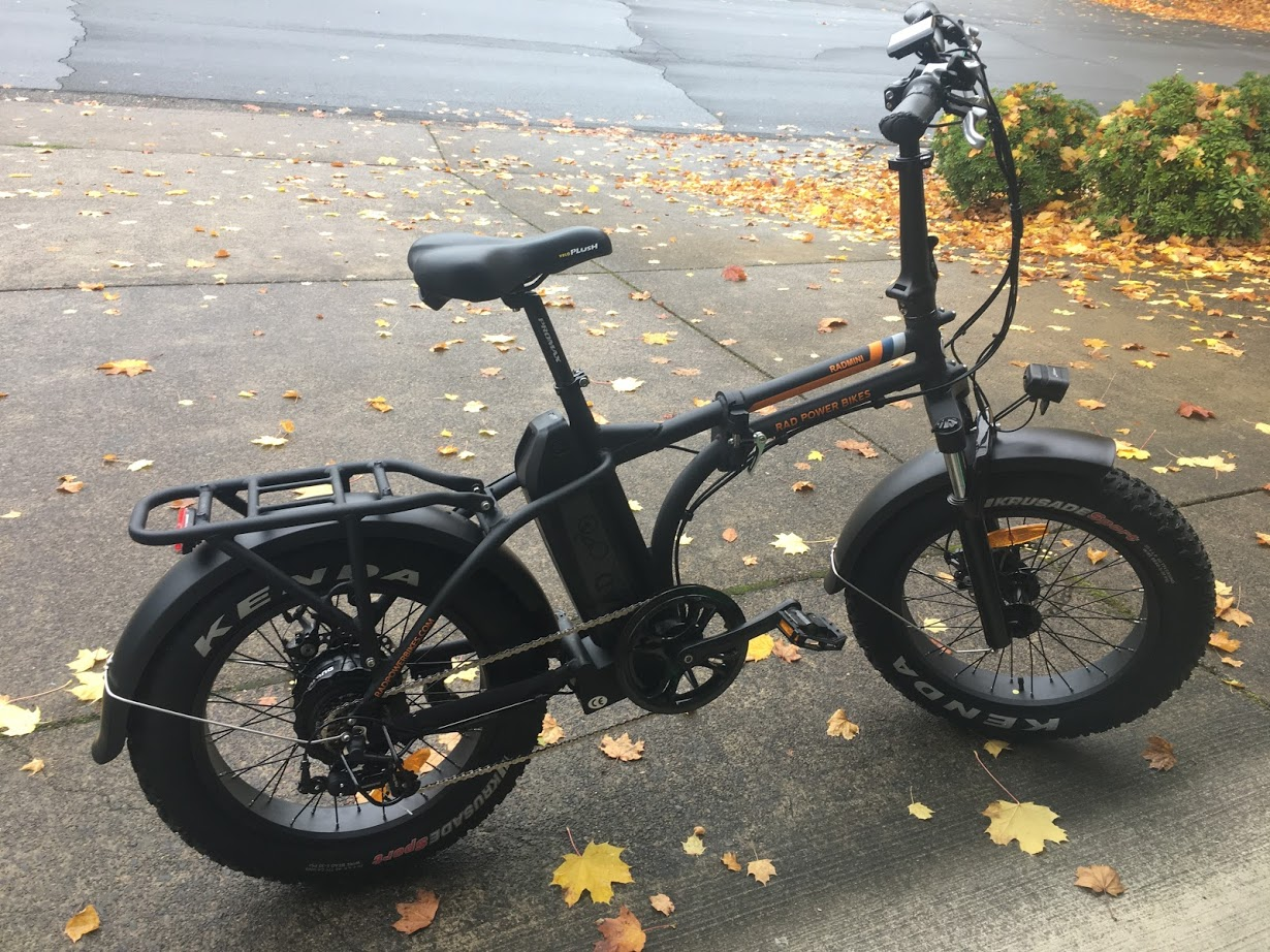

I installed the fenders on my new RadMini today and had a heck of a time getting the rear wheel back on. I sure hope this gets easier, otherwise I'm really doubting my desire to repair a flat while out riding. Most of the issue seemed to come from the torque washers, or getting them aligned in the drop outs. Anyone else have issues with this? I was thinking that with a new bike, perhaps the drop outs were exactly at tolerance, as in too close to each other to allow the washers (or wheel) to easily slide back in. I was finally able to get it on by pulling apart the swing arm when the wheel was removed in an attempt to gain an extra mm of separation. That and I put a small drop of oil on either side. After that I was able to get the wheel back on, but made me think what a pain in the rear this would be out on the road, at night, in the rain, ha ha.
One other concern is protecting the display on the bars when flipping the bike upside down. In the garage today I simply used a couple blocks of foam on the grips which kept the display above the ground, but these are to big to carry around. Maybe just a towel or something would help?
Finally, does anyone know where the serial numbers are on the 2018 RadMini's? I tried a search, but only response came up, saying on the forks behind basket, (for years past).

Curious why you would have to take of the back tire and wheel to install a fender?
That's the recommendation from Rad Power per the install video:
Basically it's to gain access to the two interior attachment points where a bolt goes from the inside of the fender to the stantion on the frame. There is a guy who made a video where he was able to get them on without removing the wheel but he did have to deflate the tires and made it look like a royal pain. Besides, I wanted to experience it for the time I get a flat while out riding. I wanted to know how difficult it was and to see if I might learn any tricks to make it easier or what tools to pack in my trunk bag.
But, at least it's done!
