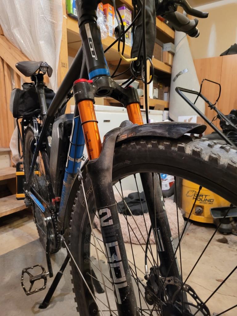

I've got a Bolany (might be an acronym for Baloney 😄) air suspension front fork on my EMTB. Bolany is one of Amazon's favorite Chinese brands. It works fine. I certainly notice the difference in my shoulders after a ride if I've flipped the lockout on the fork by mistake. You do have to check the air pressure before a ride and maybe top it up, but with rechargeable air pumps now, it's not a big deal.
I've got a Bolany (might be an acronym for Baloney 😄) air suspension front fork on my EMTB. Bolany is one of Amazon's favorite Chinese brands. It works fine. I certainly notice the difference in my shoulders after a ride if I've flipped the lockout on the fork by mistake. You do have to check the air pressure before a ride and maybe top it up, but with rechargeable air pumps now, it's not a big deal.View attachment 83387
Is this the Avalanche?
I have no idea what an Avalanche is, but I assume it's a brand of bike. I just used a GT Karakorum frame, only because the triangle was big enough to fit my battery. I threw away all the stock parts and put higher quality components on everywhere. Even the Bolany is a substantial upgrade to the cheapo Suntour suspension fork that came with the bike. The biggest problem I had installing it was getting the star nut into the steering tube. I found out you should use another special tool, but I also figured out that if you use a big enough hammer, it can be installed reasonably straight.
