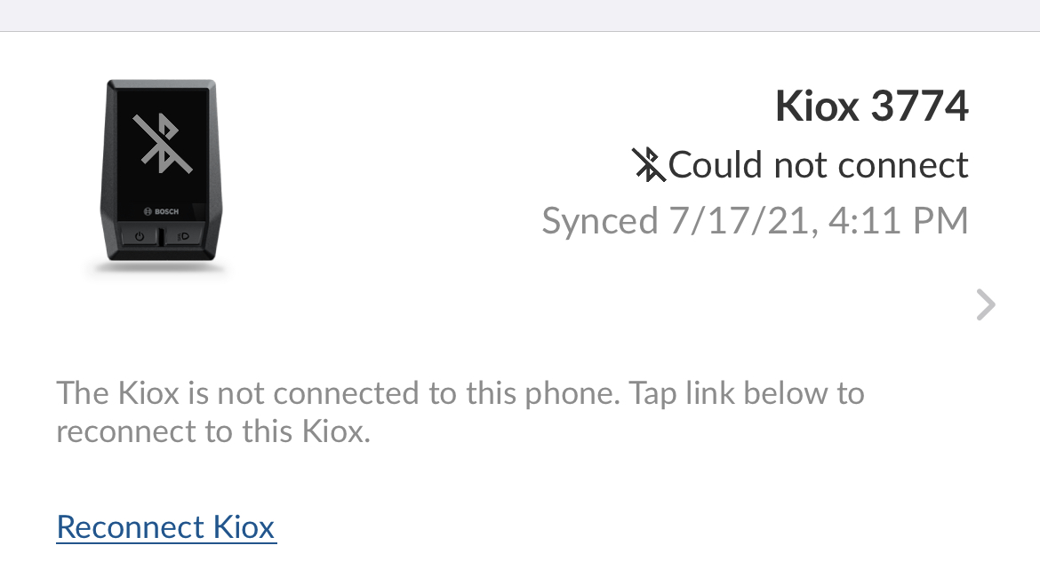

I have been using one of the bikes since then with no issue. Today I took the second one out for the first time since changing phones, had a good ride, but when I went into the Bosch app afterwards to see my ride data I noticed it had not paired to that bike’s Kiox - which is now not showing in my Bluetooth settings.

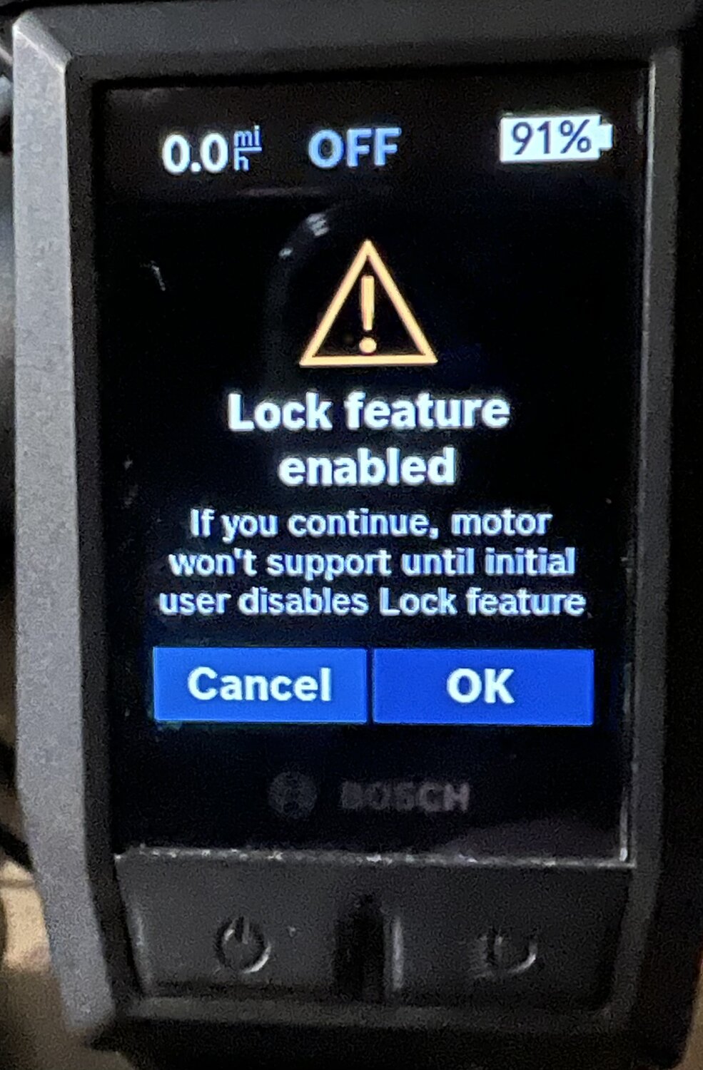

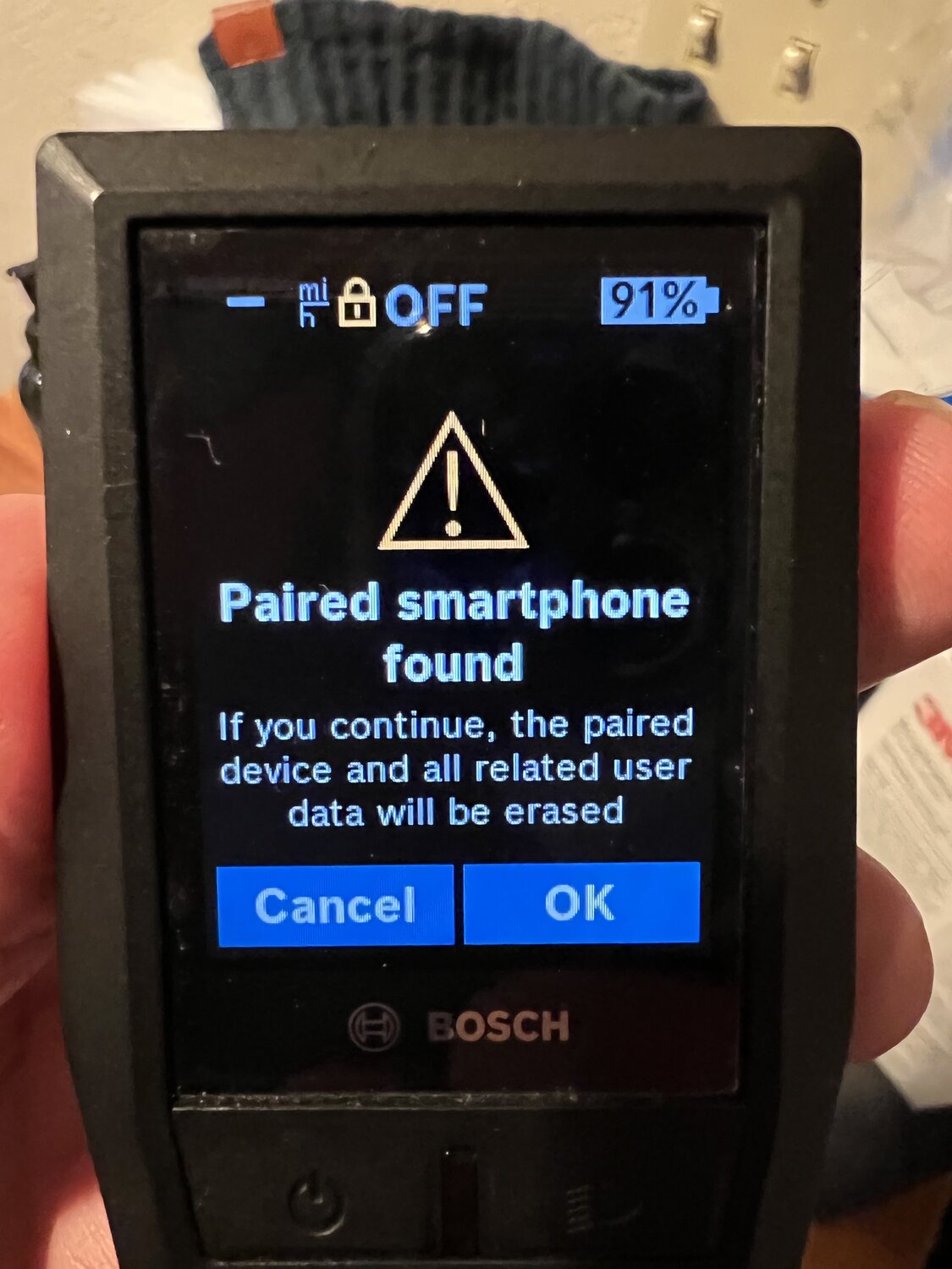

No big deal, I thought; I’ll just re-pair it. But when I go to put the Kiox in pairing mode it is warning me that it will erase all data from the paired device (see attached; it's unclear on whether it is referring to the phone or the head unit here, but given I don't have the phone I assume it means the head unit). If I say OK I get the warning that the motor "won't support [sic] until initial user disables Lock feature". Once again this is very unclear and I am worried the bike will be permanently locked if I proceed. Has anyone had this problem and what happened?

I finally got a response from Bosch; they told me I can ignore the warnings, so I went ahead and re-paired and all seems to be good now, apart from the lost ride data.
