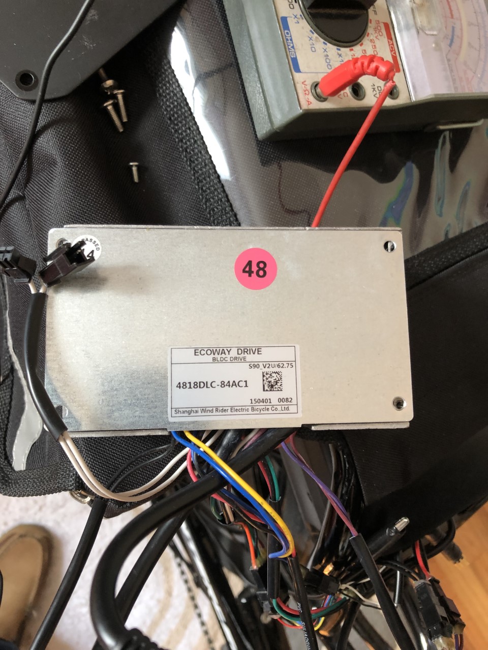

I am looking for a replacement "speed Controller" for my 48 volt Pedego Interceptor.
It is a 2015 year and tbe original part #4818DLC-84AC1 (ZN180507-436).

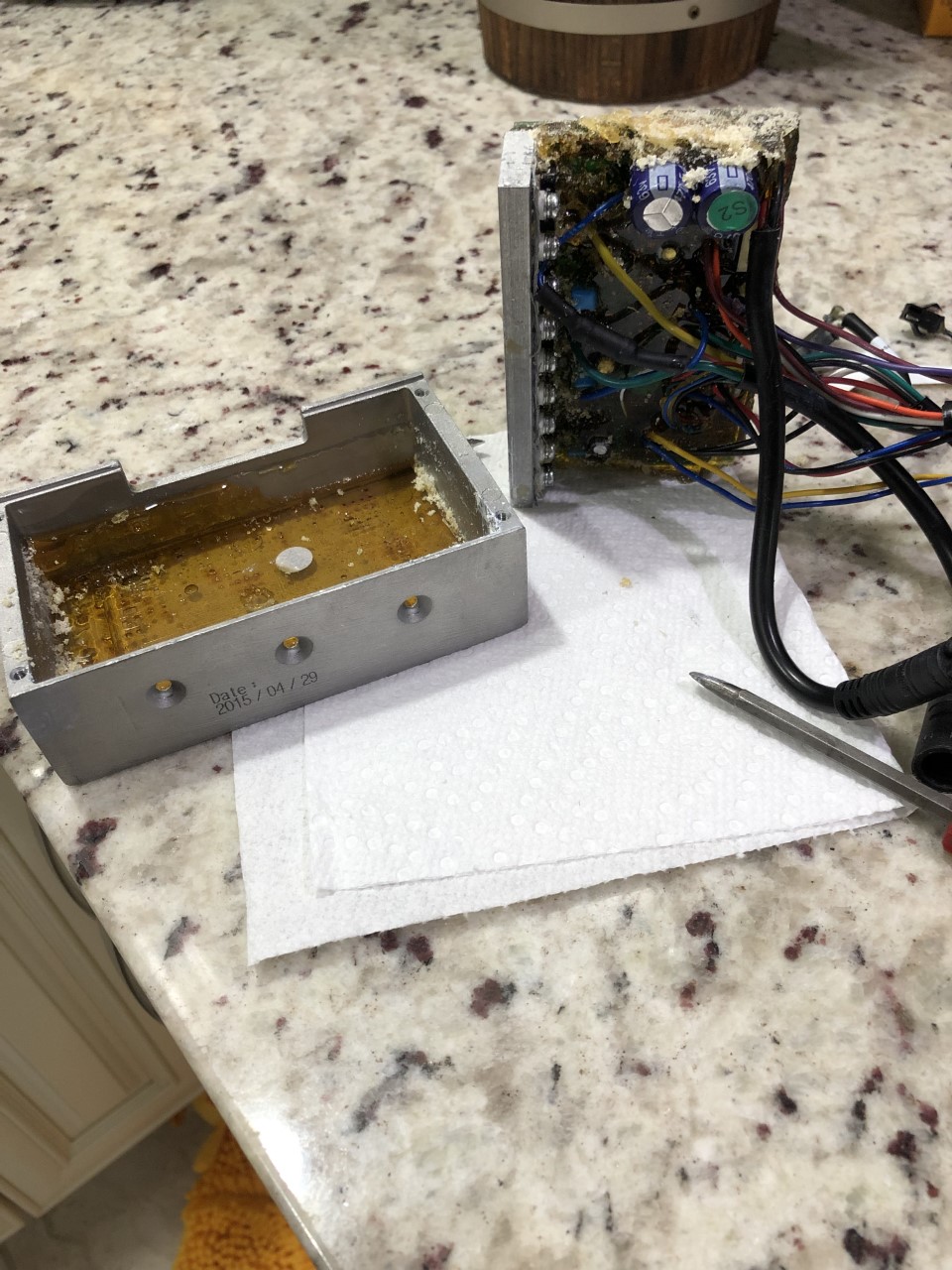

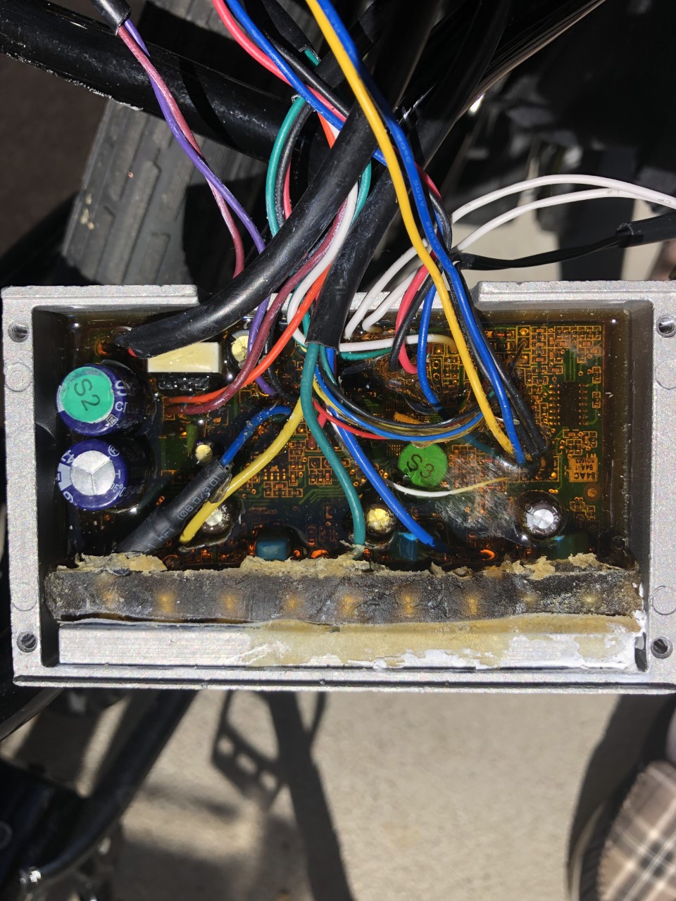

The printed circuit board and contents are covered in a semi-rubberish-clear-plastic material, making it very difficult to repair.
Any information is greatly appreciated.

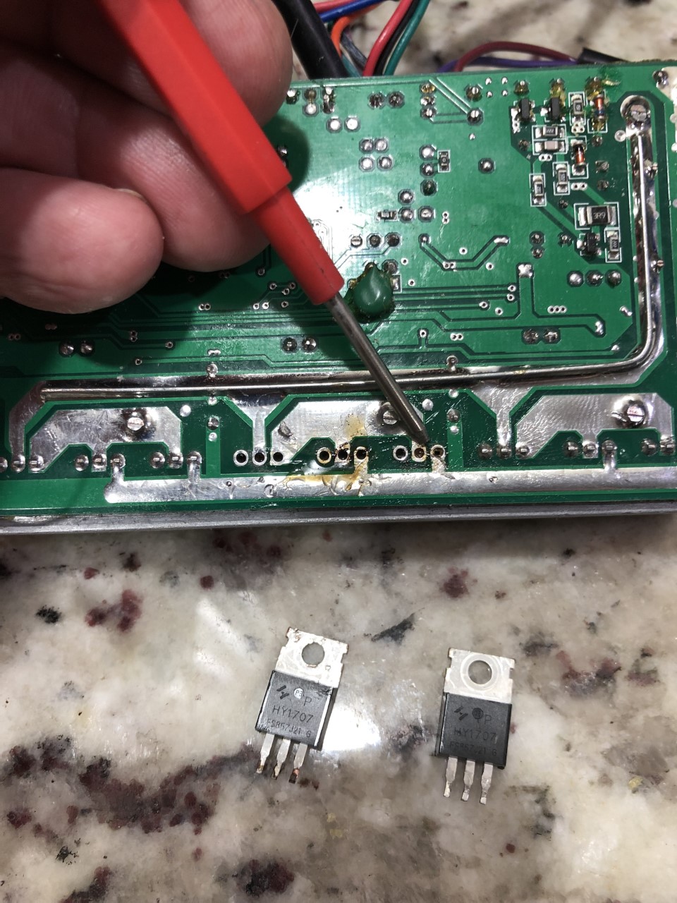

UPDATE 12/24/21:
I was able to replace 2 "shorted" MOSFETs and the speed controller is back in service.
I am still interested in a standby replacement "working or not".
Thank you again...

Hey, yeah, thats the gen1 ananda controller their hard to find, I think we may have one left in the store, I'll check tomorrow.
Andrew

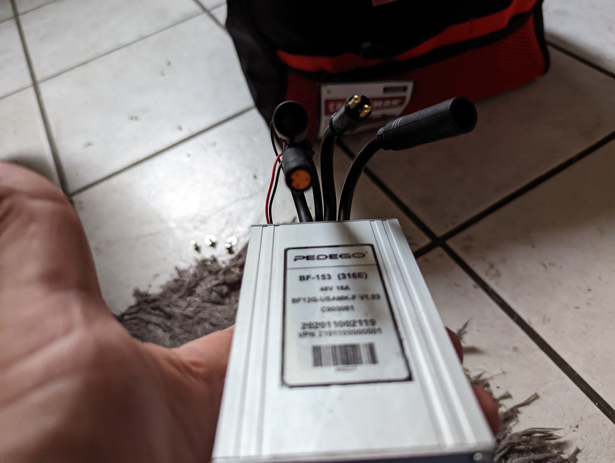

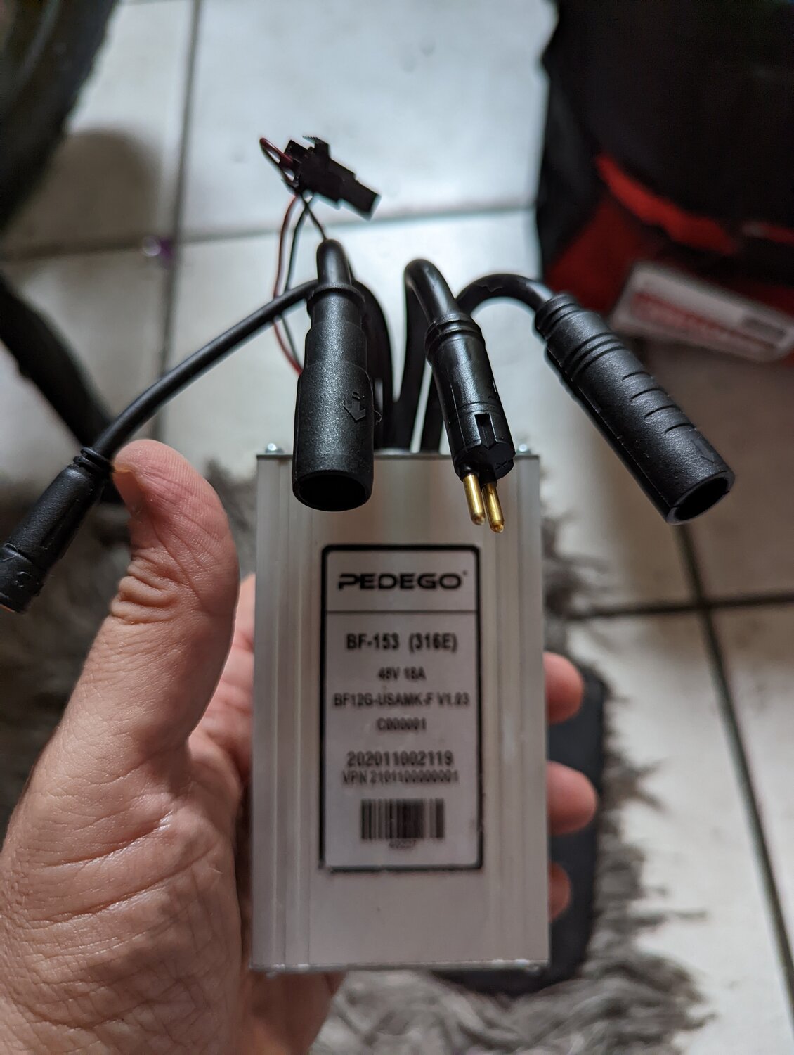

i have a pedego element with the warranty just past expiration. i got error code 15 and i need a new controller. where can i find or order one and just install it myself?

From all of my research that I have done, they are very difficult to find to next to impossible.
You would have to call numerous EV bike shops as I did to see if they have your unit or a compatible replacement in stock.
I have not been able to locate one for mine at this time.
I was able to repair mine as shown in the previous treads.
I have seen several on eBay, some on amazon, aliexpress & alibaba, but again if it's not an exact replacement, you will need to research as I did.
Pedego factory "customer service" should be able to help especially if it is just recently out of warranty.
Error Code #15 is the communication between the LCD panel to the speed controller, according to Pedego chart. Just be sure to double-check the cable to the
LCD panel. Dirty / corrosion connections might be causing a simple repair.
Sorry I couldn't be of more help.
-Rex-
