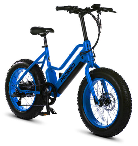

I wonder if the Element you test rode was the previous version to the one I purchased. If the one you test rode looked like this (screen captured from

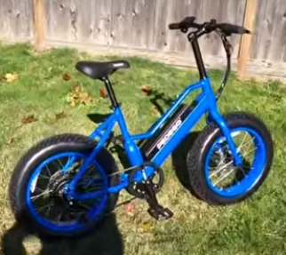

then you tried an older version. Note the battery location. This is the one I have:
While the ride is definitely different than what I get on my 1987 Schwinn Cimarron or my Pedego Avenue, I didn't find it particularly unstable. It is a little harder to ride slow than other bikes I've ridden but I didn't find it twitchy. Maybe this has to do with my experience riding so many different bikes over the years. Some of what you experienced might be the shorter wheelbase, though it is definitely not as responsive as my mid-1970s Raleigh Team Pro racing bike. I can't ride very long without a hand on the handlebars since it will start to shimmy rather violently. With the 14Ah battery mine weighs in at 60.4lbs according to the spec sheet. My Pedego Avenue classic, on the other hand, weighs in at 52.4 lbs, also with a 14Ah battery, so I wouldn't consider it that light of a bike. That being said, I don't have that much direct experience with very many different ebikes.
FWIW, the Pedego Sequim store had one Element of the older frame design, but I did not test ride it, so I don't have any way to make a comparison. I wanted the under-tube battery position and blue so didn't even inquire about it.
