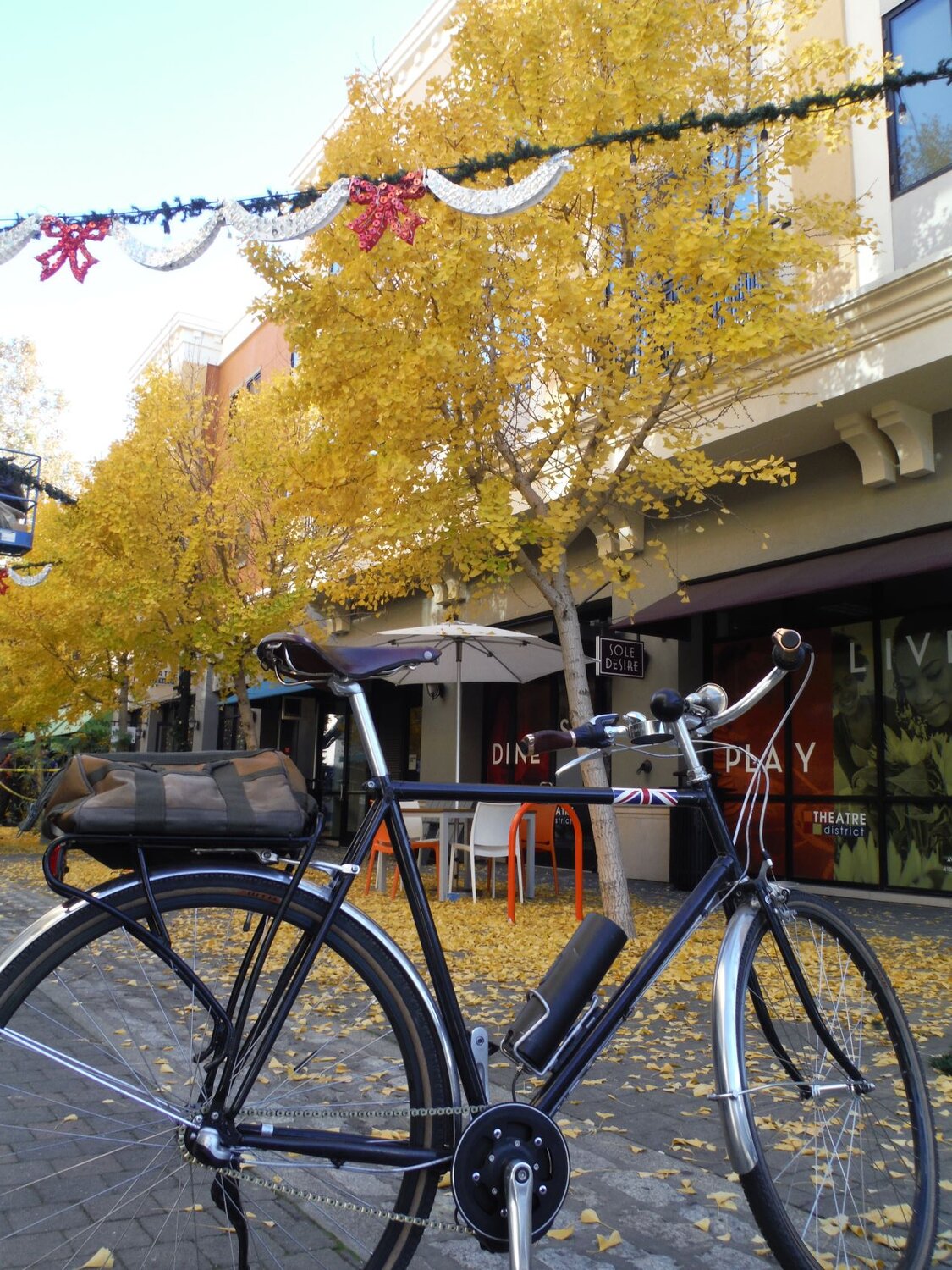

Show us a photo of your bike.

An okay starter bike. Getting into the game is the main thing. That is good. Yet, the superior bikes, your next upgrade, do not look electric and perform better. Far better.
