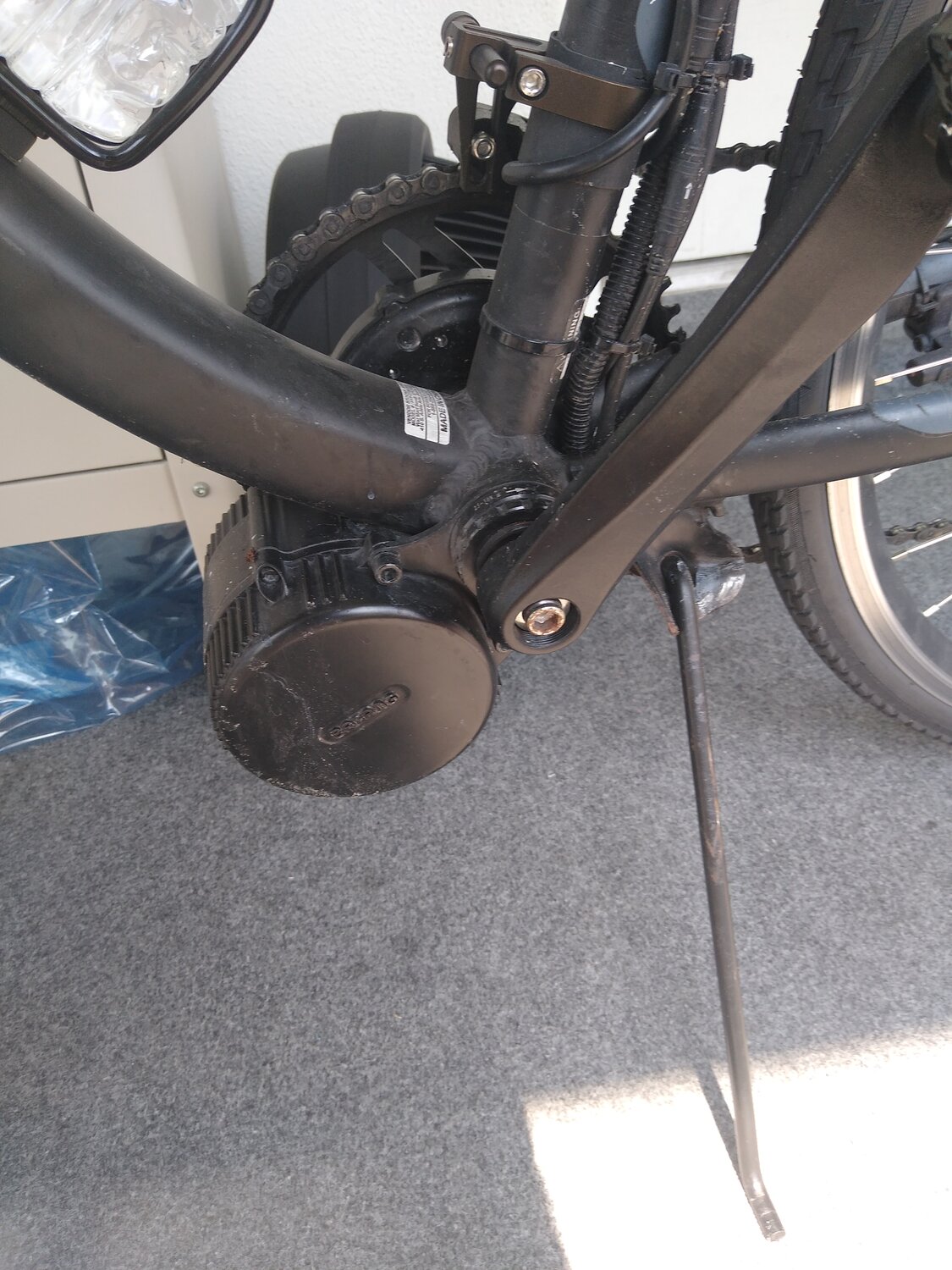

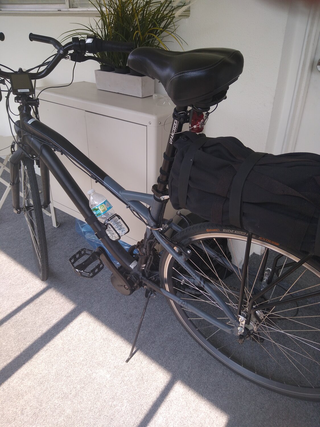

Was super easy to install a bafang BBS on the bottom bracket. I ordered a connector for the Lectric battery and use it in a bag strapped to my rear rack. All connectors are color coded, the controller & cadence sensor is built in to the motor so just mount the motor, battery then display has the throttle and controls mounted to the handlebar. Motor kit $450, used hybrid bike $120 and it's lighter, faster and goes further than all the $3500 bikes so far. Check out some YouTube videos on how to install and with some ability using tools it's very doable.
