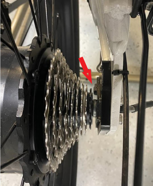

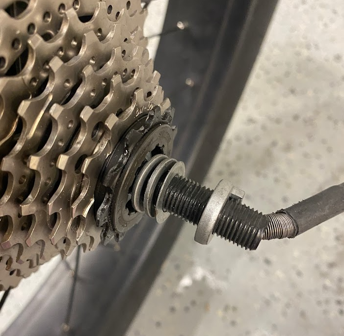

Glad you finally got it resolved. So I have been working with Juiced support on installing a wheel that Juiced repaired the Hub tower and cassette. Basically a bearing failed on a new rear wheel and they replaced the drive side of the rear bafang hub. The cassette had a different spacer installed after the repair causing the gap between the 9th gear and Speed sensor to change. They told me the gap between the 9th gear and the sensor should be 2mm or less for proper reading. I have attached a picture of the gap you want to check when troubleshooting the pedal assist. The hub spacers are different depending on the cassette assembly. Recessed hubs use washers and flush hubs don't use any. Juiced has a document showing this. My assist is intermittent after removing the rear wheel
