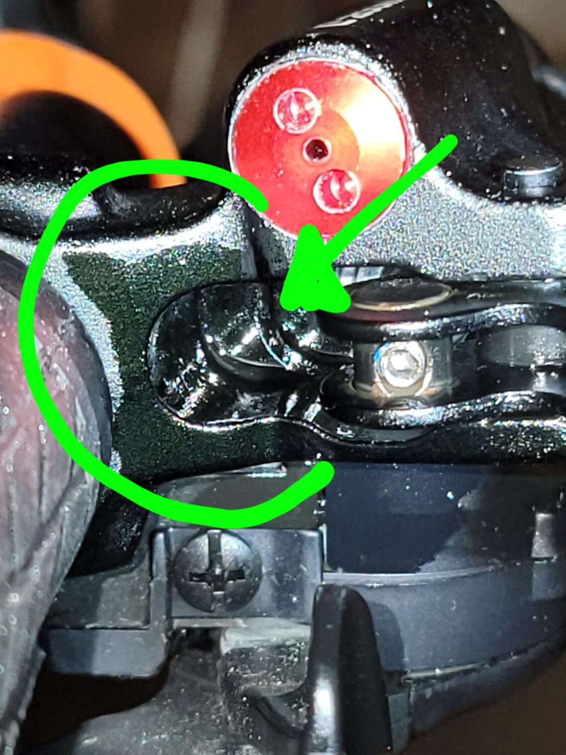

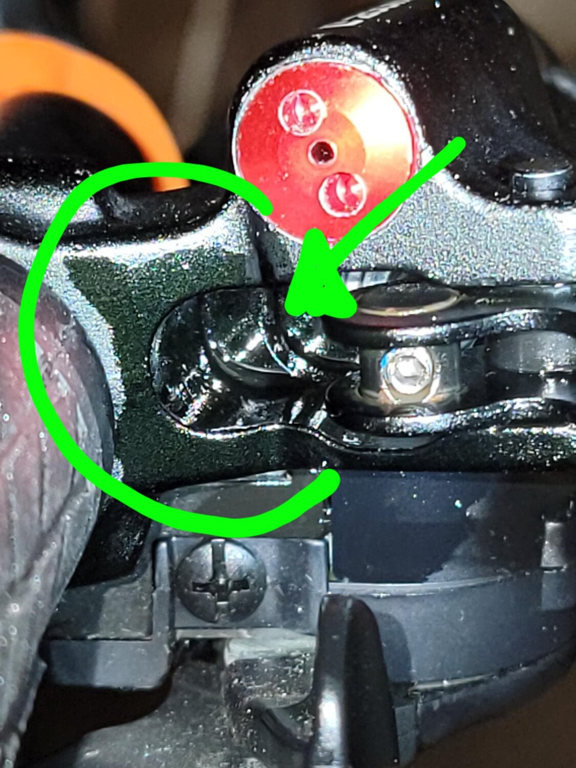

I have a leak at around the rear brake lever near the piston of my Zoom hydraulic system. Lever has no pressure and goes all the way to the handle when compressed. Contacted Aventon support about it. Initial response was they couldn't make out the picture of the leak I sent, so I emailed another. Now I'm not getting any response whatsoever. Bike is a Pace 500 and only had it for six month, which mean it's still under warranty. Looks like Aventon is goo
d with taking my money, but not very supportive when it comes to their warranty or customer service. Anyone have any suggestion on what else I can do before I escalate?

I have a leak at around the rear brake lever near the piston of my Zoom hydraulic system. Lever has no pressure and goes all the way to the handle when compressed. Contacted Aventon support about it. Initial response was they couldn't make out the picture of the leak I sent, so I emailed another. Now I'm not getting any response whatsoever. Bike is a Pace 500 and only had it for six month, which mean it's still under warranty. Looks like Aventon is gooView attachment 113563d with taking my money, but not very supportive when it comes to their warranty or customer service. Anyone have any suggestion on what else I can do before I escalate?
