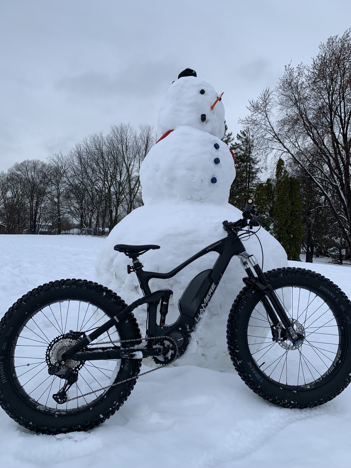

I just got a great e fattie dual susp
Bike is from LaMere Cycles in St Louis Park, MN
Got it just in time for 2 back to back blizzards here in St Paul, MN
Custom carbon frame with 5” studded snow tires.
Friggen awesome in some snow conditions!
My city neighborhood was a snow bike Disneyland!
In 4 days of new snow, some epic conditions and some impossible conditions, I rode about 12 rides and loved it.
The beauty is —— bike just converted to summer
setup with 29 x. 3 wheelset.

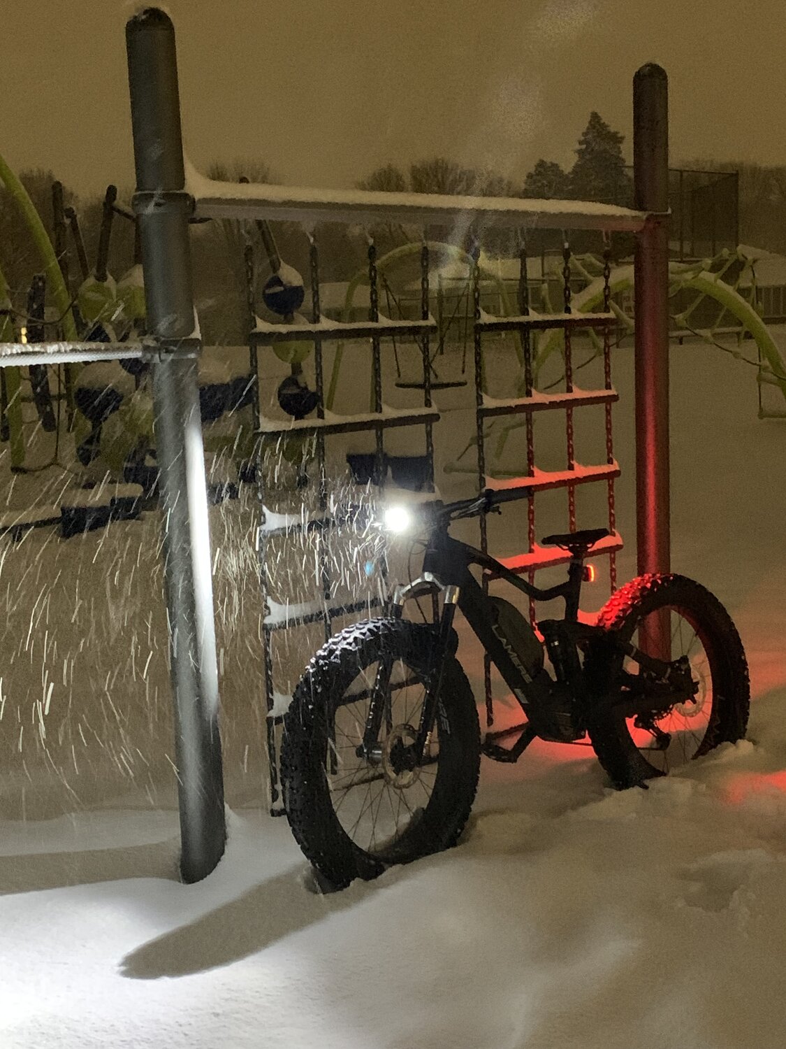

I will try to post pics: night eide after midnight in snowstorm, 4th ride of that day.
Looks like a lot of fun! Nice- What model is your bike?

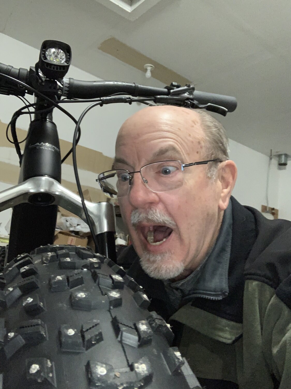

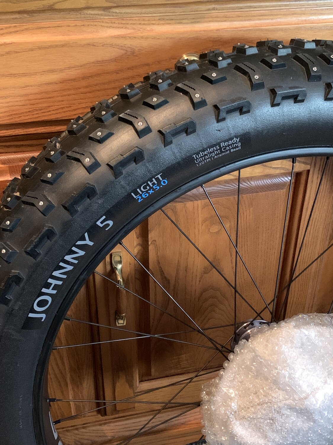

Where did you find your 5" stud tires?
1000w Bafang mid drive?

Johnny 5 with studs (oh so tiny studs) but did cross some glare ice very carefully.
LaMere is the shop and brand of their own frames and creation, the e-Summit.
Awesome snow bike , so much fun and not much concern about falling… so what if you fall in the snow
Shimano EP 801 with 630 WH battery

Thanks. Nice tire and bike!
I found these more aggressive bicycle studs that insert with a push tool, instead of using an insertion gun or screw in type. They only offer 4.6" wide on this webpage that I noticed anyway. https://bikestud.com/collections/studs
Not very deep knobs on the bicycle tires to hold bigger studs.
On the dirt bike tires, we have a Bruno Wessel pneumatic gun, but its still quite a forearm workout to stud tires.
Interestingly, I like to run a front studded tire even in the summer because it offers such superior traction upon dry hardpack with loose material on top. If on bedrock and large cobble, not so nice!
