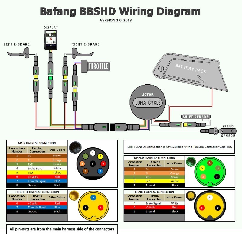

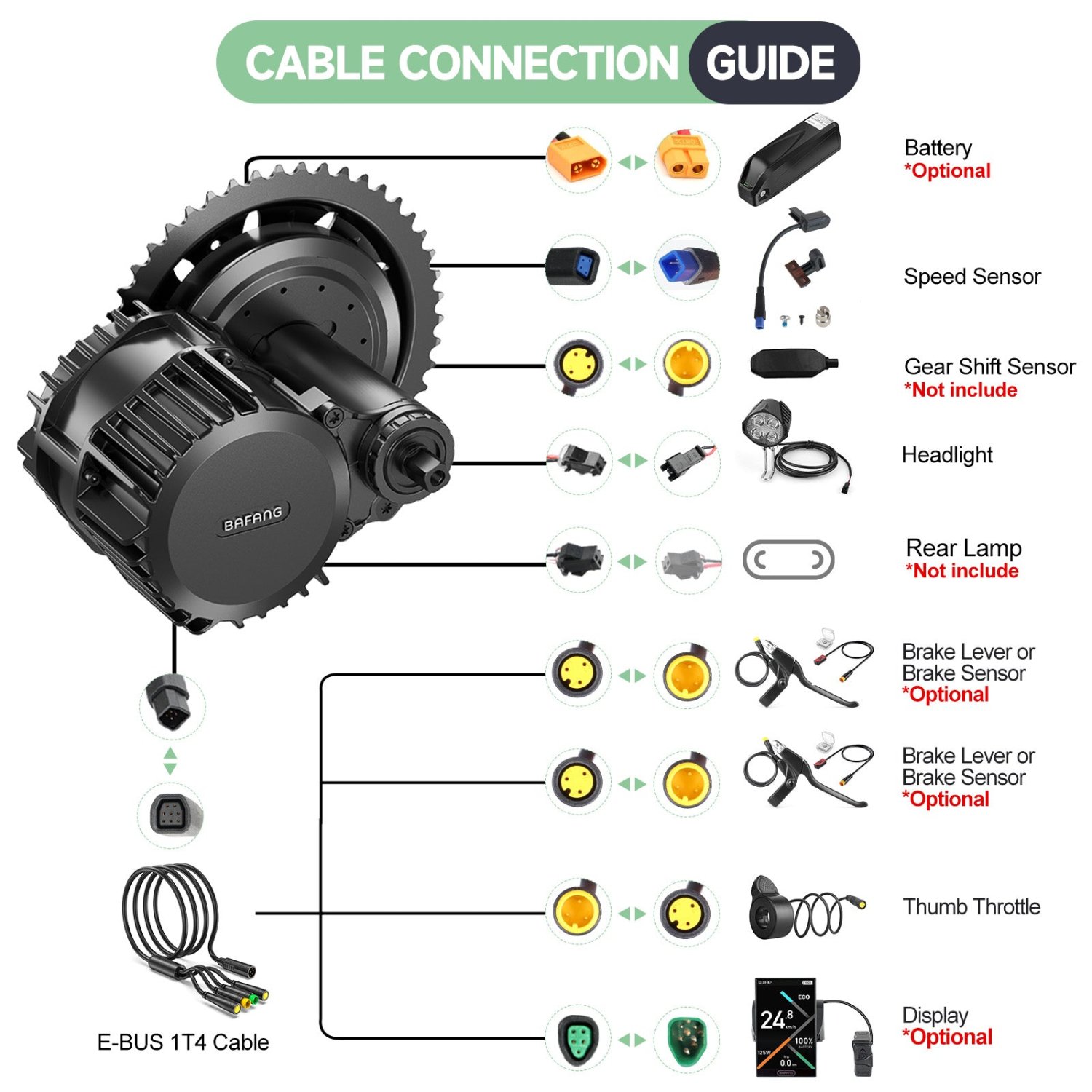

Duh, it's a great place.I took my battery up there and there's nothing wrong with it. It's very frustrating.I'm not being able to find a clear wiring diagramI have one extra bring five pin plug.I can't figure out where it goes
Do you have the UART or CANbus...
Wiring is the same... Shape of the connector changes.
This is CANbus
CircuitConnectionforBAFANGCan-bus48V1000WM615MMG320.1000.CBBSHDE-BikeConversionKits.jpg
The only 5 Pin is the display
This is an older UART not showing the 2 light connections
