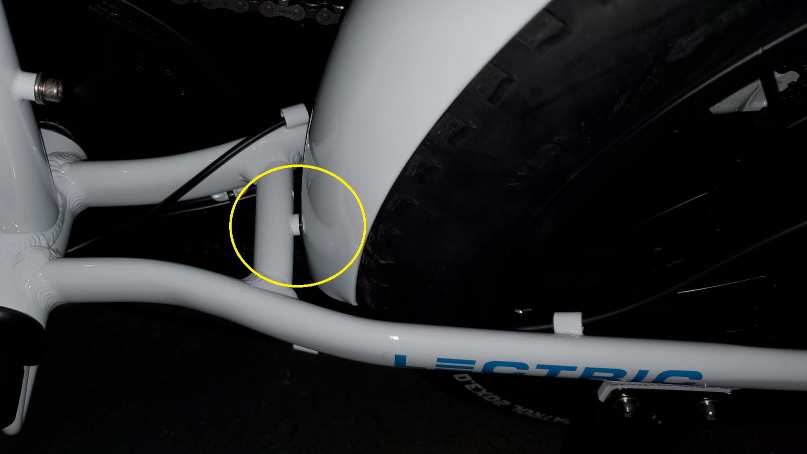

So....I "think" I may have found the problem. I bought two Lectrics, a step-through and a regular one. The step-through was the one with the problem and was a gift to my GF. I tried two replacement wheels that Lectric sent but the problem was not fixed. The GF was not happy riding around on what sounds like a $100 Walmart bike with the rattling/grinding sounds whenever the motor is under load.
Last night I spent about 3 hours in the garage putting my troubleshooting skills to work. I swapped the rear wheels between my bike and hers. No difference. That ruled out the wheel.
I then started going over every screw, bolt, connection point, etc... and confirmed that they were all tight. I went over the frame with a fine toothed comb to make sure there were no visible cracks. I rechecked the latch tightness.
Something caught my attention though while I was looking at everything that closely. The screws that attach the rear fender to the frame were as tight as possible but I noticed that the fender is resting directly against the metal of the frame. Metal fender directly touching metal frame = possible source of metallic rattling/grinding sound.
Rather than spending even more time dismantling and removing the fenders I decided to put a thin black plastic washer between the fender and its mount on the frame. After doing this I took the bike out for a spin and the noise was pretty much gone. I still haven't tested it under load going up a hill but after I had swapped the wheels I rode it around the neighborhood and it did make the noise. After adding the washer it did NOT make the noise.
Here's a picture showing the fender attached after I added the washer.

Based just on this thread alone, I'm obviously not the only person who has experienced this noise. I'm very surprised that Lectric isn't aware of this possible cause and they just keep telling people it's normal. Sorry but this isn't "normal". If this really is the source of the noise, it's a design flaw that can easily be fixed but a $1200 bike that sounds like you're dragging a shovel behind it is neither normal nor acceptable. I wonder how much money they've wasted sending people new wheels when it's possible that a .10 cent washer is the solution.
I guess the next question is - If this is really the cause, what is causing the vibration? I don't think it's the motor since I've tried three wheels on the bike including the one from my other bike which I know is fine since my bike doesn't make this noise. Is it just the nature of the step-through frame?
Anyway, it looks like the noise can either be eliminated or significantly reduced by adding a washer as my picture shows.
I won't have a chance to go for a longer ride and do a more thorough test until this weekend but based on last night's findings I'm guardedly optimistic that I've found the source of the noise.
Interesting. That's the screw I can't easily get to because of the small clearance with the tire in the way. I've reached out to Lectric and they are sending me a new controller (already received a new wheel). The CS person has assured me that this will take care of the problem. We'll see. If not, then I guess the wheel is coming off and I will make that adjustment.
Yeah, you have to take the wheel off to get to that screw. Not an issue for me since I've taken off the wheel about 10 times over the past couple of weeks trying to figure this out.

So my saga continues.... The washer I added to the fender's mounting point did help but it didn't completely eliminate the noise. I have now spent more hours troubleshooting this problem than I have actually riding the bike. I don't think the cause of my issue is the wheel or motor. I have a step-through (the noisy one) and a regular frame. The regular frame one is fine so I took the wheel from it and put it on the step-through. The bike still made the noise.
It's either something on the frame or attached to the frame that is rattling, or, it's the controller. I asked Lectric to simply exchange the bike since neither I nor they can seem to determine the cause of the problem. They said no and scheduled a call with one of their techs next week. So, on top of all the time I've already wasted on this problem, now I have to take time off from work to talk to one of their techs when I'm in front of the bike.
Very unhappy with Lectric at the moment. This should not be happening with a brand new bike out of the box.
After my recent experiment with the big sponge-jammed-under-the-rack, I really suspect it's a sympathetic vibration in the rear fender. One way to check would be to remove the forward fender-mount screw completely and see if the resonance disappears. It appears that to get to that screw one needs to remove the rear wheel, but no big deal, you have to remove the wheel anyway if you get a flat, so not a bad thing to practice. And you may be able to remove the axle nuts and move the wheel out of the way to get to that screw without even having to disconnect the motor connection--I have no idea if this would be the case.
If the vibration is being transmitted through that screw mounting, I doubt a plastic washer would make much difference. Perhaps two small o-rings, one on each side of the fender, would provide enough isolation if the screw was not tightened down.
As for controller issues, I don't know how a controller could be causing the noise. My 2.0 XPst controller maxes out at 18a but I can pull that much current at most speeds, while the buzzing on my bike comes at around 11mph only--so it's rpm-based, not power-draw-based.
And I have no issue at all with max-throttle 18a hill-climbing for minutes at a time. The 2.0 controller seems to work fine on both our bikes. The difference between the 2.0's 18 amps and 20 amps on the 3.0 is a very small distinction which still helps a bit when the 3.0 is touted as being able to carry a 150lb passenger!

I also suspect it's a vibration based on the fact that the plastic washer between the fender and frame made it a little better even if it didn't completely eliminate it. I've been looking for a rubber washer or o-ring of a size that would fit instead of the plastic washer but so far I haven't found anything that's the perfect size.
And to add to the annoyance, the last time I worked on the bike there was a new buzzing noise. Not sure where that one is now coming from.

It doesnt have to be exactly the right size, buzzing is a clue, completely remove the rear fender and see what a difference that makes, when something hits its natural frequency you are going to get harmonics.( maybe that is why so many ebikes come without fenders )another thing to keep in mind is the tires and road surface.Perhaps a little bit is expectation as well, most lower end bikes are not going to be as silent as an acoustic bike or a "specialized" e.g.
