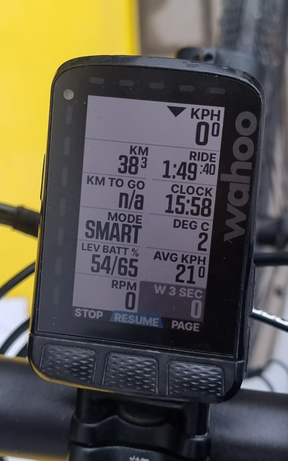

Besides, I use a Wahoo ELEMNT Roam that connects to both Specialized Vado and Vado SL. Wahoo can even recognise the SL Range Extender. I'm riding without the map today.
Everything I need to see for an SL ebike
The unit will run for 17 hours on a single charge.
As you can see, I'm using Smart Control today. My phone resides in my pocket with the screen off.

Yet you haven't been happy with the underbaked Specialized app on your iPhone so I offered a practical solution to you.
