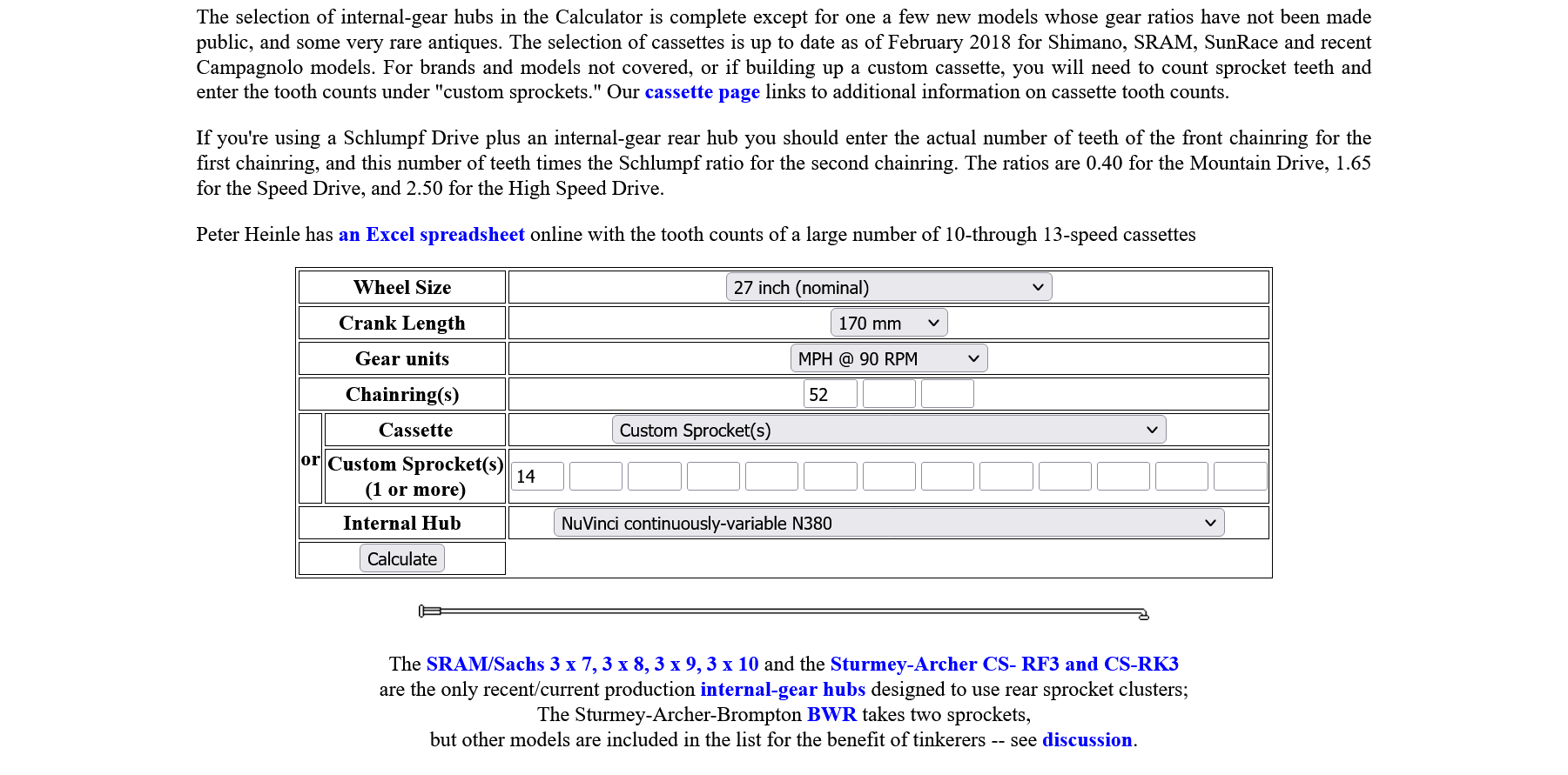

I like to pedal at a fairly high RPM of around 90. You can use a gear calculator to determine what speed you will get in each gear at a particular RPM. I don't know what RPM you are comfortable with, maybe 80? Change the Gear Units on the calculator below to MPH @ 80 RPM and enter your chainring size and select the cassette you are using.
https://www.sheldonbrown.com/gear-calc.html

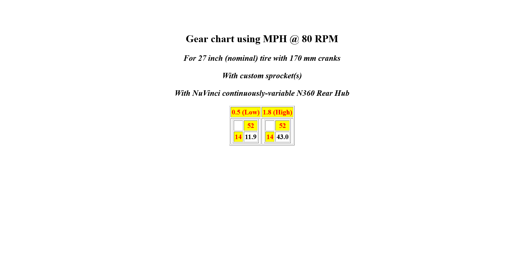

52 will be fast with the 14. Sheldon Brown says your top end at 80RPM cadence is 43. That is not KPH, that is forty-three Miles Per Hour! Please translate that into English
Go here: https://sheldonbrown.com/gear-calc.html
52 teeth on the front chainring will be fast when combined with the 14-tooth rear cog on the Nuvinci N360 or N380. When you pedal at a rate of 80 revolutions per minute you will go 43 miles per hour in the highest gear. Cadence is the rate of pedaling or pedaling speed. At a cadence of 90 you will go 51Mph. That is not accounting for wind drag but on a dynamo.
