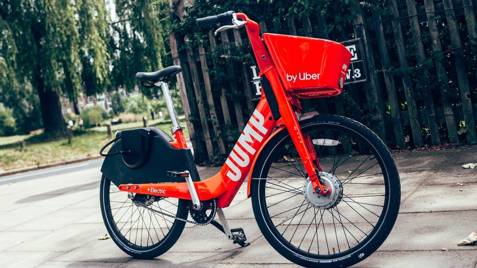

I would add that the motor on my bike came off a defunct Uber/Jump bikeshare venture on the East Coast of the USA. It went defunct, and thousands of front wheel drive bikes were scrapped. I bought the motor from a scrapper. So before it went on my bike, it was on a red one like this.
