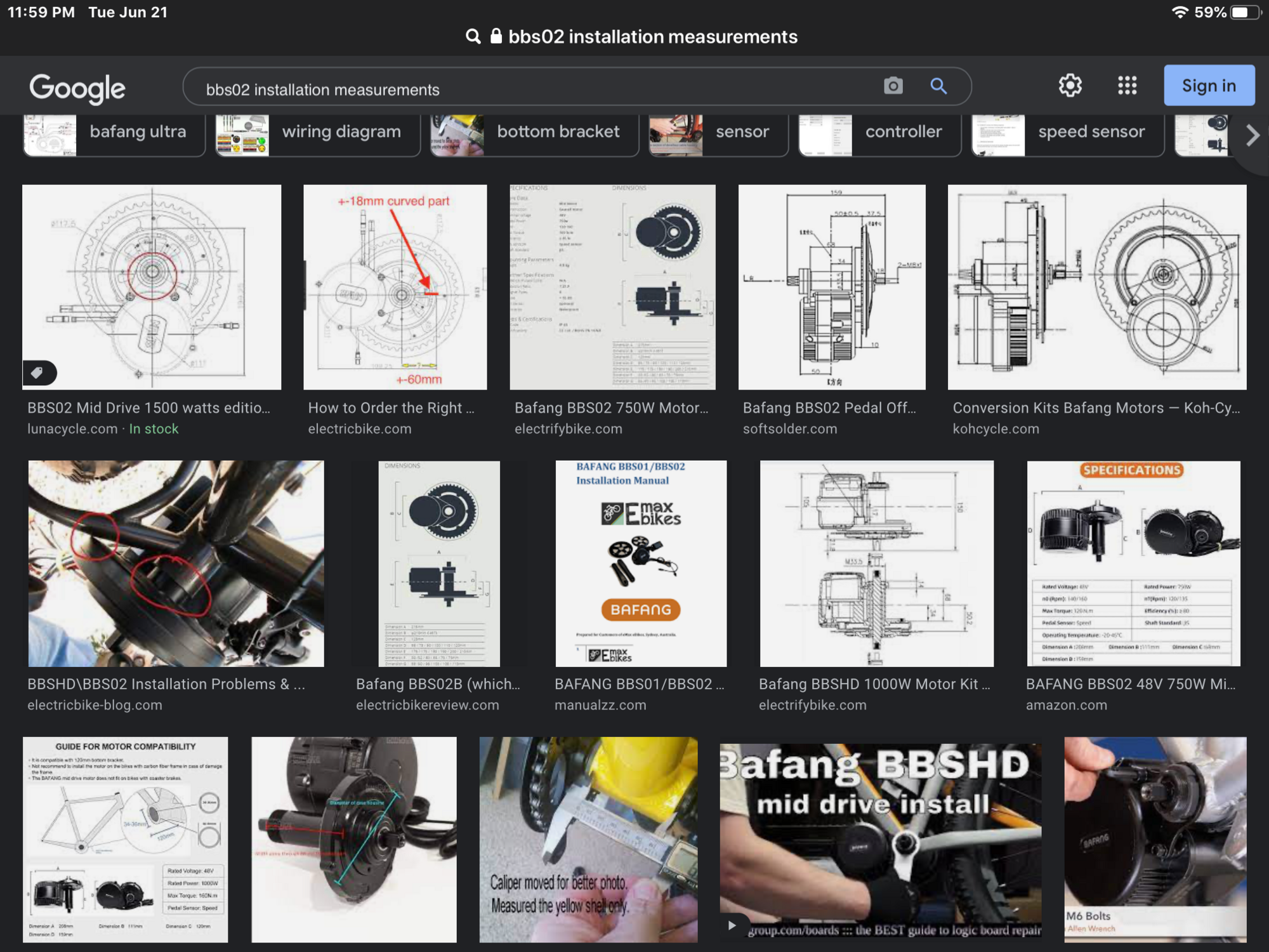

Id stick with the same size chainring. The BBSHD is a tough motor. Capable of still being a great performer with the OEM size chainring.
Google BBS02 installation measurements

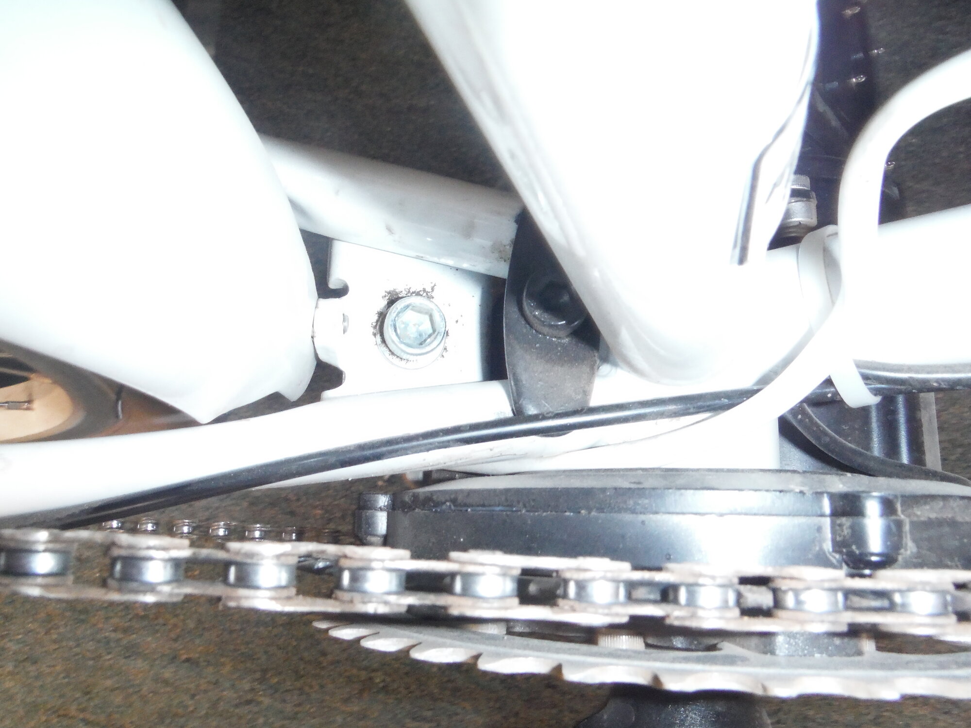

The right chain stay kicks out quickly to accommodate the wide tires. If spacers are added that means more offset in the wrong direction. I had one last week that did not need spacers to the left but it couldn't hit cogs 1 and 2. A 10mm offset chainring took care of it by bringing in the chain line. But then on your bike it could rub the chain stay. This is a tough one for me to call online. Look up ^ to see the red circles. This is not a perfect example but you still get the idea.
I relooked. A key number is 60mm. The motor needs to be at a flat at 90 degrees from the R and center of the bb shell towards the back of the bike for 60mm. That is the distance of three outer chain links. Counting back three links it hits. You can test by removing the cranks and bb and laying a straight edge on the R shell of the bb. How far back before it hits the chain stay from the rotational center of the bb? Please others join in. I don't want to go out on a limb with this.

@czgunner, This is not a perfect example. The bike is dirty. It is a different mid-drive. But, it does illustrate the issue. In this case three inner links of chain (60mm) back from the center of the bottom bracket, the motor housing cannot hit the chain stay. This particular motor is slightly smaller than the BBSO2. Again, it is only the concept illustrated and with a different bike than yours. Having a white bike sure helps the the contrast problems with black on black. Why do they always put the black S on the black S with the Black S? It happens all the time. Even when you shine a light, it is a F-ing black hole to try to work on. Then some bitty black screw drops down lost. A forever rattle?
