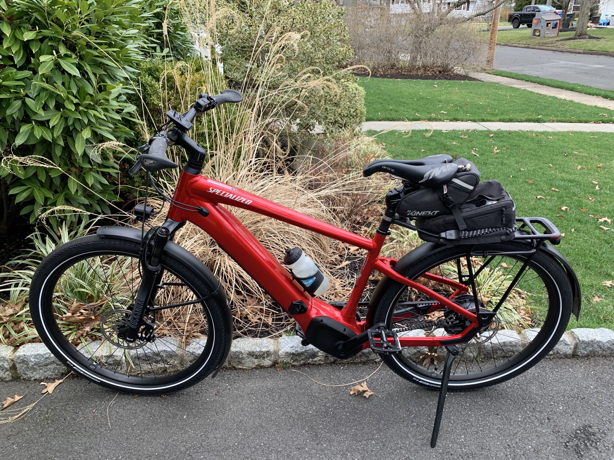

Took the bike for a 28-mile 1st-day ride and overall I was very impressed.
The overall feel, handling, and performance are one of the best I've had....this is my 6th e-bike in the last 5 years. It just keeps getting better.
Albeit I'll need to embrace the Mission Control having had been a user of BLevo, so it's a bit foreign to me.

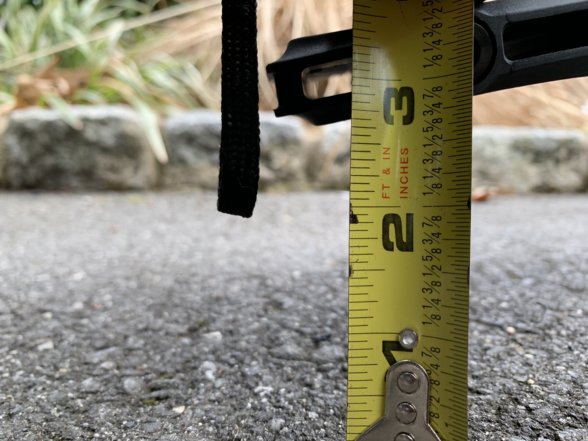

I did have a few items of concern. I haven't checked the specification diagrams to verify but it sure seems that the crank arms are lower to the ground than on either of my other bikes. Several times I could feel my foot scrape on the slightest turning (left or right) when my foot was on the downstroke. Normally I'd have to be really angled to get the slightest 'touching' of the pedal to the ground on any other bike, but this bike seems to be oddly closer than any other. I measure just under 3 inches (see photo).

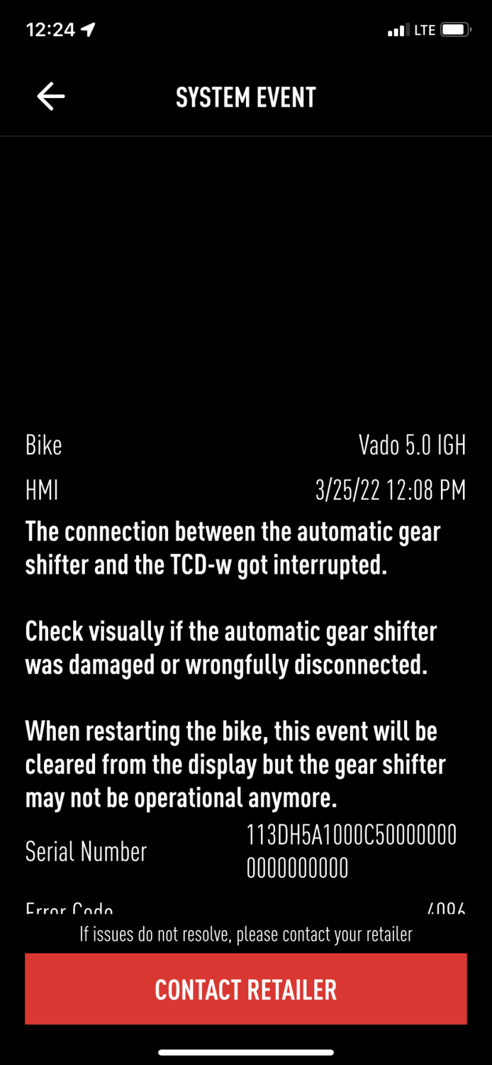

I also got an error 3 times on the display of Mission Control on the iPhone in a "System Event": The connection between the automatic gear shifter and the TCD-w got interrupted. Check visually if the automatic gear shifter was damaged or wrongfully disconnected. When restarting the bike, this event will be cleared from the display but the gear shifter may not be operational anymore. Error Code 4096 If issues do not resolve, please contact your dealer.
I had no issues, have not attempted to do another ride to determine if it is problematic or not. I had no problems riding or shifting, so I'm baffled.

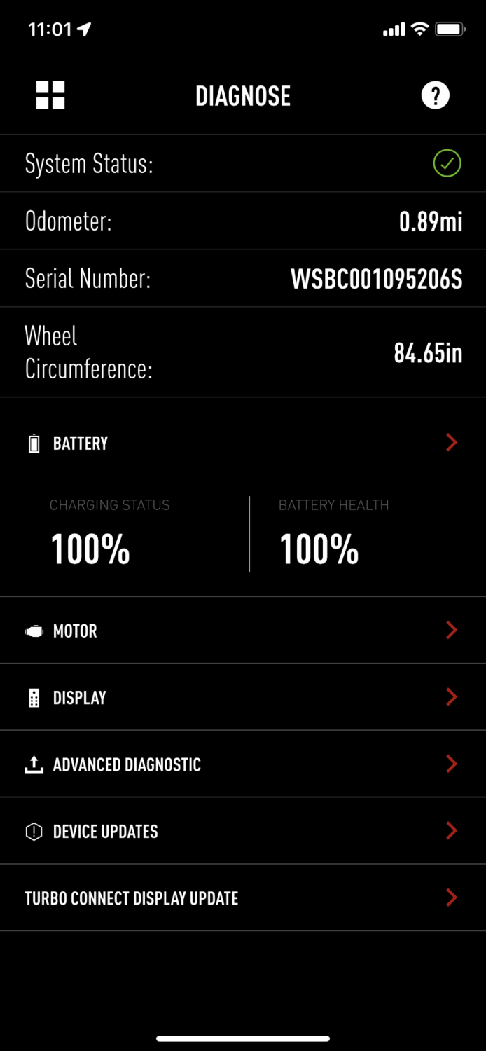

I'm also a little confused about the wheel circumferences setting, is this correct (see photo)? (84.65in)

the pedal strike issue is odd; the bottom bracket height of the vado - at least per specialized - is pretty standard at 285mm. crank should be 170mm, leaving 115mm from centerline of pedal to ground when the bike is vertical. 4.5 inches for those of us in the colonies, which should be 4” clear after pedal width taken into account.
if you’re getting a lot of pedal strikes, be VERY careful. a pedal strike around a fast turn can lead to a bad crash if the pedal hitting the ground causes the rear wheel to lift or lose traction. i had this problem on my creo due to inexperience and poor pedal choice for a road bike - long since alleviated but that bike has a 20mm lower BB than yours.
the only real ways to change this are 1) bigger tires (not recommended) 2) less suspension travel (won’t make much difference unless your front end is really soft) 3) smaller pedals and 4) shorter cranks.
i did #3 and #4 and focused on my technique, always remembering to have the inboard pedal up when turning.
Reminds me of back in the day carving some turns on my BMW motorcycle and impressing my buddies behind me with the shower of sparks from dragging the center stand on the asphalt when I had to lean farther into the turn -- a real butt-clenching moment for me! Ever since, I'm religious about keeping the inside pedal up when cornering on a bicycle, especially since I don't have a good feel for the cornering limits and don't want to discover them by experience (too old for dealing with gravel rash!).
yes. and an inherently bad crash because it occurs at high speed around a corner!!
I've noticed the crank arms seem extra long as well but not sure the size
It should be stamped on them somewhere and is also in the geometry chart on the web site at 170mm for all sizes, which is pretty standard. The BB height is also the same for all.
It seems setup for wheel circumference is hit or miss. If your bike has 650B, 2.3 in wheels, the circumference should be closer to 87in. Good news if this is true is that you went farther than the Mastermind distance may have said. The bad news is that your assist will cut out at a lower speed than it should.
