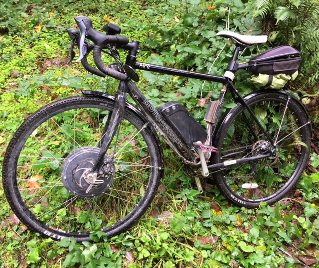

I added the Redshift Shockstop to my non-electric Spot this past weekend. I've only a short test-ride to base this on but thus far I deem it money well-spent. The angle has helped take the pressure off of my hands (didn't need a suspension stem to accomplish this I realize) but the cool thing is that the suspension effect is only lightly perceptible with the elastomer for my weight installed - enough to dampen some vibration but it isn't spongy. What an improvement to the bike!
In addition to the flex stem (happy it's working well for you!), I would recommend Baramind flex handlebars. For me, the combination of the handle bars and a flex seat post handles all but the most terrible of pot holes.
