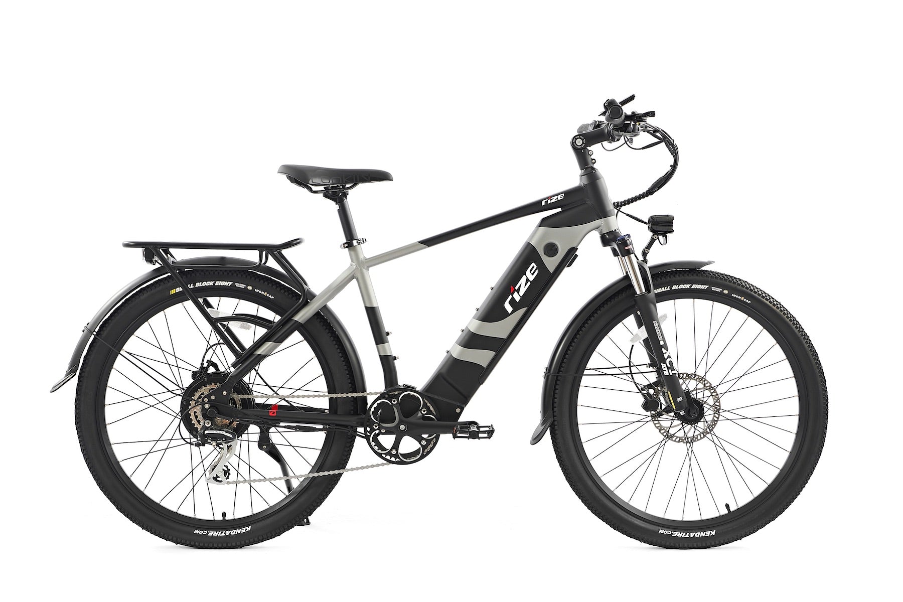

I'm assuming you're referring to this bike?
You're saying that Rize sells 48V 15ah battery for $600 Canadian.
How much does Jenny sell the battery for? And what's the capacity?
You said it's couple hundred dollar more expensive, but for the same spec??? 🤔

More real world/things you might want to ponder a bit. Look at the mounting position of the batteries on the new Rize bikes (and quite a few others) that allow for the piggy back aux. batt. mounting. Would you want a battery the size/weight of one of those 25ah batteries hanging by the little locking latch that holds them in place? I'll pass....
At the very least you would have to install security straps.
I think these big packs would work out MUCH better on a bike that carries it in a "top loading" position, the way Rize and others were doing them for 2020 (last year).
The reason they switched to the bottom mount style was to make room for these "piggy back" packs....
Personally, I'm glad I have a 2020..... No need here for a battery that will go 4 times further than my butt can. -Al
