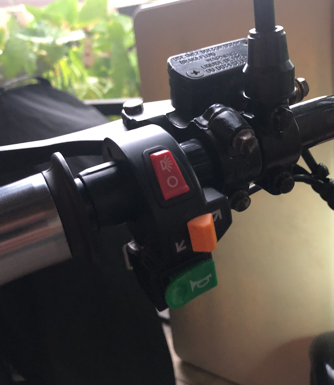

My biggest challenge was then the wiring for lights, because there is a common ground for everything, then there are running lights that are supposed to be On with the ignition switch, and then regular front light, turn lights and horn connected to the left side of the handlebar,, and them the breaks, that are coming from some pressure switch on the levers.

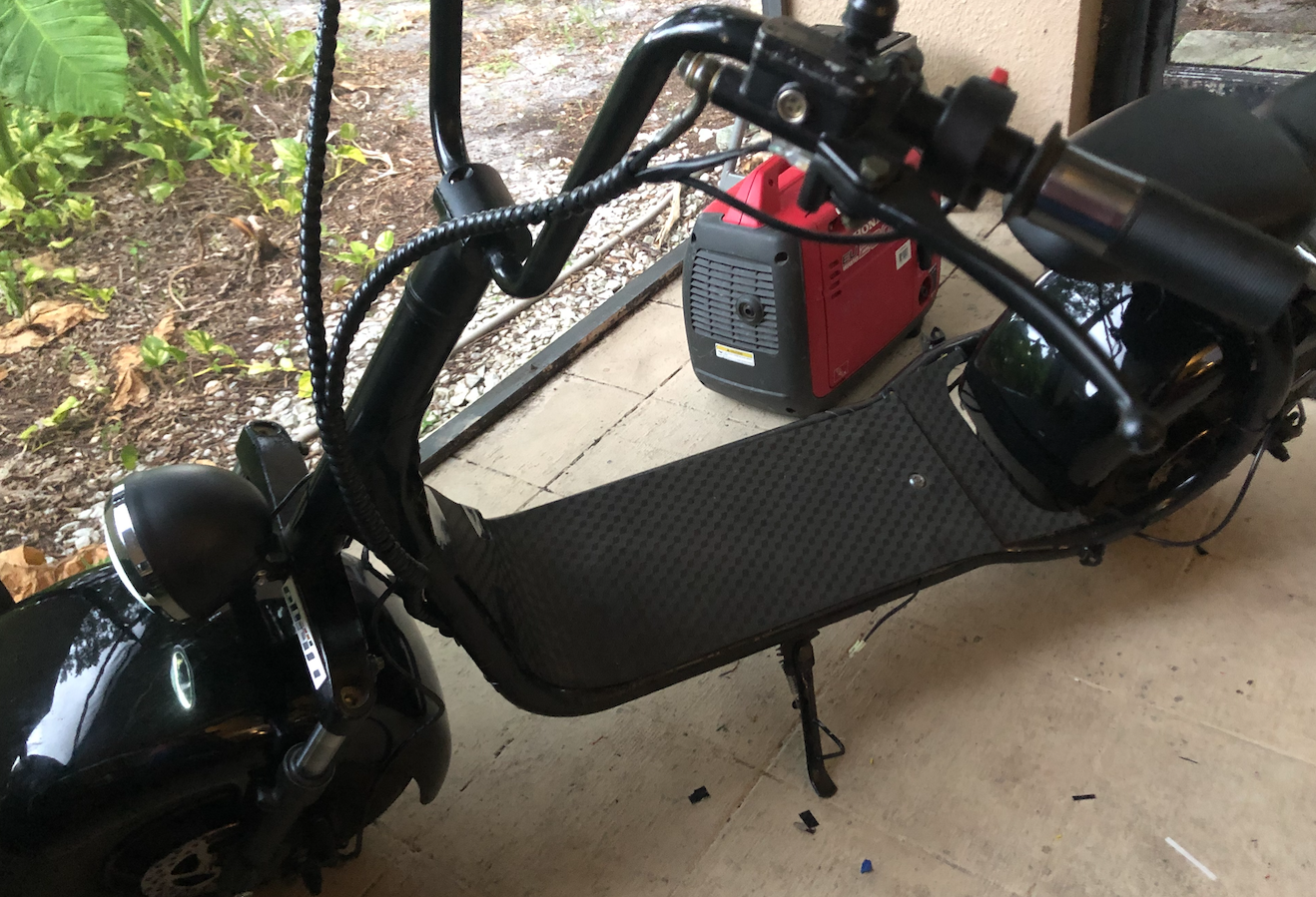

This is the scooter:

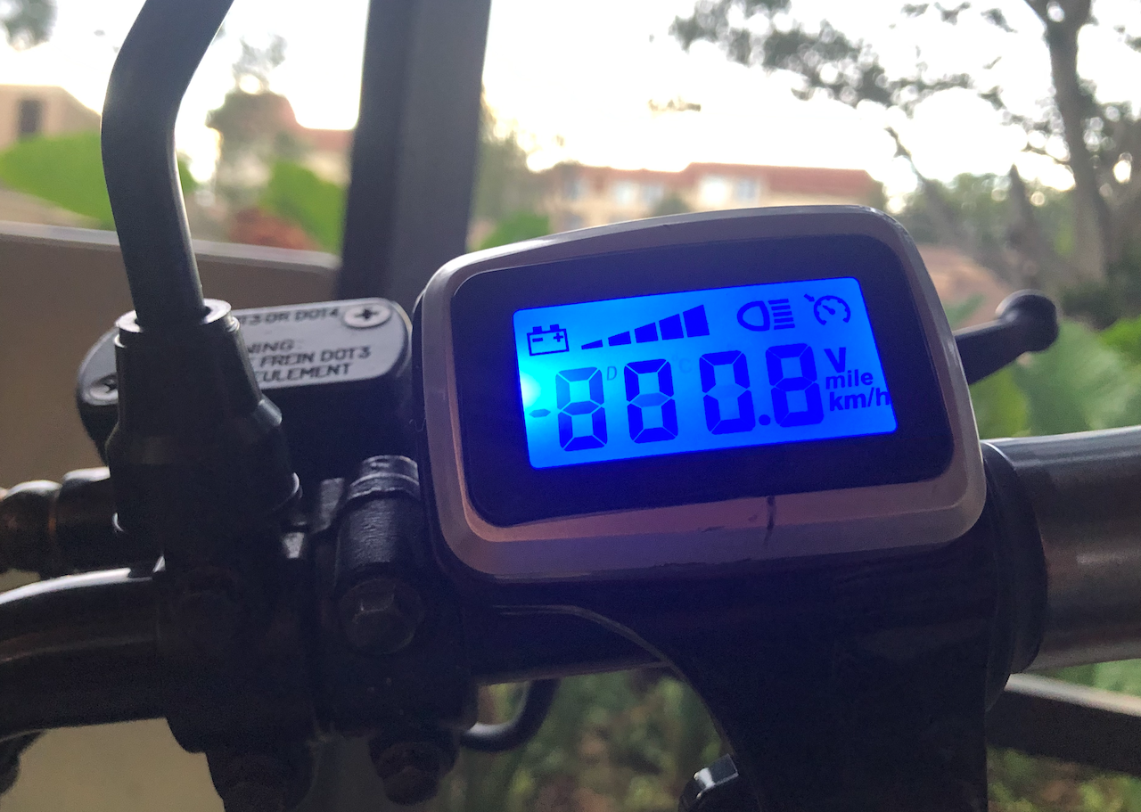

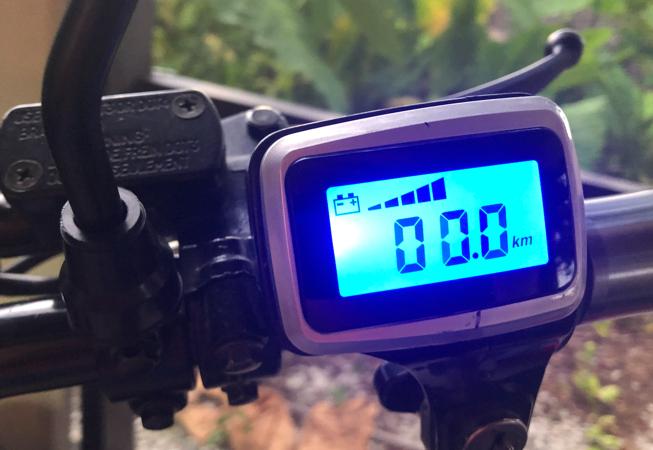

The LCD is on the right side, I was able to connect it and show only those two things so far,, the numbers increases with speed, all the way to 41 Km (I assume it means KPH)
If I look at the LCD sideway, I see it has more capabilities,, but only one wire on the LCD is available to data, so Im not sure how the controlled could send more data on the same wire it is already sending speed.
These are the controls on the left side of the handlebar

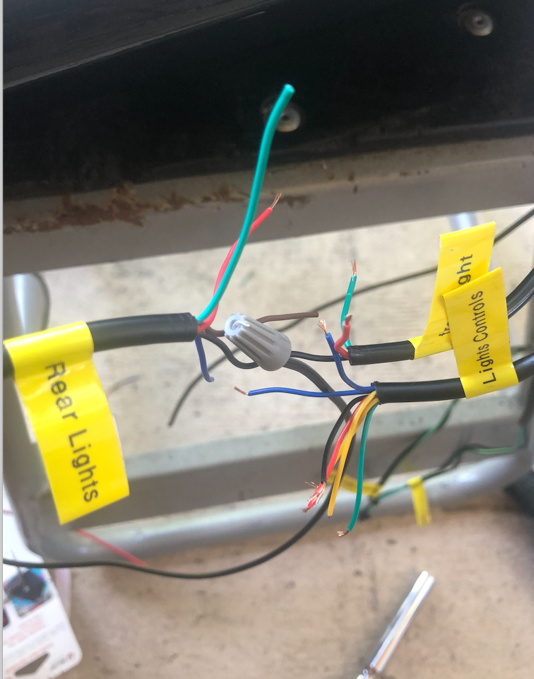

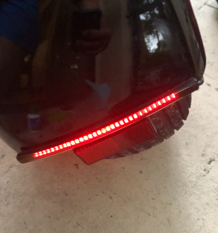

Rear running lights seems to be working fine now:

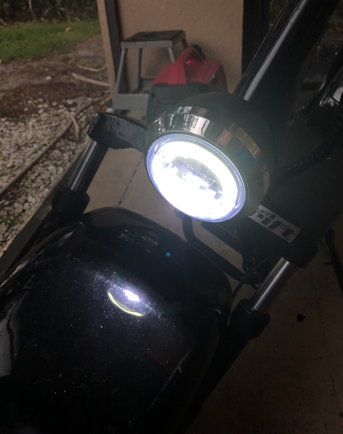

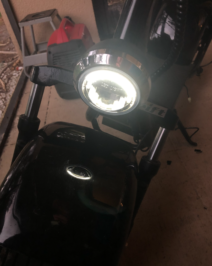

Front running light also turns up with the switch now
Front light is also working now:

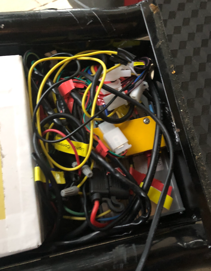

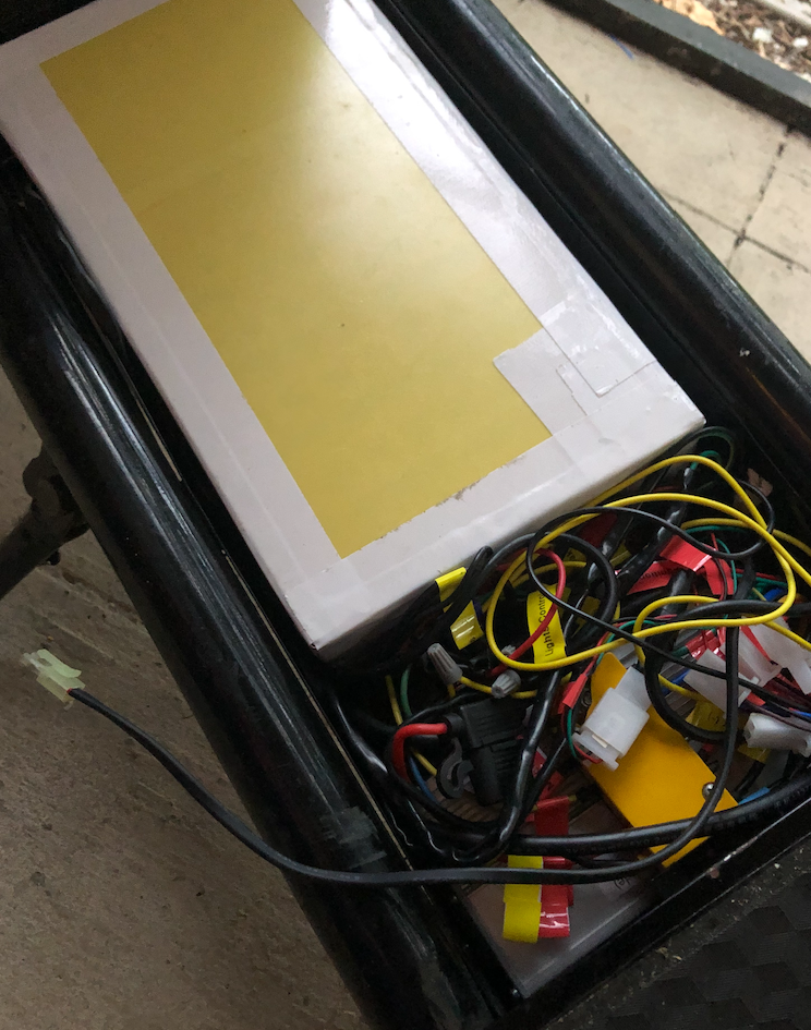

Battery does not have wrapping, you can see my duct tape on edges. The wiring for the controller is awful, I know.
I could not do better with what I had available,, a multimeter, a wire striper, spare stranded wire, electric tape and some household twisted-on wire connectors.

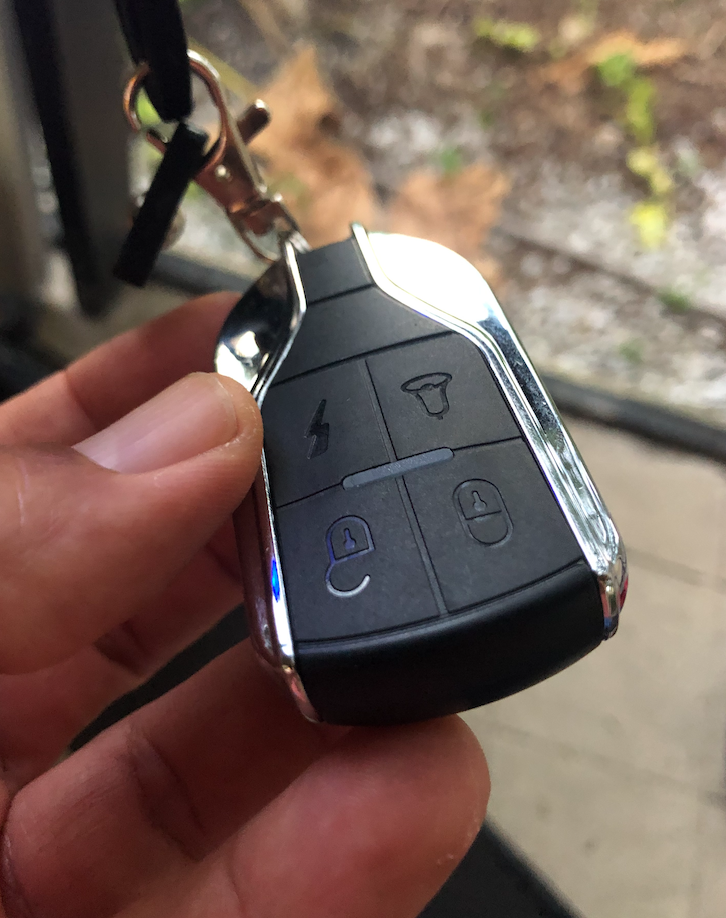

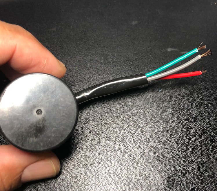

This is a fob that came with it,, and I figure out (almost) the alarm part.

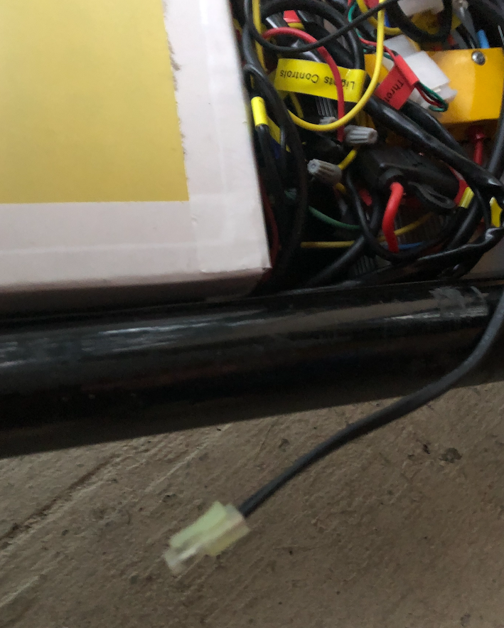

This is the thing that I think is a flasher, although I have no idea the pinout and how to wire it.

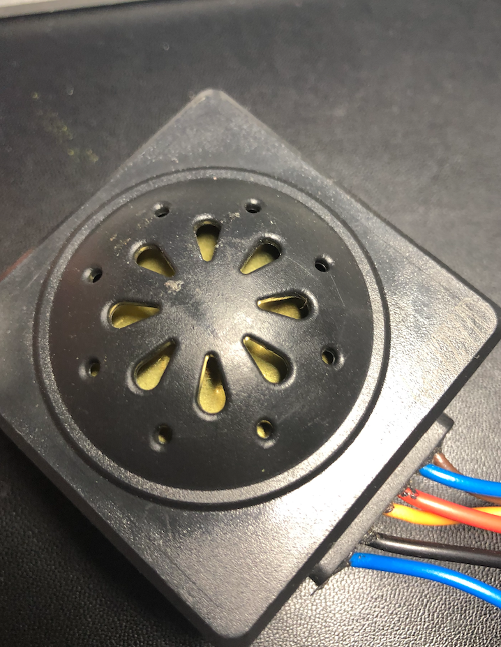

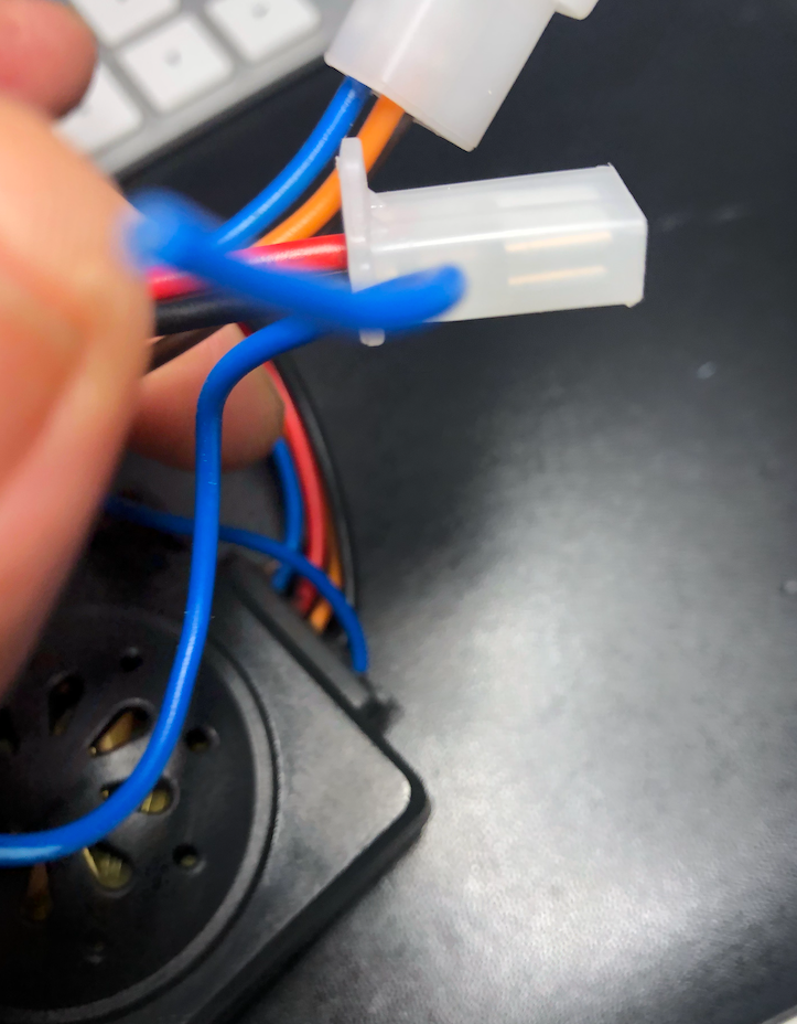

This box below is some sort of alarm and siren,, the plugs match on the controller, and it works,, but I dont know what is the loose blue wire for, so I didnt want to leave it connected.

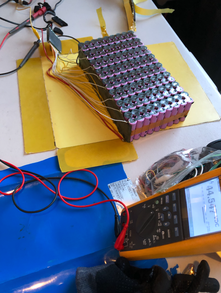

Like I said,, I had to open the battery and found a balancer wire disconnected, so I fixed that and the battery got pass 44 and went all the way to 67.2V
it was strange that the label outside said 18650 16S10P... but if you count, there are 16 in series and 9 in parallel, not 10.
