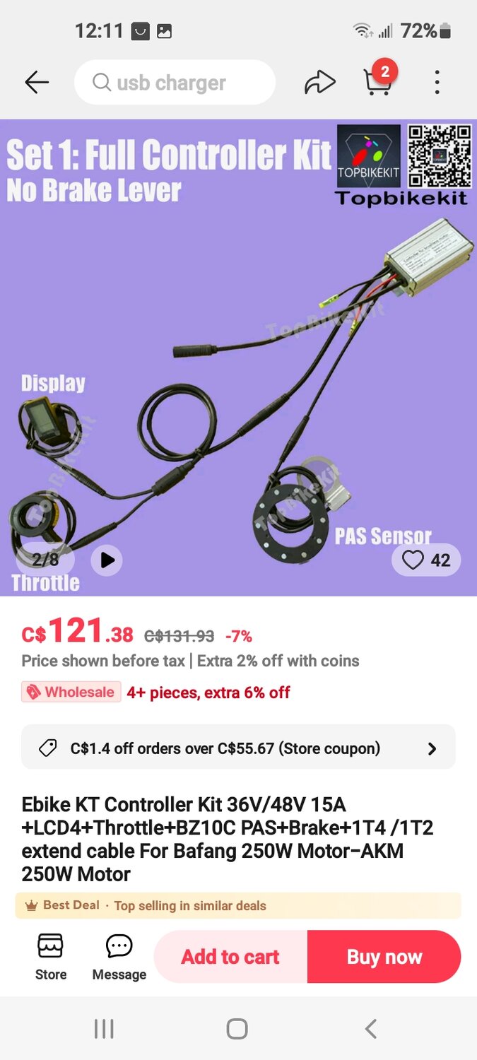

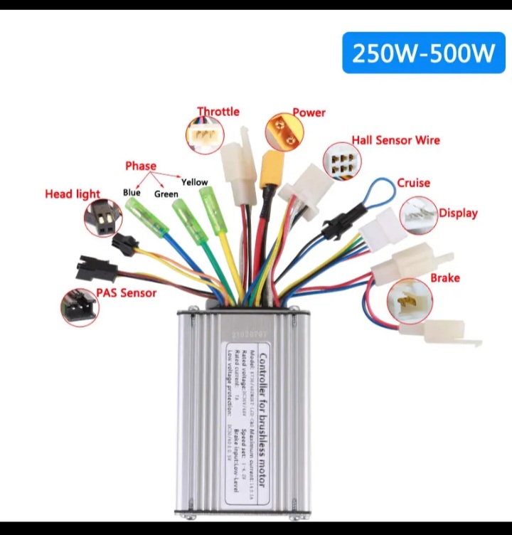

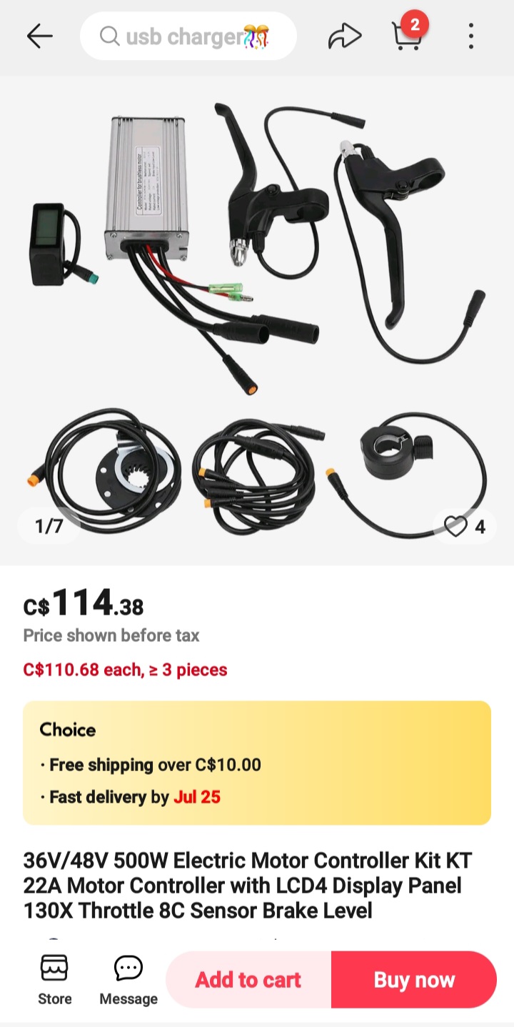

Here's a complete KT controller kit that comes with everything you need,..
It's about $50 USD
That would be really easy to install.
You might have a connector problem with the brake switches, but you can just cut the connector off and wire it in.
You don't have to worry about polarity on the brake cut-off switch wires. Just connect the two wires together.
Another possible issue is the PAS sensor fitment, but some sandpaper and a file usually fix that, or you can reuse your original PAS sensor.
