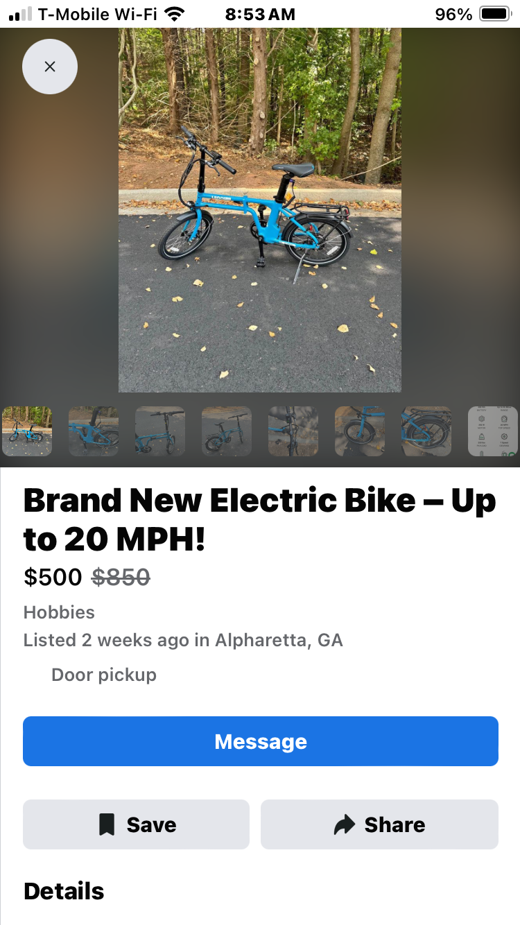

thank you so much for your recommendations however I’m afraid I can’t go beyond my budget of $700 right now because of some unforeseen expenses that have come up.
as for the battery being removable yes I do need it to be removable because hopefully I can plug it in at work but it depends on what my boss says. also at work it’s going to be parked outside unfortunately in the hot Arizona sun which means I’m going to have to get a tarp so that the tires and other components aren’t ruined by the heat. which is also why I would want to remove the battery while I’m at work for that reason as well. and they also have a thing about not letting you put your bike inside even if it’s foldable. I wanted the foldable one because I live in an apartment and I have no wish to keep it outside even locked up so I needed to be able to fit it in my place. as far as security goes at work it should be fine it’s more just about the weather taking its toll overtime five days a week six hours a day.
as for the weight being in a low position did you mean as in the frame where the battery sits is lower than the handle bars cause i think it is; my nervous Nellie self is just concerned about being able to control 57 pounds of bicycle after being used to a regular maybe 30 pounds of bicycle.
and unfortunately as for bike shops, my town only has two and only one of them has a 20 inch foldable bike and they only have the one model which I believe is Troxxus? for $1700 with tax. it has the same battery size and the 3 inch fat tires like the one I saw on amazon for cheaper. all the other bikes in the shop and the other shop are not foldable, 26 inch and mostly with fat tires as well and they are all about the same price or even more than that. as for a Walmart or even target as well they carry no electric bikes in stock everything would have to be ordered online. out of desperation I tried them and even Best Buy and our Best Buy also does not have anything in stock and even if they did the bikes are $1000 and over.
