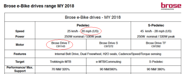

Well damn. I made it all the way home (3 hours away) and take it for a ride. The motor cuts off at 20mph. Not an ounce of assistance the moment the speed hits 20mph. Ive spent the last hour looking up why and I can't find anything because 99% of 20mph topics on the vado are Europeans or Canadians talking about the speed limit.
Im a little worried now because I looked up the serial number C91143 and everything im seeing about it shows that its a 20mph limited motor. Did I get the Canadian version?

As I wrote under a separate post, your Specialized LBS will set your Vado to U.S. Class 3.

I found a reference to the same thing:
I read back some posts and see your 12 mile ride was actually on the 3.0. So that makes sense why you didn't go over 20 mph on the 4.0 since that was in the parking lot. I would definitely follow up with the LBS to see what they can do for you.

It doesn't mean a thing. All U.S. Class 3 Vado 4.0 are equipped with Specialized 1.2 motor (Brose T) and sport the 28 mph speed limit.
One last update, I was able to call Specialized customer support, they confirmed with my serial number that its a class 3 and then checked the installed software. They said that it just had the wrong software update on it. I ran it over to my local bike shop and they fixed me right up in about 5 minutes. I wish I could have just bought it from them, but they literally don't have a single bike left in stock (ebike or otherwise).
