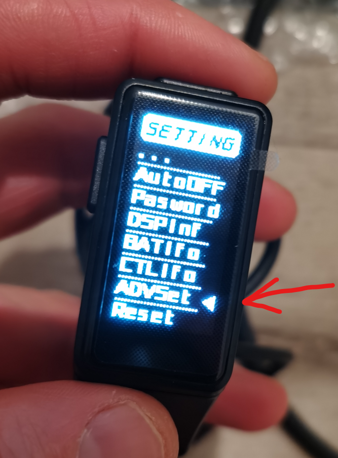

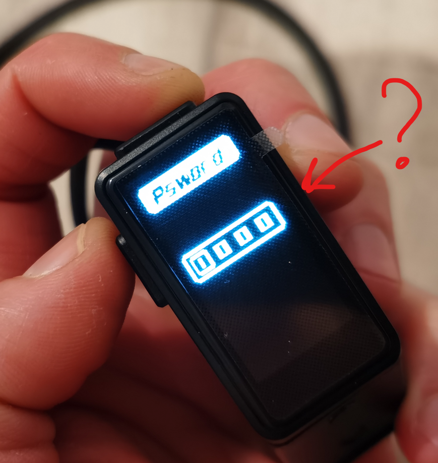

How did you figure out the Advanced Settings password is 1919 ? I have an Innotrace X2 display and I want to open the Advanced Settings but it is locked by password and I do not know the password, Innotrace does not respond unfortunately.
I tried the code 1919 with my Innotrace X2 display and it does not give me access to advanced settings. Any ideas how to figure this out?
I found the code, it is 1657
