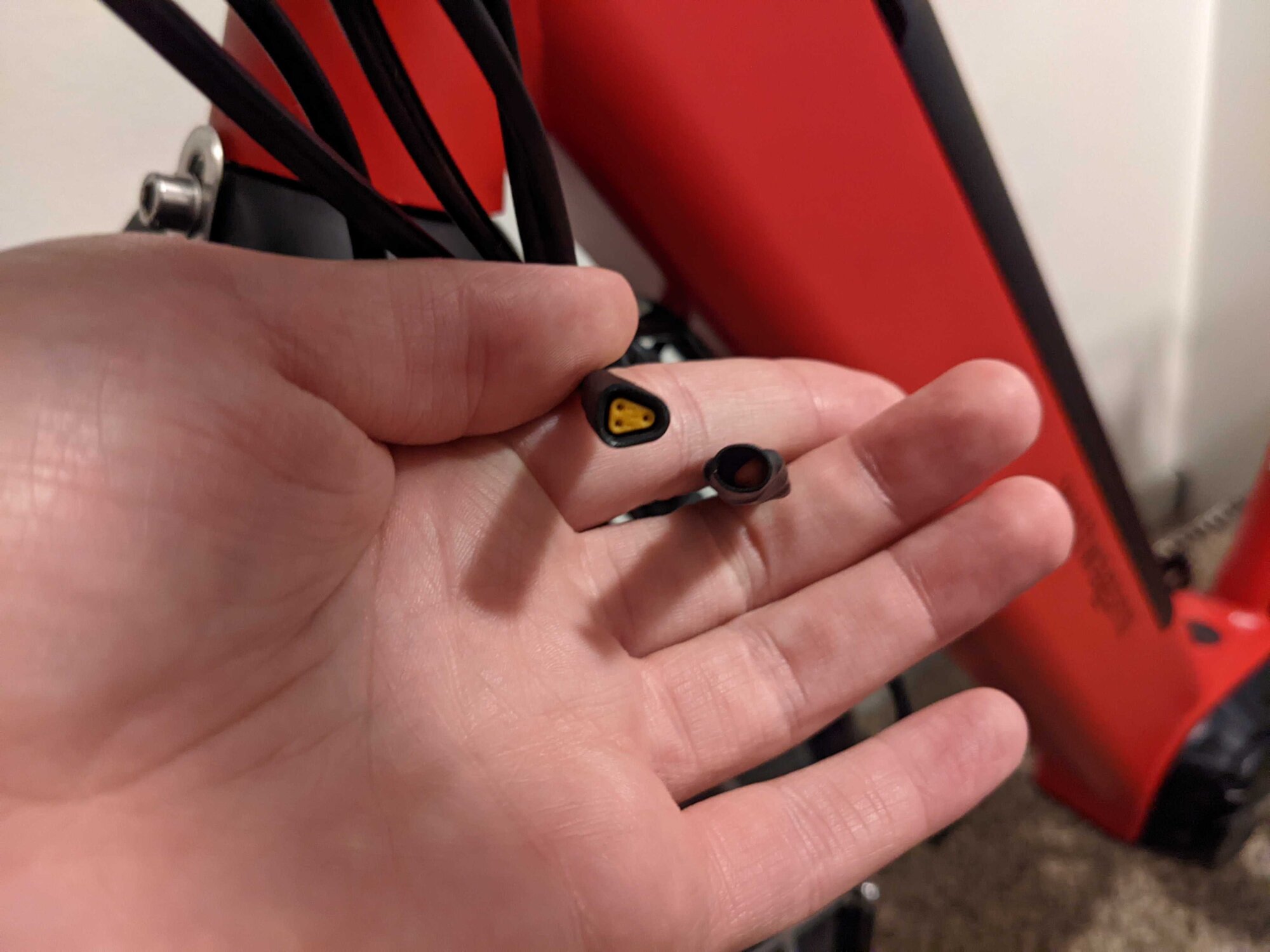

  • One unused 3-pin HIGO connector (orangish yellow) and what appears to be light wires from the Bafang harness (no cap on the unused HIGO, still searching what it's for)

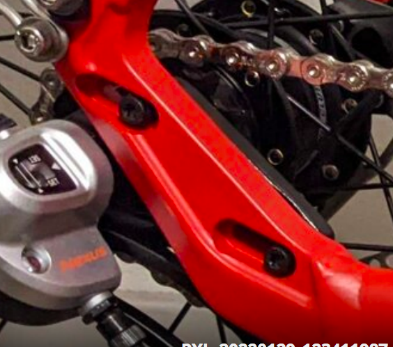

It is pretty easy to see why they weren't able to use a belt drive....there is no split in the drive side frame to allow for one. That seems really strange it was even offered.
I wasn't aware of any 3spd IGH that isn't 36h but I haven't really followed their development that closely.
You are way more patient and understanding than I for sure, I got anxious when the bike I got recently was at first posted for delivery by FedEx and they changed it to one day later and still received it one week after payment! I hope that you at least get the use and riding experience you were hoping for?
@JRA - for BELT, the Atom has a break point on the Drive Side chain stay. You can see the two screws in the above photo….

Those two bolts are to adjust the chain tension via placing the hub forward or back. There is no visible break in the actual dropout visible to my eye that would allow for putting an endless belt on the bike.
The black plate visible behind the dropout is part of the "cage" that also is working to take up the chain slack.
