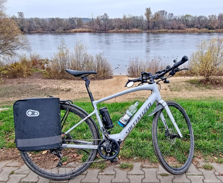

How do you carry four range extenders on the bike? Plus water?
I use a Specialized Tailwind pannier. Its inner pocket snugly fits three REs (I wrap the middle one in bubble foil so the RE's do not shake there). I can put tools, inner tube, some water bottle inside the main part of the pannier. However, to distribute the weight better, I rather carry extra water bottles and a snack in a small backpack. Of course, the fourth RE is on the bike.

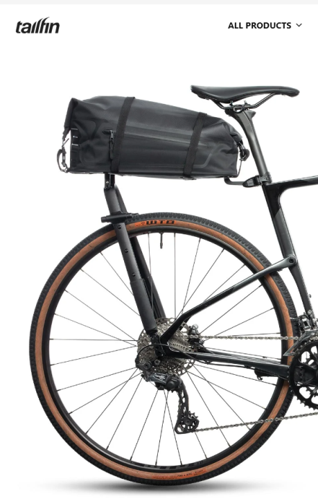

My setup might not necessarily serve other riders, especially Creo owners. I was suggested the AeroPack rear rack from Tailfin.cc could be a more appropriate solution for a gravel bike. It doesn't, however, fit Vado SL EQ (that already has an integrated rack and tail-light).
