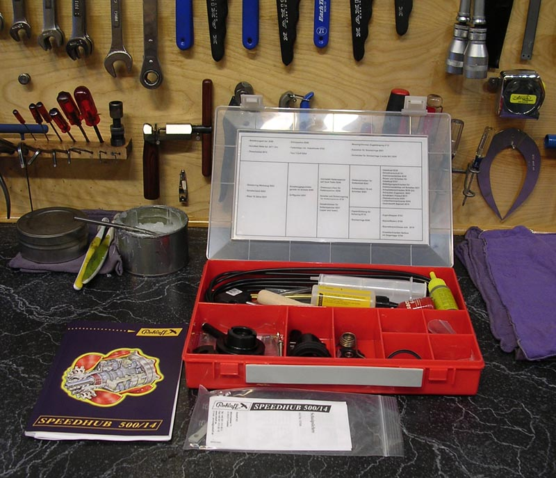

I am not sure where you found this information. I invested quite a bit of money into buying Rohloff hubs after testing it for a few thousand miles, talking to the folks in Germany and assessing the feasibility of service options.
There are quite a few mechanics around the country that can service the Rohloff hub. In the US alone, I have located at least 20 competent bike shops that can handle this efficiently. Let me give you an example:
Just in one case, one of the forum members was not advised well and he had to send his hub to a repair facility in California for a simple fix and they took a lot of time in fixing the oil leak but in an ideal case, his shop could have worked with nearby shop called Aaron's bike shop in Seattle who are experts in Internal gear hub repair and servicing.
They not only service Rohloff but a wide variety of IGHs.
See the link below: http://www.rideyourbike.com/rohloff.shtml
A little bit of guidance in the right direction goes a long way in resolving seemingly 'complex' problems.
I know 2 shops in Chicago, 3-4 in California and so on...

My lbs is literally nine miles from my front door. They had no problem replacing the hub oil and I have them do it once a year whether the hub needs it or not. Hub oil replacement is not a difficult evolution at all and most bike shops will have no problem doing it -- it does not require a certified technician.
I give them (my lbs) about ten days warning to order the kit and they email me when it arrives, and I drop the bike off and am typically riding the next day.
[Going from 10,000km to 10,000mi this year and the bike is still going strong]
I personally know people who have Rohloff hubs with 100k miles on them, all they've ever done to the hub is change the oil and rebuild wheels around it when the wheels wore out.

I had a local bike shop who had an experienced Rohloff guy in the shop who did the first routine oil change. Several months later I was swapping tires and pulled the rear skewer to remove the rear wheel. The skewer was dripping oil and upon inspection the E14 mech was covered with oil as well. There is an interior seal that failed and the breather is apparantly inside the core of the hub where the skewer passes through.
Most importantly the center half of my rear brake rotor was starting to get oil on it. Fortunately the oil had not spun outward yet to get on the actual braking surface of the rotor. It was about an inch away from causing the rear brakes to fail. This was far beyond the normal "misting'' oil due to normal respiration of the hub seal to equalize for atmospheric pressure.
The bike was still on warranty, so the Riese & Muller dealer was bound to have the wheel shipped to what was, at that time, Rohloff's sole authorized warranty service center in Richmond California.
I have had Aaron's work on my other Rohloff equipped bike for service. However, in this case, If I had taken the bike to Aaron's I would have voided my warranty. I am sure he would have been able to fix the bike for me but the loss of warranty on a bike that was less than one year old was not a good option.
I was not ill advised by anyone. This was an unusual failure in a Rohloff hub. The repair was done by the book due to warranty procedure and resulted in a ridiculous wait due to an unresponsive and sluggish service center. Also this hub went into the shop a full six weeks before covid started slowing supply chains.
