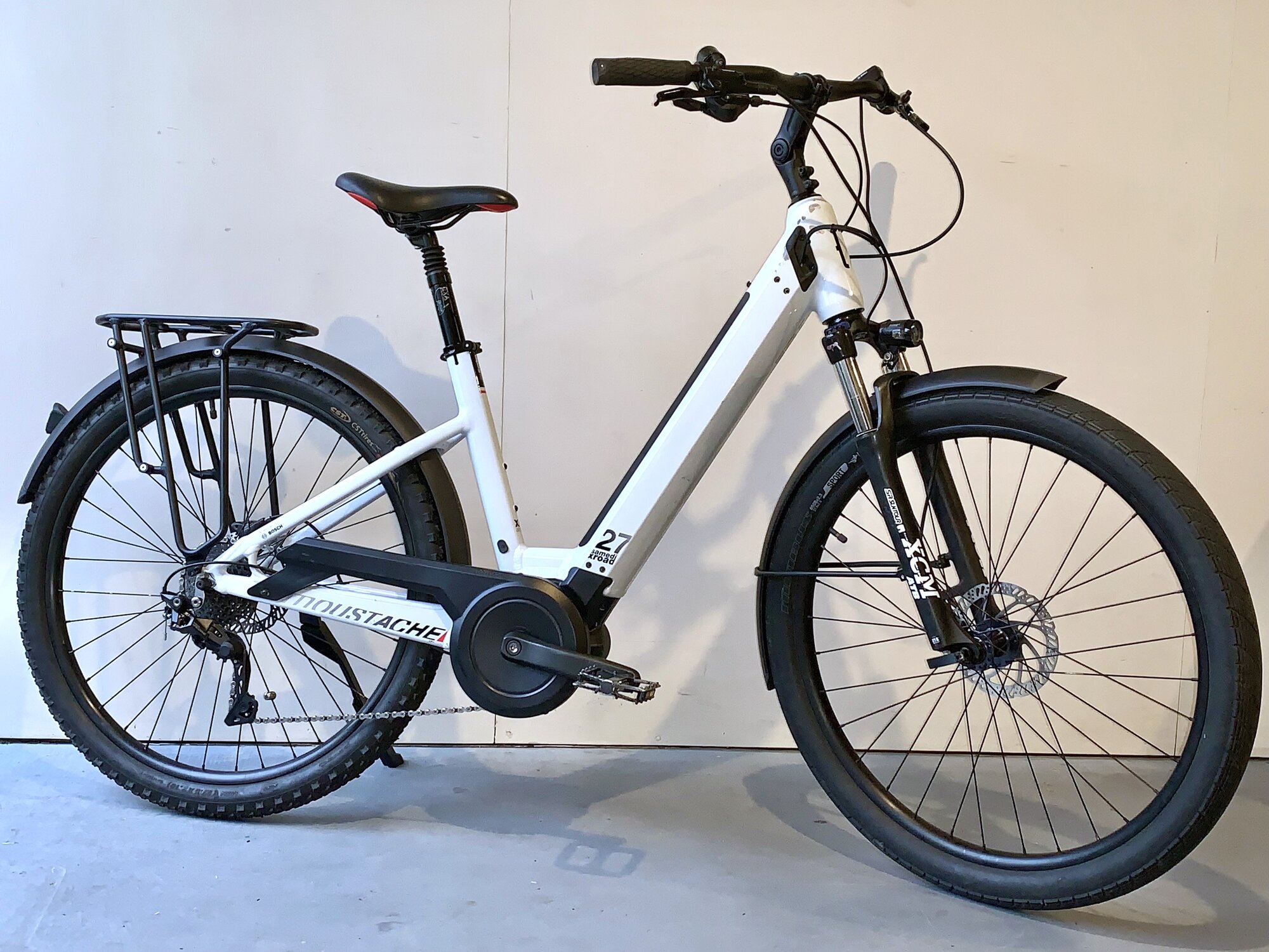

Moustache Xroad 2 2020 low step 625Wh
Bought a Bob Yak 28 plus trailer to tow behind Xroad. Not straight forward fit but it works. Mounting bolt for bottom right of rack sticks out by 2-3mms to much to for trailer hitch. Swapped for smaller head bolt (M5 Panhead) and thinner washer. The rack also interfers when attaching trailer, have wife tilt bike over at 45degree on kickstand while I attach unladen trailer. On plus side nobody is going to steal it in hurry. Can't use my 22L Vaude panniers as they rub against yoke, the 15l panniers work fine and all I should need for tour. Only use them for items I need during day eg lunch, jackets etc. The 95L trailer bag is massive, for my initial test run around block loaded with 2 man tent, 2x thermarest + sleepbags, pile clothes, charger and couple spare batteries. This would be typical camping touring load for two.
