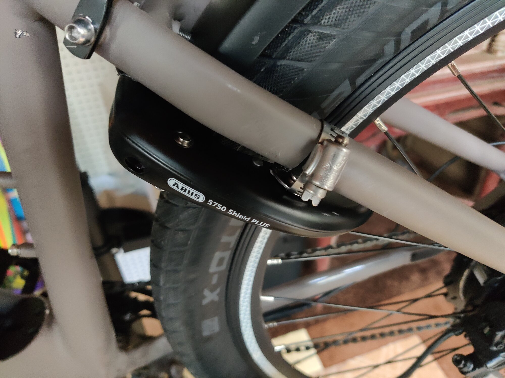

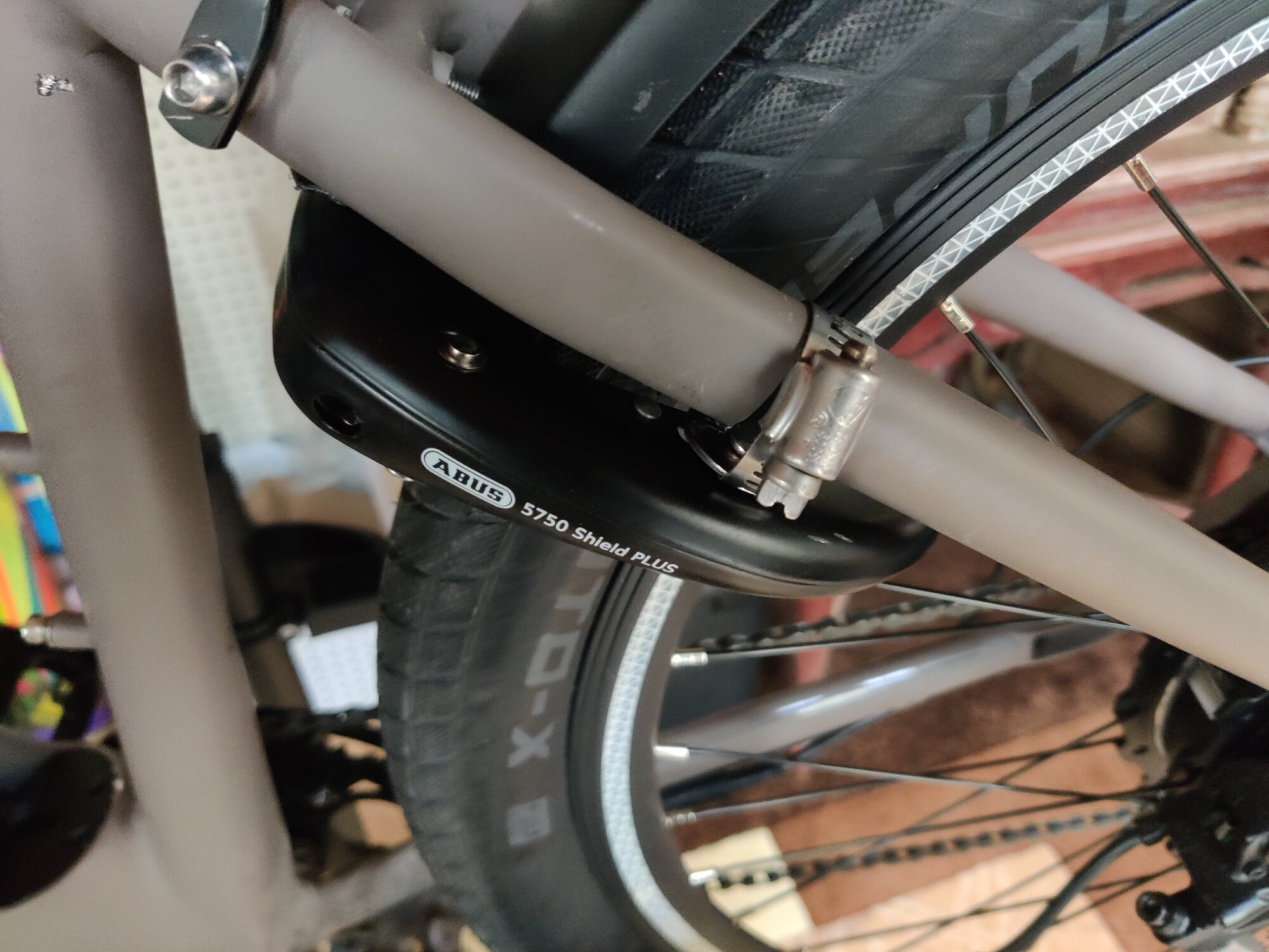

I mounted an Abus lock to my Ride1Up Limt'd. I tried to use the adaptor straps but they just didn't work. So I used hose clamps. Worked out great. I wrapped three layers of electrical tape around the frame to keep from scratching the paint. Once I had the lock mounted, I used Plasti Dip (rubberized coating bought at Lowes) to cover the clamps
. Unless you look closely, you can't tell the hose clamps are there.

I mounted an Abus lock to my Ride1Up Limt'd. I tried to use the adaptor straps but they just didn't work. So I used hose clamps. Worked out great. I wrapped three layers of electrical tape around the frame to keep from scratching the paint. Once I had the lock mounted, I used Plasti Dip (rubberized coating bought at Lowes) to cover the clampsView attachment 109614. Unless you look closely, you can't tell the hose clamps are there.

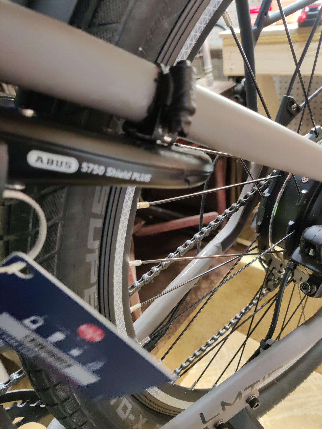

I tried to take picture to show how I did it but it was hard to see. Basically what I did was to drill a hole through the hose clamp where the nut to tighten it would be available on the side. I got a fender washer (a bigger than normal washer) and bent it around a piece of pipe so that it's radius was the same as the frame. Then I ran a bolt through the washer, through the clamp, and then through the lock. Used a locking nut to tighten it all up. It's solid, doesn't move around at all.

Just to confirm, is that the 5750L and do you have 2.4" wide tyres?

I used a 5750 Shield Plus. I can't find the invoice so I don't know the exact model number. My tires were 2.4" wide and I have plenty of clearance.
