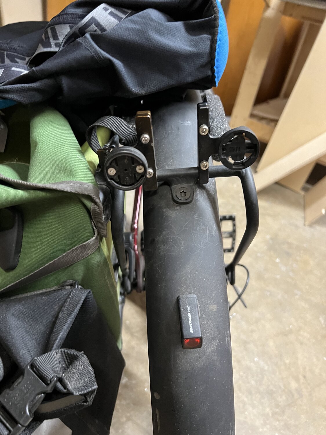

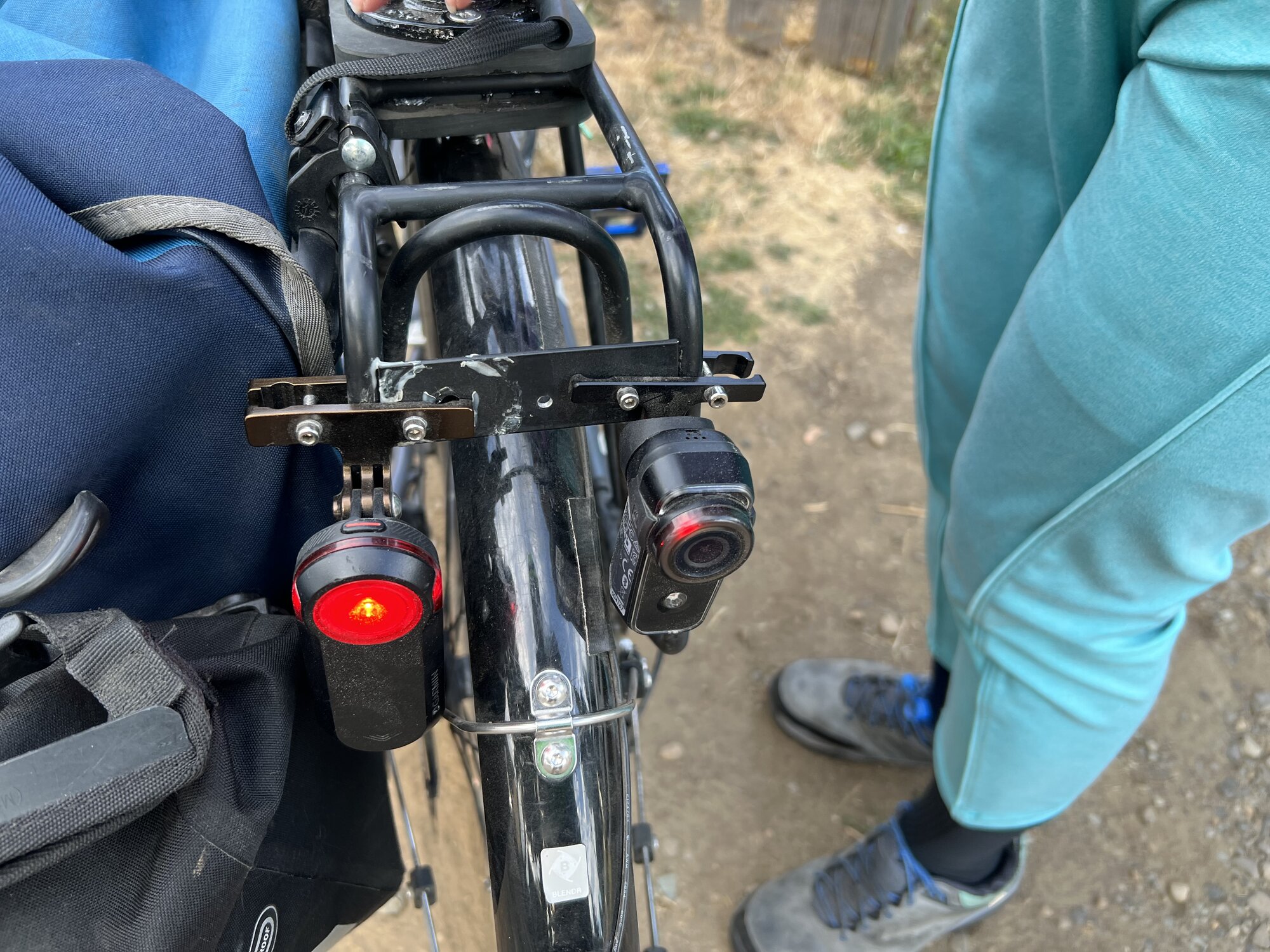

I hung mine from the back of the child rack at the top. I bolted an aluminum angle to the rack with the included 5 mm screw holes. On the horizontal surface of the angle I drilled a 5/8" hole. I stuck a 4" long plastic pipe through the angle vertically. I put a #6-32 1" machine screw through the top of the pipe to keep it from sliding down. I clipped the garmin varia mount to the pipe below the angle normally, as it would clip to a bicycle seat stem. Took a little shorter o-ring to fit the garmin mount as the 5/8" diameter pipe is a little smaller than the seat stem.

Ok just checked the pics you can mount it on the vertical part of the rack I did that on our tandem. This is my regular bike but this mount works on the vertical too.
Creative! I've got a battery that sits on the rack, but I'll try something like that. Thanks
