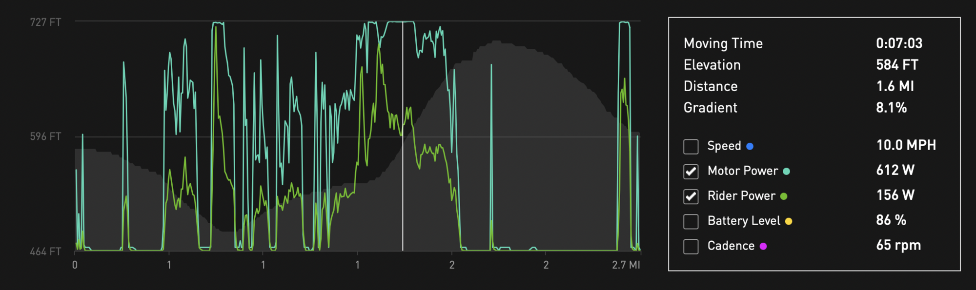

I am the new owner of a Vado 4.0, and looking back at the data on my first few rides, I am trying to reconcile the observed data with what I expected from marketing material, reviews and such.
For example, I keep reading that the motor on Vado 4.0 peaks at 470-520W depending on the sources, while in my rides, I see the peak of motor power at 610W, are those different metrics?
Specialized website also claims the motor puts out 3x rider power, while looking back at my ride, motor power is more like 4-5x rider power.
Is Specialized underpromising or I am not looking at the correct metrics?

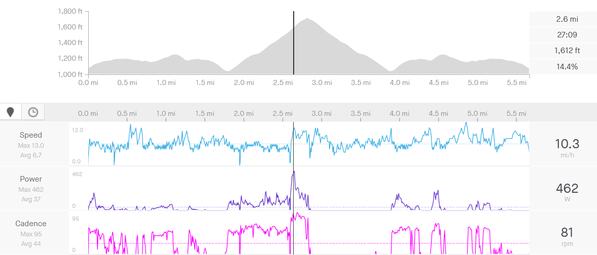

If you're seeing 610W, I suspect that may be the total combined power. For example a few days ago I managed to get my 2022 Vado 4.0 to put out 462W, which means I would've been putting 154W into the pedals, for a total of 616W. My wife and I had stopped part way up, and I pushed the bike hard as it'd go resuming the climb. (disregard)

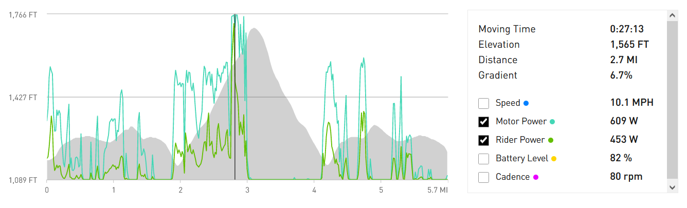

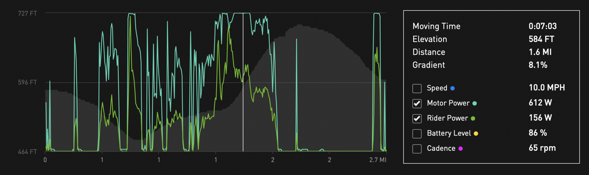

Interesting. Hadn't looked at that on Specialized's site before. Here's approximately the same moment (4 seconds different) from Specialized as I showed from Strava above.
I guess Strava is reporting ride input power, not motor. Perhaps the max assist specification is a 3 or 5 second average and the figures on the site are an instantaneous number.

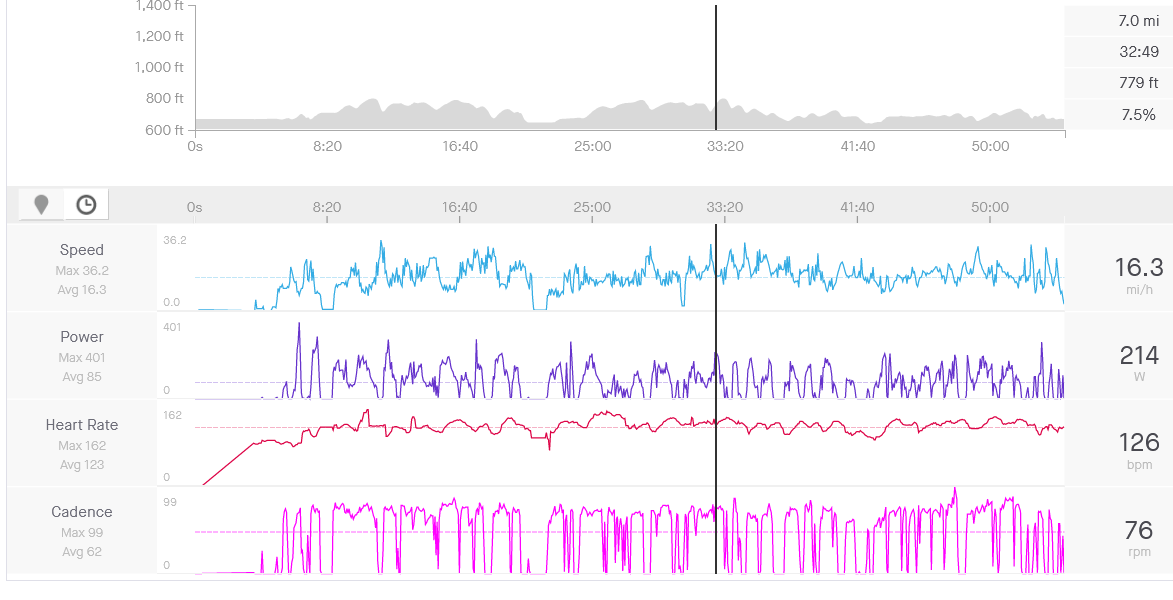

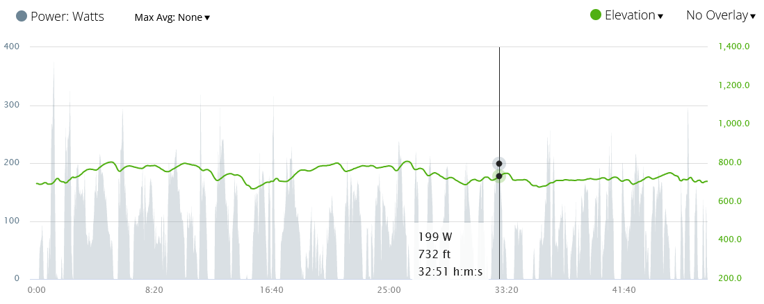

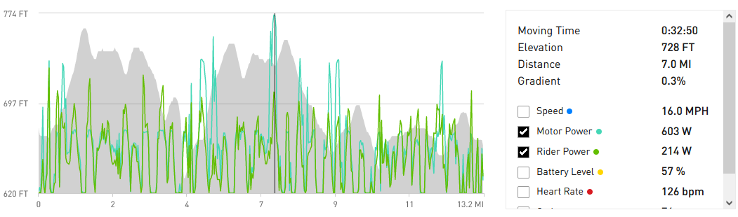

Just to make it a bit more interesting, here's data from a ride where I had my Garmin Edge 830 along. Specialized's site, then Strava, then Garmin Connect. So yes, I was mistaken in my first post - just rider power is getting sent out to Strava and displayed at Garmin Connect.
I suspect what may be getting reported is the battery output delivered to the motor and not the motor output power to the crank, which reportedly is ~80% of the former. I'd suggest you set up a screen on your TCD_w to display both Motor power electric (mot pow el) as well as Motor power mechanical (mot pow mech) fields and see what's displayed as you test it out. See https://support.specialized.com/tur...-interface/mastermind-tcu-tcd-display-options
