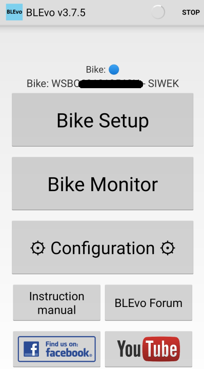

Two main groups of functionality are Tuning & Diagnosis (Bike Setup) and live monitoring of a Turbo e-bike performance, ride recording, maps, and post-ride analysis with connectivity to Strava (Bike Monitor).

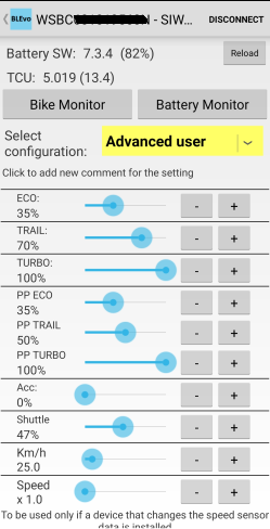

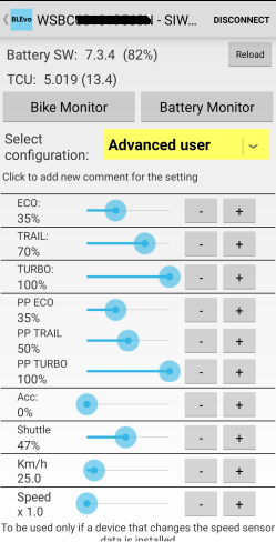

Similarly to Mission Control, BLEvo allows motor tuning but it lets you maintain multiple selectable tuning profiles (Configurations). So you can make a Configuration good for long-range trips (a little of assistance) and another one good for fast commutes (a lot of assistance). There are many predefined Configurations in the app. (Some features here are only applicable to the Levo: Acc & Shuttle, and some help individuals who derestricted their motors with mechanical derestrictor like Planet3). Note: The last two fields take no effect on Specialized S-Pedelecs (the 45 km/h e-bikes).

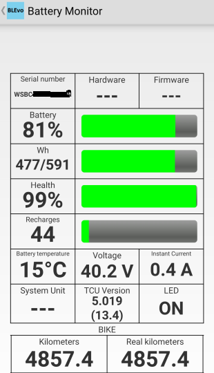

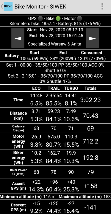

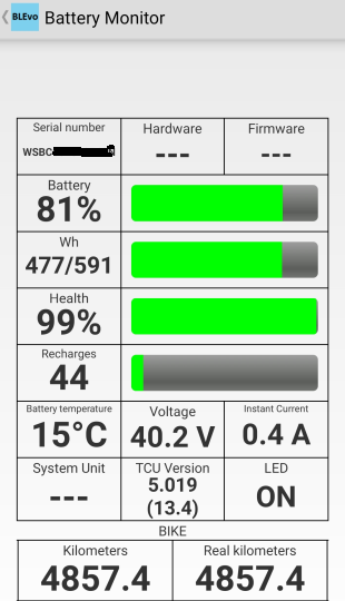

Battery Monitor, or, "What Specialized don't want to tell you about your battery". The process of querying the battery can take several minutes but eventually all fields will be displayed. Valuable information is the actual number of the recharge cycles made on the battery. Also, true battery capacity is given. Here, it is 591 Wh (it should be 604 Wh nominal).
Configuration: You can do things you've never dreamt of before here... You can even define Range Extender or a spare battery...

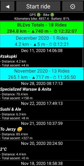

Bike Monitor: Central repository of your ride metrics and map data.

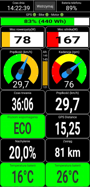

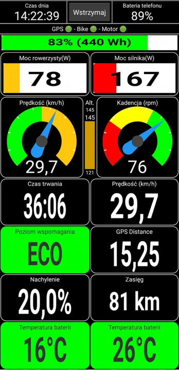

Your live bike dashboard on the ride. LEvo works in your language. You can configure the contents as you wish. Here:
  • Time of day
  • Phone battery %
  • Connectivity status (GPS, Bike, Motor)
  • Bike battery %
  • Rider's actual power
  • Motor power (actually: power drawn from the battery)
  • Bike speed (from controller data)
  • Altitude
  • Cadence
  • Ride time (with auto-pause or manual pause)
  • Actual bike speed (from GPS)
  • Assistance level
  • Distance ridden (from GPS)
  • Inclination (it is a weak feature that sometimes gives wrong readout; I think it works better on hills than on plains)
  • Estimated range
  • Battery temperature
  • Motor temperature

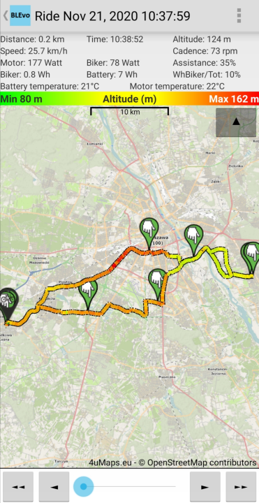

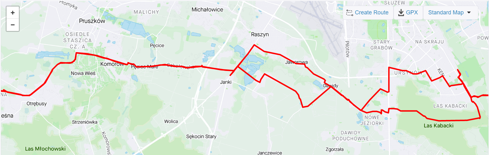

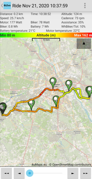

Then, there are Maps. I haven't explored that part very much but I can tell you BLEvo even knows at what moment on your ride you farted :D (as to say).
Post-ride reports extend for many pages, including charts and maps.

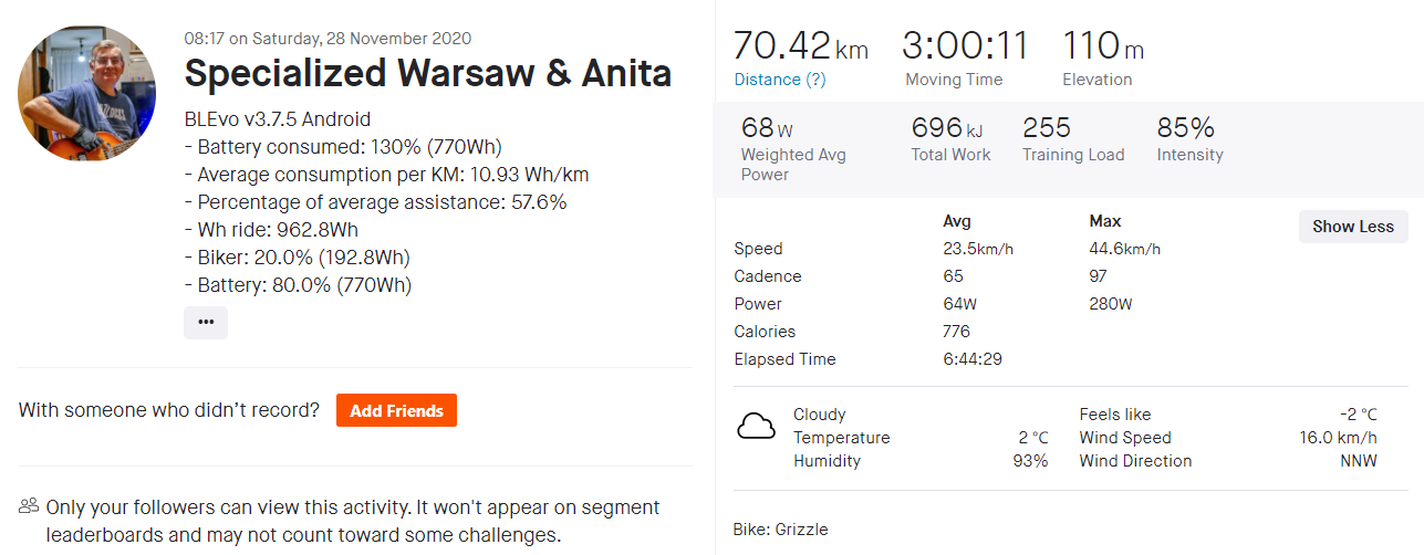

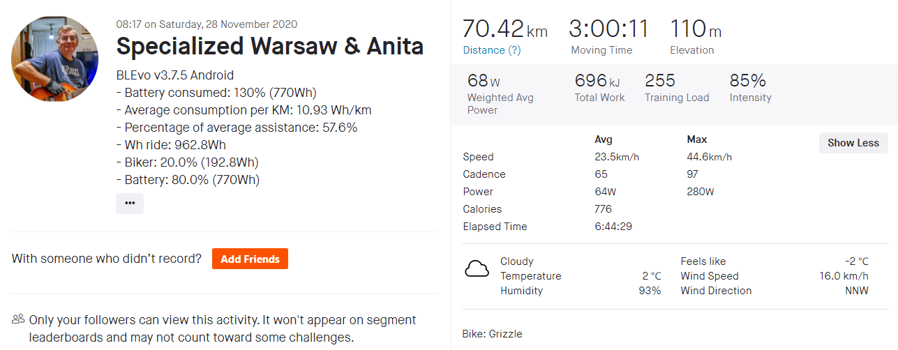

BLEvo export to Strava.

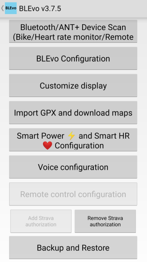

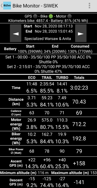

GPS Navigation, Heart Rate Monitoring with BLEvo.
