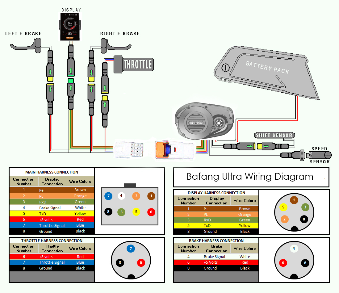

Just a clarification
I am chasing a wiring diagram for installing a G510/M620 onto a Bafang specific bike frame.
Can anyone send me the details ?

Mark,
I found a lot of information just googling "bafang ultra wiring diagram" or "bafang BBSHD wiring diagram". Several of those should have all the detail you might need.
In addition to that info, I would note that there are 2 different main harnesses. There's a 5 into 1 main cable that includes a place to plug in a headlight (as well as the brakes/display/throttle), and a 4 into 1 that does not. I KNOW the Ultra is able to control power to it's headlight using the "up" button. What I DON'T know, is if the older BBSxx motors are able to do this. The Ultra is able to use either harness. You don't see this mentioned anywhere I've seen. -Al

Thanks very much for the details.
One other thing to mention is the available wattage for the front/rear lights coming directly from the motor wiring is extremely low. It won’t power most commonly available lights that have any amount of lumens. I’ve heard you can run into issues if you exceed the available wattage and could damage the motor.
I’m building up a Bafang Ultra at the moment and am going to wire the lights directly to the battery and use one of these lights that can run directly off of battery voltage.
