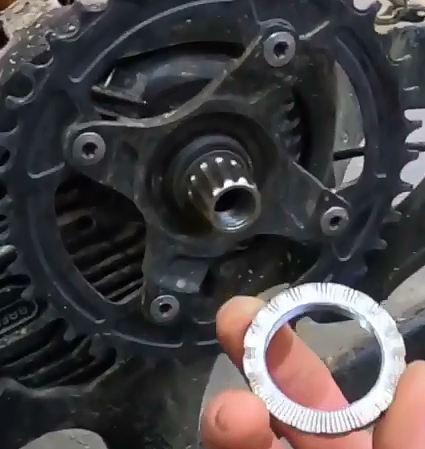

New problem I caught just yesterday. Slight creek while pedaling. After several months the Chainring nut loosened up. Good thing I had the Bikehand tool YC-29BB-2AN to retighten the lock ring in my toolbox. Not that I cannot handle the bike maintenance I can. I am just passing along my experience and areas to watch on the X2.

Good info - thanks. The bikes we are discussing are X1/X2/Z1 from Luna, which are all e-bikes with Bafang mid-drive motors. I don't think these are standard crank attachments.
Ah. My bad. From what I understand the Ultra on the Z1 and others is standard ISIS spline (Lekkie's buzz bars for the Ultra are ISIS crankarms), but the M600's use a proprietary almost-ISIS config. Same procedures apply though, although if your arms use little opposing M6 bolts you need to dial down the torque to whatever the max is for an M6 is taking into account it is threaded into a softer alloy (Lasco quality level) arm. 8Nm? thats probably too much.
The M600 lock ring has teeth on the side facing the aluminum chainring. Tighten down the ring to 35nm or 25 ft lb.
