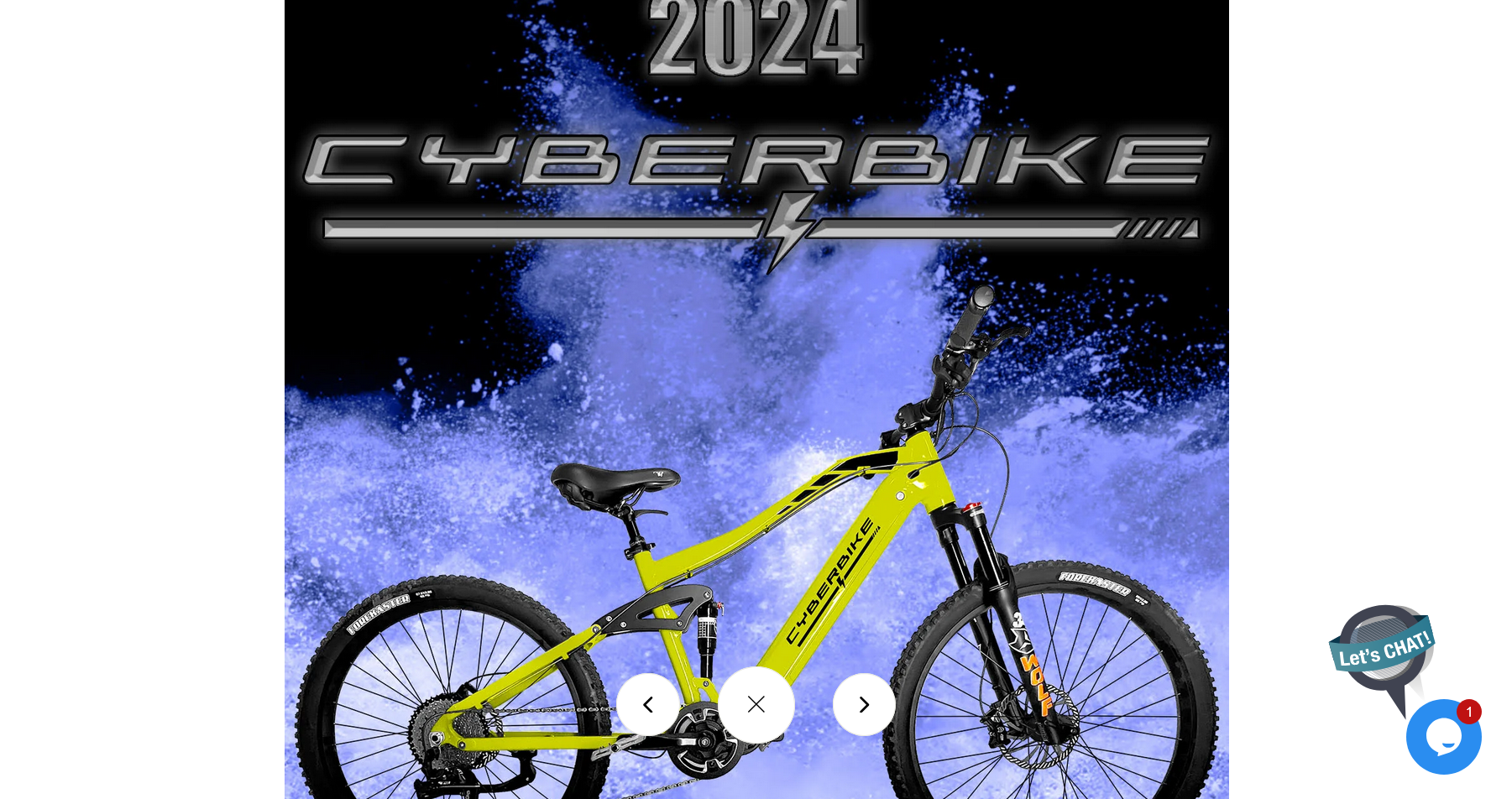

We had one DTC in this last week that seemed straight forward. Replace dropper cable, and adjust rear brake. We couldn't move the crimped dropper housing. It was crimped by other wires/cables and by the motor. It was a faulty design made by a marketing team with CAD and not by people who maintain and repair things. It was disposable. When we dropped the motor to get to the housing it came apart. The pawls of the clutch fell out, had been previously damaged and would not go back in. This POS cost us at our expense ten hours of labor. At least we did not allow the battery into the shop. It had all counterfeit parts, for example the fork was not a Fox, it was a Wolf.
That bike died today with frozen pedals. The throttle works. We may have to try to buy this unbranded motor and have contacted the company. We also do not know if it was working when it came in because we turned our noses at the battery and did not pre-test it.

Bummer. I take it then that someone pulled out the mid-motor to fix a dropper seat and now the motor no longer has working pedals. In a situation like this, is it the shop's fault?
@harryS, My service manager is a man of pride and does not like to admit defeat. That bike came back in today for us to make whole. It would be less expensive to buy a new disposable Cyberbike then to spend another minute on its repair. It is intended to market and sell, not to maintain.
