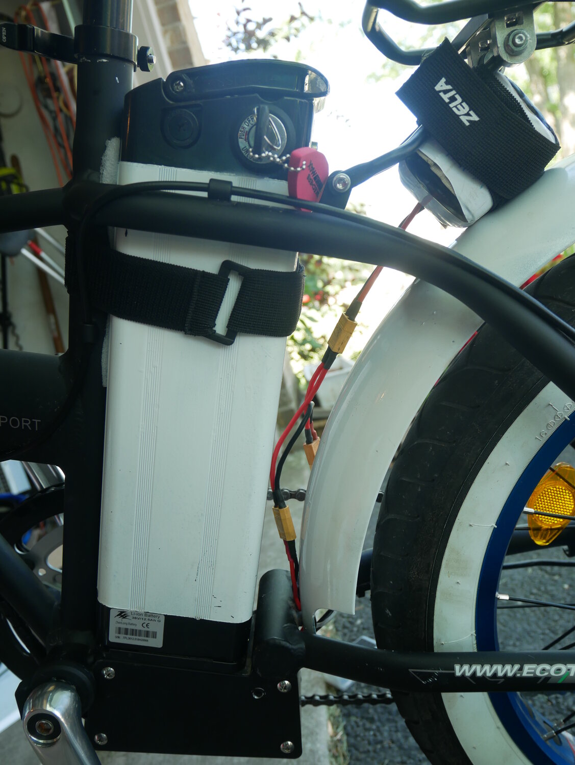

What kind of batteries do you have?
Is it no-brand Chinese cells? or is it a brand name is like Panasonic, Samsung, etc?

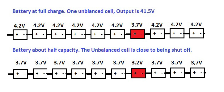

In a perfect world, the battery should read 42.0 volts at full charge. Your 40.0 could just be an inaccurate voltmeter, but if it's real, that's suggesting an unbalanced battery. Next time it runs out after five miles, tell us what the voltage reads. Betcha it's 38-39 volts, plenty of battery voltage to run your bike, but not if it's unbalanced.

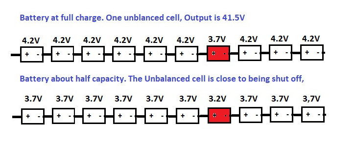

This graphic shows an unbalanced battery. At full charge, it will read 41.5V, which is good, but the red cell group is down .5 volts. When the pack is half discharged, at 36.5V, the red cells are really close to shut down. So you only get half the capacity. Then when you recharge it, it stops charging when the other cells get to 4.2 again so you can't get those red cells charged. I suspect that's what you have, only worse.
If you have an unbalanced pack, there's only one thing you can do. Hope that Ecotric put in a battery that can self balance. Leave it on the charger for a few days. See if the 40V comes up.
I have never figured out if my Ecotric battery will self balance, but I talked to another owner in an Ecotric facebook group with a problem similar to yours. He told me that leaving it on the charger for a long time solved his problem, so at least his battery could self balance.
One caution. I dislike leaving any battery on a charger for a long time, so you might want to do this balance charge somewhere safe, as far as fire safety,

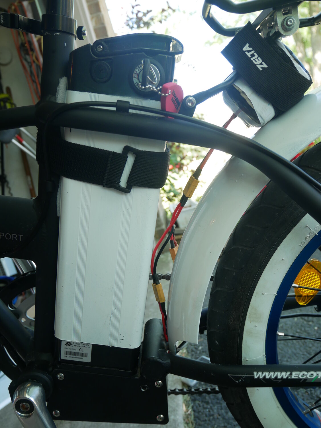

I understand your position. My main concern on batteries is one catching on fire. Based on what I've seen in my batteries in 7 years, they have gone from using glue/tape to nylon forms, better insulators, and machine spot welding, quite an improvement in construction. The cells in my Silverfish were located in a plastic form, which is encased in a stiff fiberboard and shrinkwrapped. Then as you know, the whole center case of a SIlverfish is extruded aluminum, so those cells are well protected.
What was lacking in my battery was a balance BMS. Once a cell gets low, it can't be fully charged, and further usage causes it to drift lower and lower. I swapped the circuit board in the above photo for a balance BMS, and it was able to bring the unbalanced cell close to full charge. The pack was good for about 80% of original capacity, not bad for a 2 year old battery.
I had a safety concern though. The weak cells had discharged down to 2V, below the safe operating range for lithium. That now poses a risk of a fire, so I'm no longer using it unless I can replace the cells.
